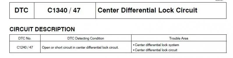

"I have a code 47, "Open Circuit in Central Differencial Lock", but a search finds nothing on further diagnosis or how to repair. Both VSC lights are on.
Anyone had experience of this?
I do, I did. My bulbs all OK. Was a faulty back-up sensor.For the archives....
I had a code 47 and it went away when I changed the dash bulb for the center differential lock indicator. Mine was bad.
Start with the easy stuff!
