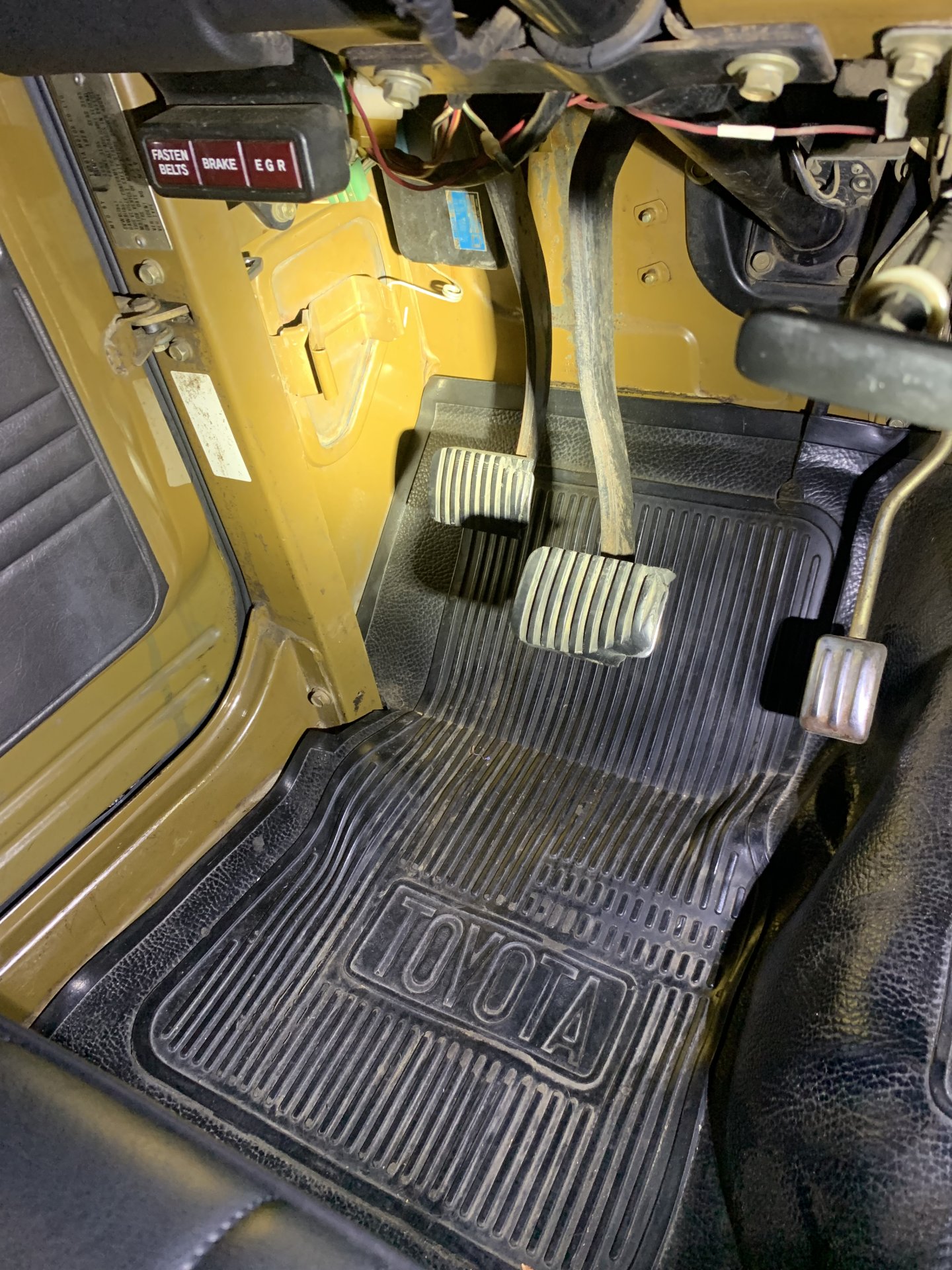

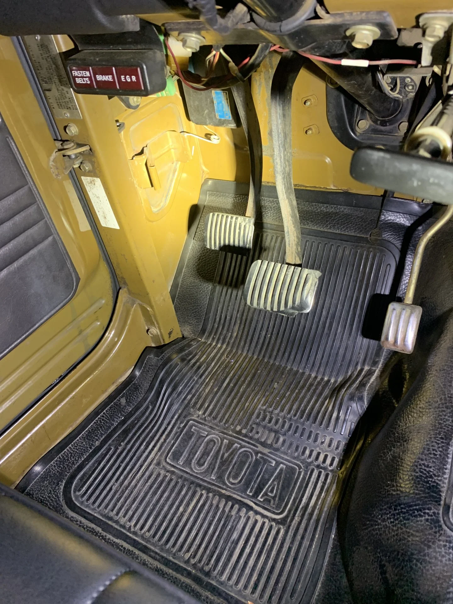

I recently replaced both my clutch master cylinder and slave cylinder. I’ve driven about 100 miles on the setup without issues so far until today.
Noticed the clutch pedal seeming close to the floor compared to the brake pedal and as I was driving it was staying further down in the travel. It finally got to the point where the clutch only seemed partially engaged and I barely nursed it home being very lite on the throttle and shifting carefully. Opened the hood and the master cylinder reservoir seems overfilled like fluid is backing up. It was only to the “full” line previously. Other than that, visually I couldn’t see anything that seems out of sorts.
Is my clutch finally biting the dust or do I have a bad master or slave cylinder? Any ideas on what I can do to troubleshoot before diving into the clutch itself?

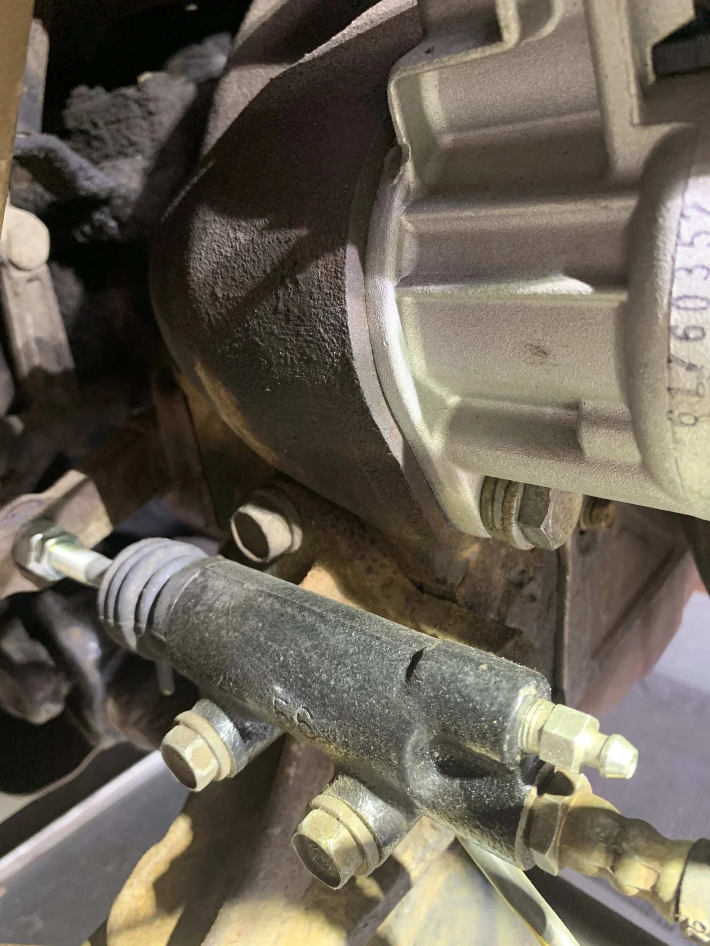

Is your slave pushrod adjustment tight: the nut tight so it can’t turn by hand independent of the pushrod?
I don’t see a return spring on the slave either?

That is odd. Sounds like a hydraulics problem, not a clutch problem. What happens if you loosen the bleed screw on the slave? Does fluid drain?
Checkout the push rod. My guess is the masters pushrod loosened up and is out of adjustment. Be sure there's a return spring on the throw out bearing fork and the t/o bearing is not riding on the pressure plate at rest. #3 adjustment is not when you feel pressure, it's when the slave starts moving.
That’s my thought at the moment as well. Fluid did drain but not much and there is still pressure in the pedal and the reservoir is still completely full. It’s as if the fluid is stuck and the clutch is partially engaged.
Release the slaves bleeder and see if the rod retracts. If it does start adjusting per the fsm. There should be free play at clutch adjustment rod with the s/c piston fully retracted and return spring on.
As said above with releasing the pressure. That’s where I was going with the slave pushrod. Fluid excess in the master had to come from somewhere: likely out of the slave cylinder.
