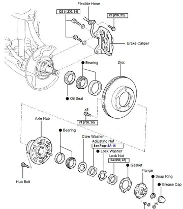

See pic below with bearings...it seems like the inside bearings would have more play.

If no play or sound from CV & brakes look good. Then I'd pull off the grease cap too check the snap ring gap. Make sure you pull the axle out tight. Note: IMHO FSM spec for wheel bearing adjuster nut torque is too light, needs to be around 12 ft-lb for stock set-up even higher torque for modified front end with oversize tires.
And why do you think that? Pretty sure Toyota's engineers are spot on ensuring you don't burn up your bearings overtightening the spindle.
