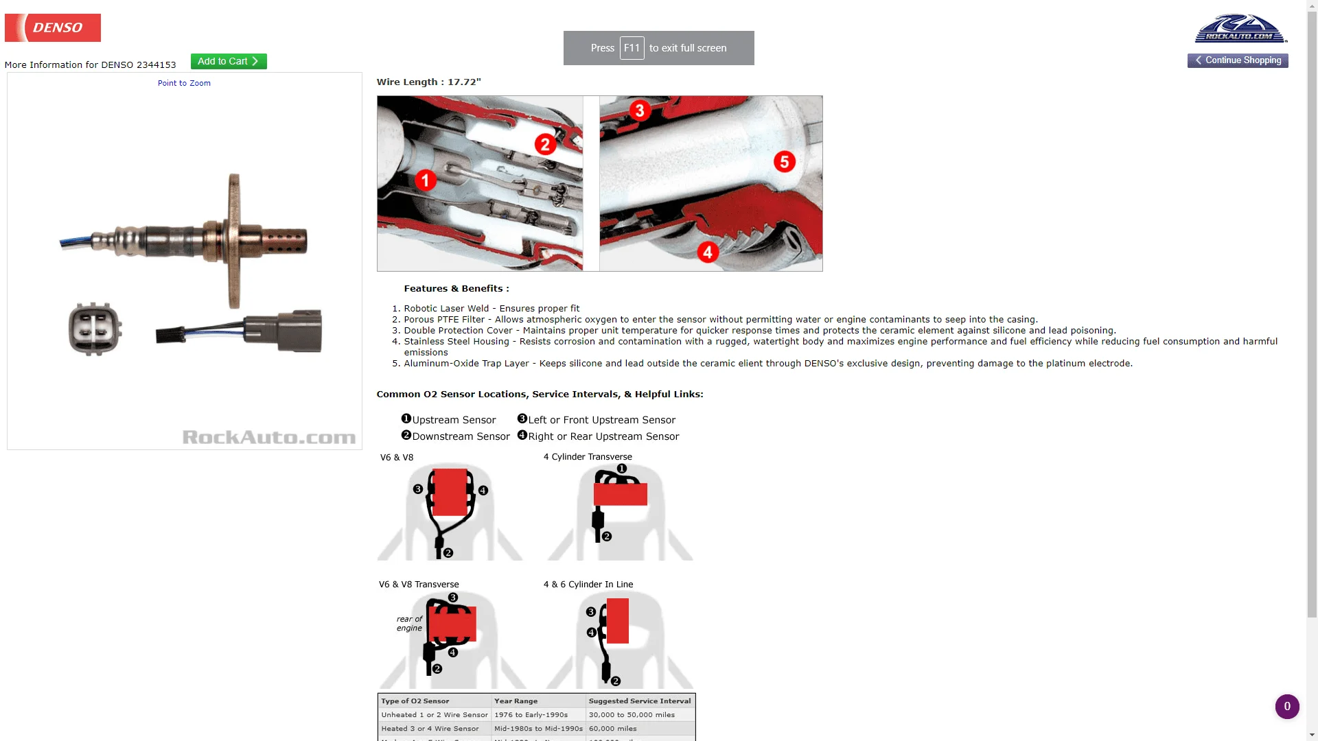

O2 sensors breathe oxygen through the wire connectors, so putting grease or cleaners in the plug is risky.
"Older style oxygen sensors actually have a small hole in the body shell so air can enter the sensor, but newer style O2 sensors "breathe" through their wire connectors and have no vent hole. It's hard to believe, but the tiny amount of space between the insulation and wire provides enough room for air to seep into the sensor (for this reason, grease should never be used on O2 sensor connectors because it can block the flow of air). Venting the sensor through the wires rather than with a hole in the body reduces the risk of dirt or water contamination that could foul the sensor from the inside and cause it to fail. The difference in oxygen levels between the exhaust and outside air within the sensor causes voltage to flow through the ceramic bulb. The greater the difference, the higher the voltage reading."
"Older style oxygen sensors actually have a small hole in the body shell so air can enter the sensor, but newer style O2 sensors "breathe" through their wire connectors and have no vent hole. It's hard to believe, but the tiny amount of space between the insulation and wire provides enough room for air to seep into the sensor (for this reason, grease should never be used on O2 sensor connectors because it can block the flow of air)."
This hole is on the sensor itself on these, not the plug-in connector. The wire plug connector is 6"-18" away from the sensor on these depending on year and they are under the truck and are sensitive to getting wet.
Plugging them in and out a few times cleans/scrapes the terminals and dielectric grease around the outside where the seal is, helps seal out any water when driving through puddles or ponds to reduce corrosion.
On the newer styles (not sure year range) the connector is directly mounted to the sensor and is more susceptible to this issue of "not breathing".
I don't think so, but I could be wrong. The directions on my new NTK sensor specifically said to not use any contact cleaner.
See the attached diagram (Note item 2):
Note that the wires from the connector to the sensor are not fully encased and have no path that would be a problem for dielectric grease to clog.
We are talking about a '94 so NTK is the OE not Denso, not sure if that applies. The 3 wires (blue, black, white) are fully insulated the entire length all the way to the plug (otherwise they would short together), not sure what you mean by "not fully encased".
