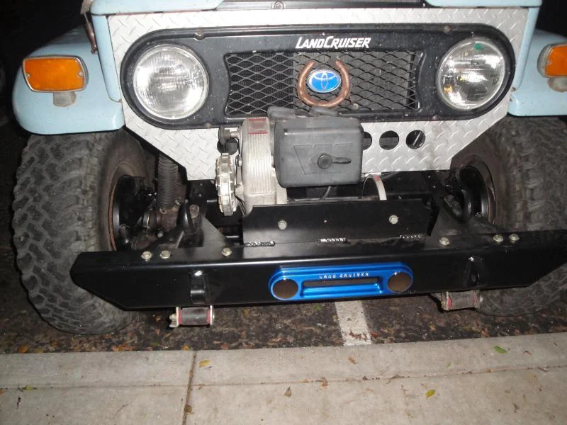

Yes, we got the line for Claudia's 8274 on the '40 from Southeast Overland... and in fact, I get the fairlead from that purchase as a (never-used...) hand-me-down for the '80...
it's because I got this :flamingo:
(rope not installed yet due to wiring not yet completed :o)
