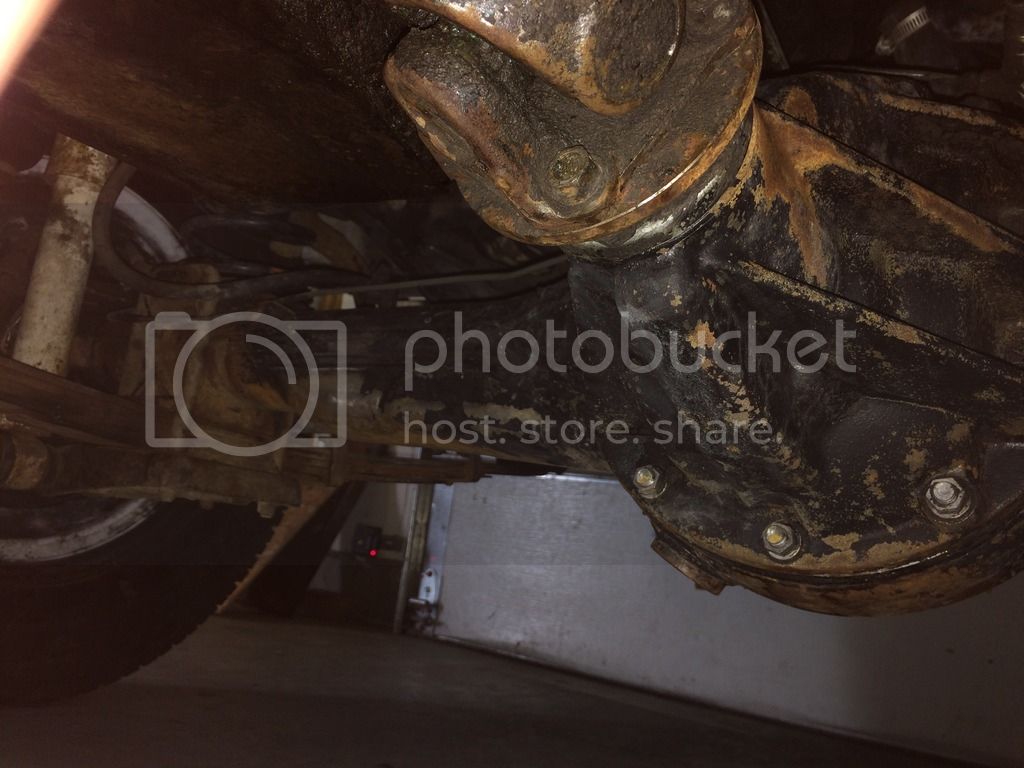

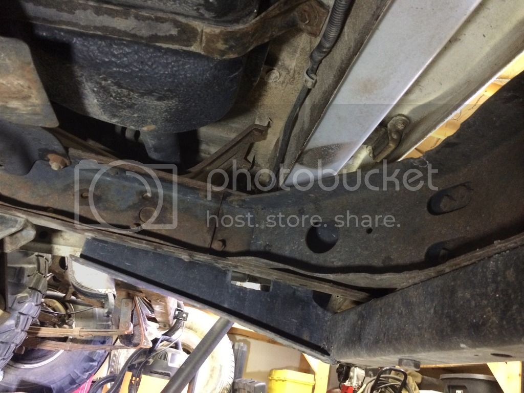

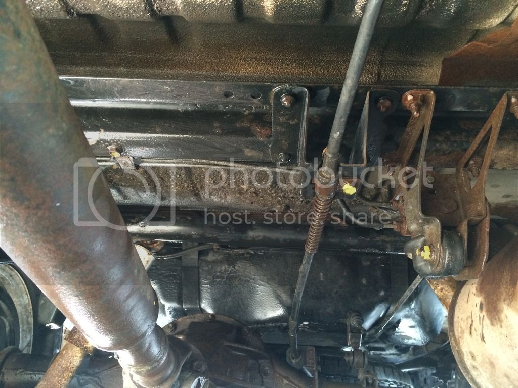

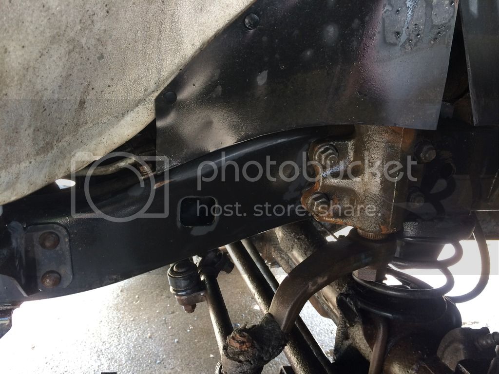

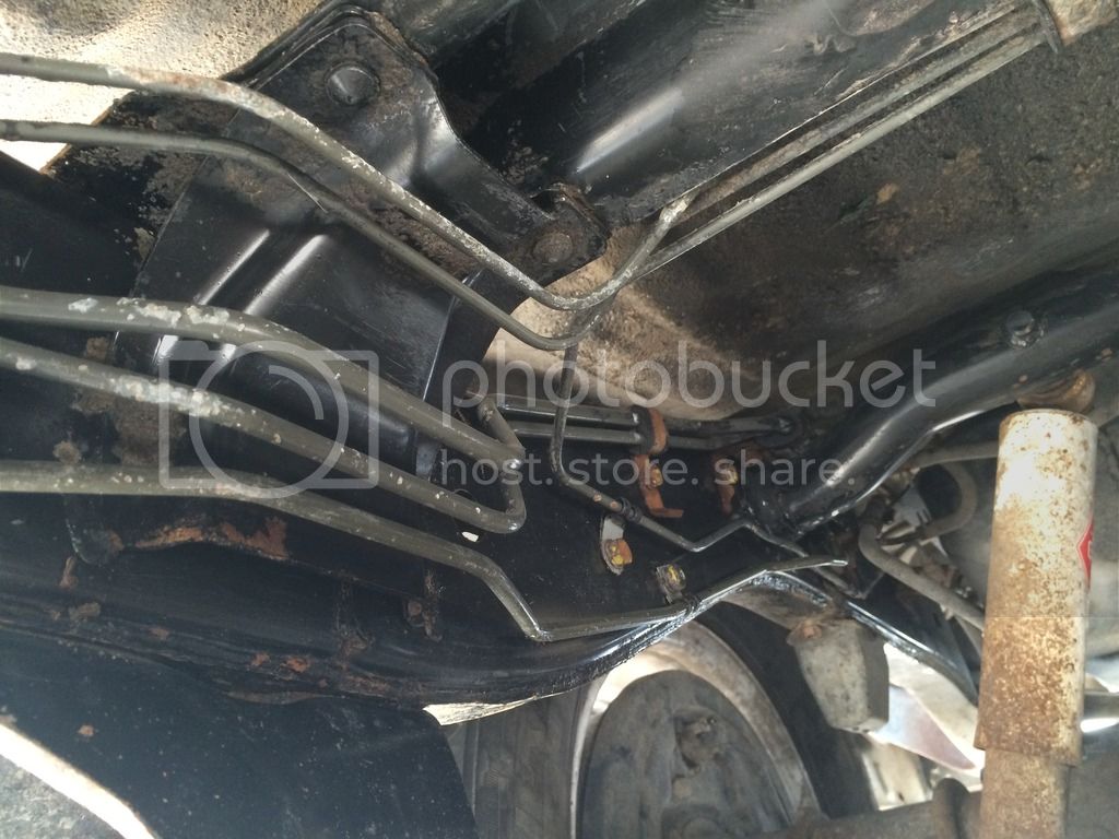

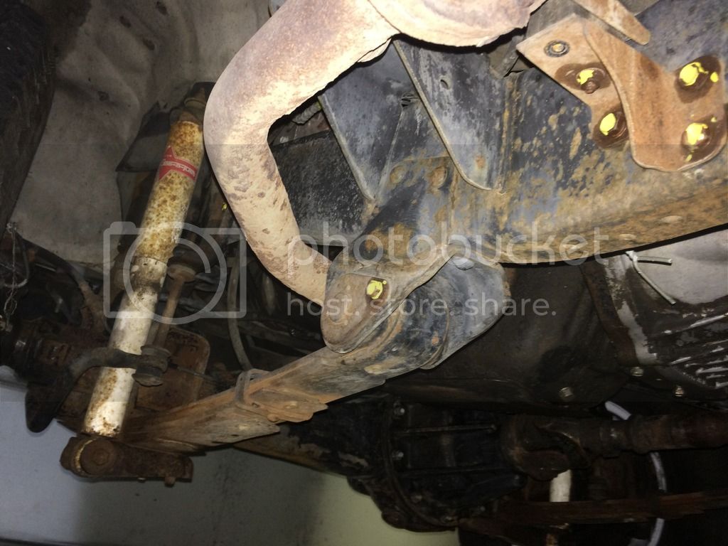

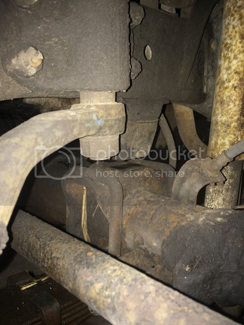

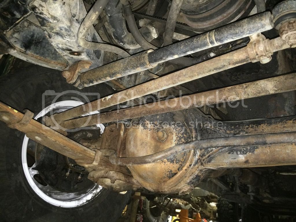

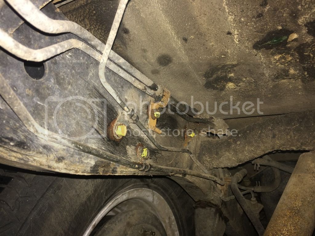

A couple pictures of the "before cleaning" situation. The yellow paint marker is to indicate which bolts I have removed, cleaned up and applied anti-seize to. Seemed like a good thing to do with all the bolts under the truck prior to painting. Pressure washing, a wire brush, purple power degreaser and a garden hose were the instruments of cleansing.
Part way through the process..
Whoa! look what was hiding under all that grime! Original paint!
And a few more to show the general situation. Yes I know my knuckles need rebuilt, it's on the list..

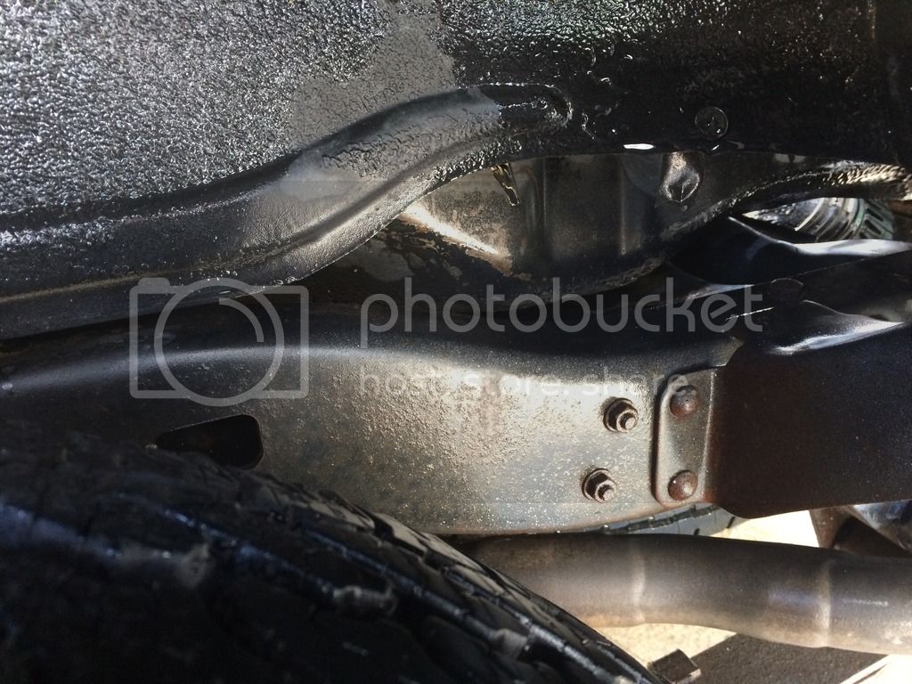

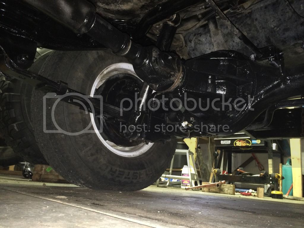

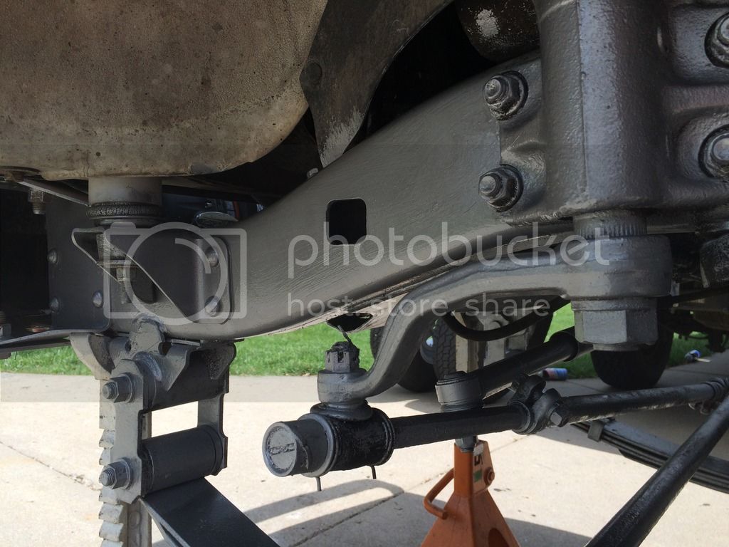

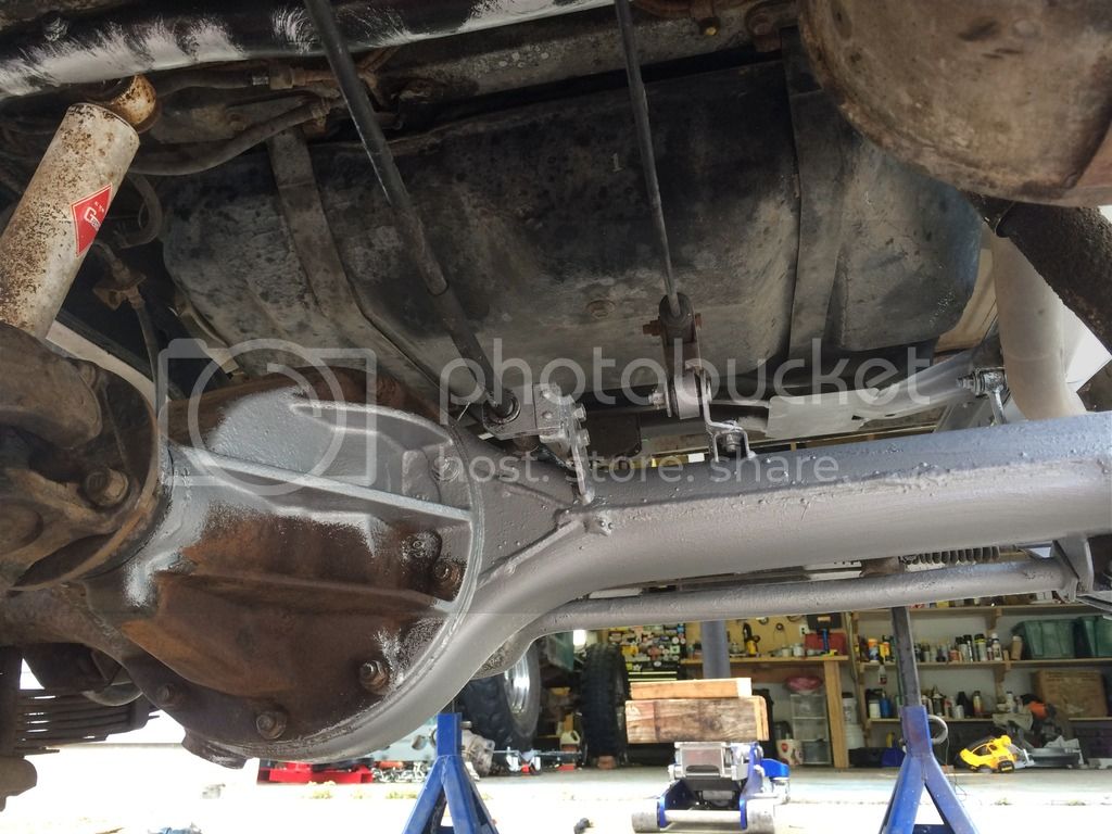

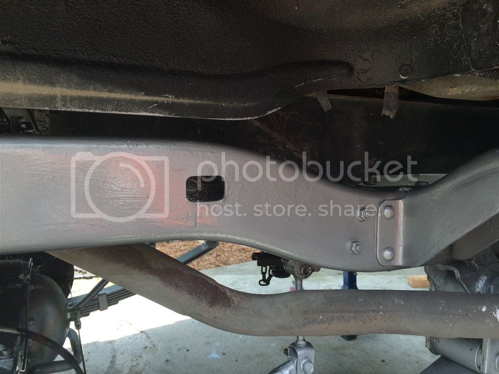

I started with the silver aluminum; a few shots:
The silver went on good, it was an off/on again overcast day when I painted and looked as if it was about to rain all morning. The humidity was very high but I went ahead with getting going on this knowing I probably wouldn't have the opportunity to devote half a day to it any other time in the foreseeable future.
I scooped out about a cup at a time, putting cling wrap over the can before putting the lid pack on each time. The paint was applied with cheap paintbrushes (the kind with wood handles you get in a 24 pack of various sizes for a couple bucks at Lowes.) I tried foam brushes, and they left a smoother finish but the paint turned the foam into a floppy mess in short order. I think the paint would have leveled out better were it not for the very high humidity ( 90%+). The second coat of silver was very hard to see over the existing paint, as the wet and dry paint looks identical. I tried adding a little of the black into the silver to darken it up, which did help a bit. It didn't look like it mixed very well so I was hesitant to put more than a couple of teaspoons into a cup of silver.

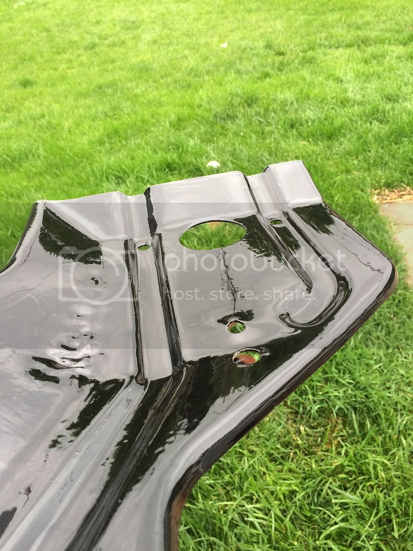

When I started with the black, I started having some issues. During the silver application, by the time I made it back around to the corner of the truck I started at the paint was already dry to the touch. The night before, I had tried out the paint on the skid plate to see how I could expect it to behave. The silver went on great, and the black was also very nice. It went on much thicker than the silver and flowed over the brush marks beautifully. The final finish was mirror like.
I didn't take as many pictures as I should have, as it became quite tiring crawling around trying to get coverage on everything and I just wanted to get done.
The black started thickening up quickly, and started going on thicker and thicker and was curing before it would level out like it did on the skid plate. I'm confident I got everything covered good, but the finish wasn't as nice. When I had two coats on, I hit the whole thing with some gloss black Krylon spray paint as a topcoat.
I think this would have turned out better (aesthetically) had the humidity not been so high. Hopefully it will hold up. The next step will be to mix up some Waxoyl like concoction of mineral spirits, paraffin wax and bar and chain oil to coat everything including the inside of the frame. If I don't get around to that it should be sufficient to spray fluid film inside the frame before the winter.
