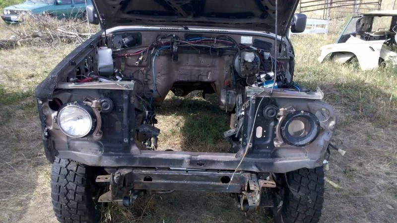

Ok, I have a naked frontal pic of the rig with all fenders and wells off.

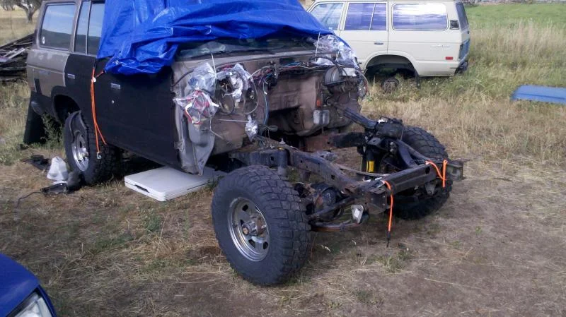

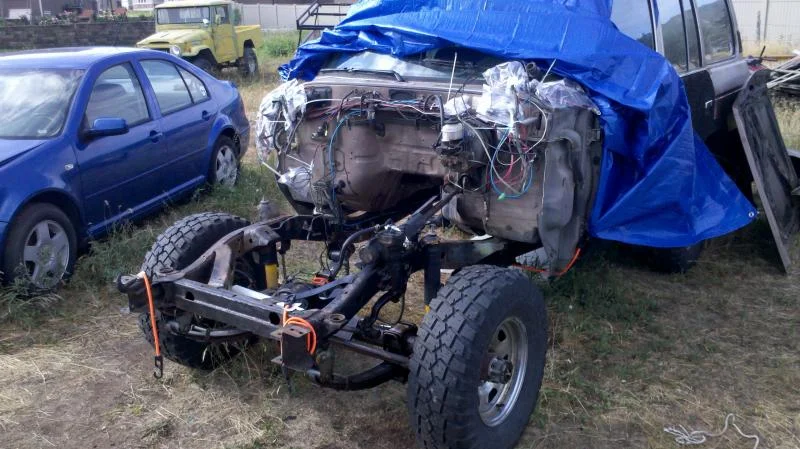

Why the tarp and the baggies on the cables? It rained the past 3 nights, and the labels on the wires started coming off - NOOO!
Well, instead of using a cordless drill and brush, I am using Jake's DeWalt 12,500 rpm grinder with a brush installed. Pic of the brush is above in prior post.
It surely rips the rust and debris off, and the old paint. The front part of the frame (forward of the engine mounts) looks really nice now.

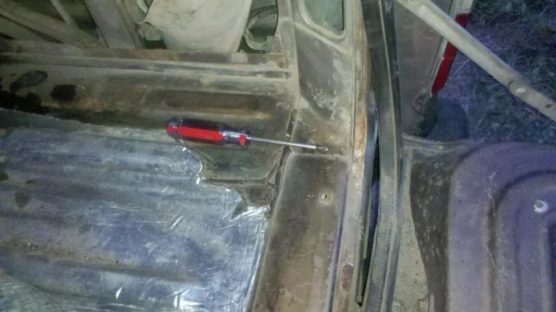

Below are some pics of the right rear gate area and the vertical stud. The tip of the screwdriver is just above where I believe the bolt should be for the last mount.
How does one GET to it?
After spending a hour or so searching/reading and searching some more, I posted the prior post. Then I went search again for an hour and found
https://forum.ih8mud.com/60-series-wagons/532898-body-mount-swap-1-lift.html
where he posted pictures of where to look for those little access panels. You access them from UNDERNEATH the rig, not from on top like the other 5 do.
So, I found my answer.

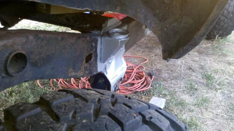

Got the body mounts wire brushed, and the Rust Bullet Metal Blast on them, and pictures of one coat of the Rust Bullet. Painted frame mount
points and the bottom of the body mount surfaces.

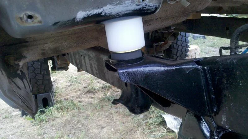

BTW, got the pucks, bushings, washers and bolts on, save for #3 and #4, the bolts are too short by 1/2 inch. So I will visit the hardware store tomorrow morning for a grade 8, 6 inch bolt instead of the 5.5 inch.
Interestingly, #2 and #6 fit snug, but #3-5 all have gaps under the body - something bent in the body?

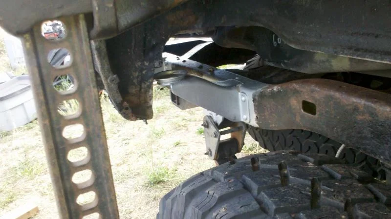

Got to "play" 8 hours on the truck on saturday.
Passenger side lift installed, now I have the driver's side up on the hi-lift, and mount #2 cleaned and 1st coat of Rust Bullet on it. Will be repeat of the passenger side. I like the height gain.
In addition, painted the front part of the frame - boy, there was a LOT of oil/dirt in the crevasses in that. Took several cans of brake cleaner - that works wonders
1st pic is #2 passenger mount
2nd pic of gap at the rear, Jake suggested a nice rubber curtain under there, until I get the rear bumper built

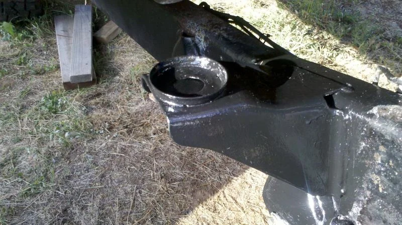

3rd and 4th pic of painted frame

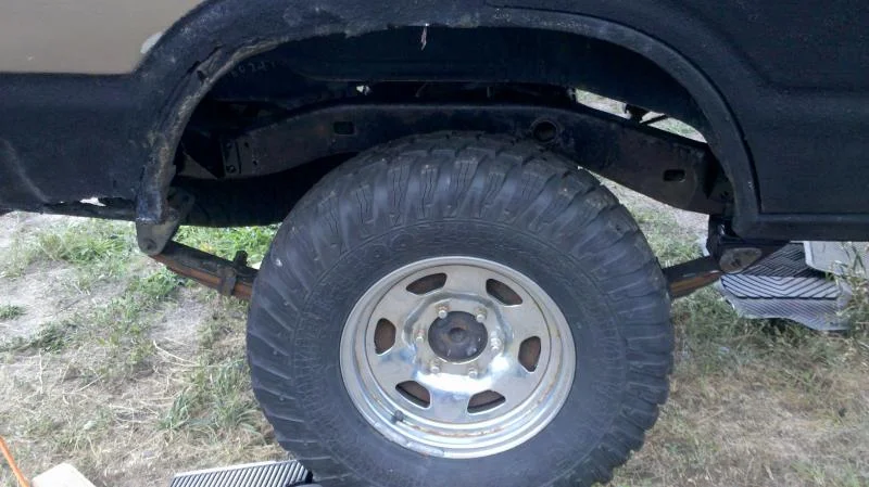

Last pic is a AFTER of right rear wheel with the lift, snow tire with studs, 31x10.5x15
Now there is some height for my rig. Forgot to get a BEFORE pic......
