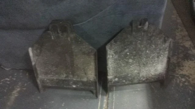

Here ya go mate.
Please excuse the state of them as they haven't been cleaned since their last use.

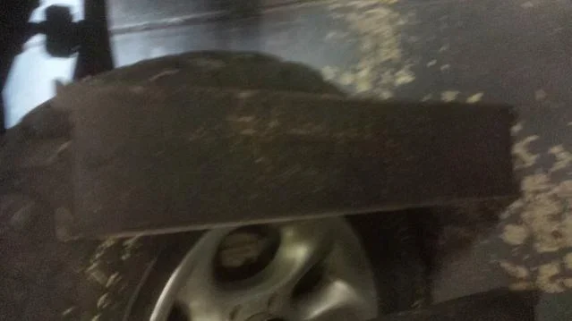

These are the 2 end pieces

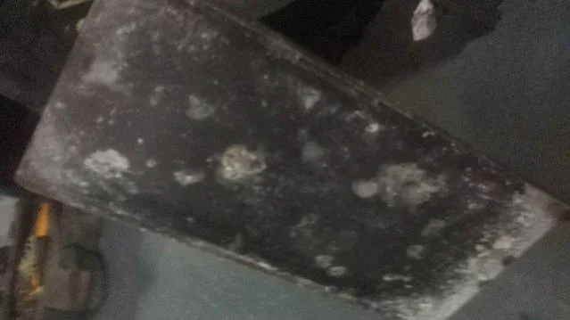

This pic turned on its side but you'll notice 4 slots cut into the edge of the end piece.

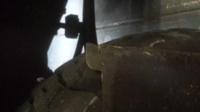

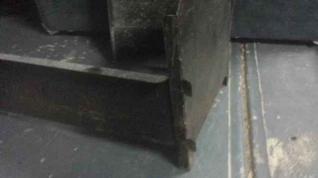

This is 1 of the side pieces,,notice the lugs on the end
Here's a better pic of the lug
The lugs on the side sections slide into the slots on the end piece and push down to lock into place.

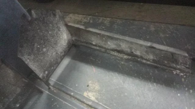

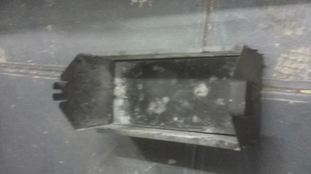

Its abit hard to see but there is a flat fold on the bottom of the side piece

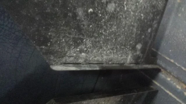

What it looks like with both sides on and connected to each end,,be sure the flat folds on the botton of the side pieces are facing inwards so the bottom plate can sit on these, not a very good pic but I think you get the idea.

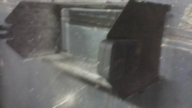

Bottom plate, again, please excuse the state of them.
Bottom plate simply slides in between the side pieces and sits on the 2 flat folds that face inwards

Perfect, thanks. I think the dimensions are in your first post. I appreciate you taking the time to do this. Looks like maybe a nine beer job to me......:beer:
