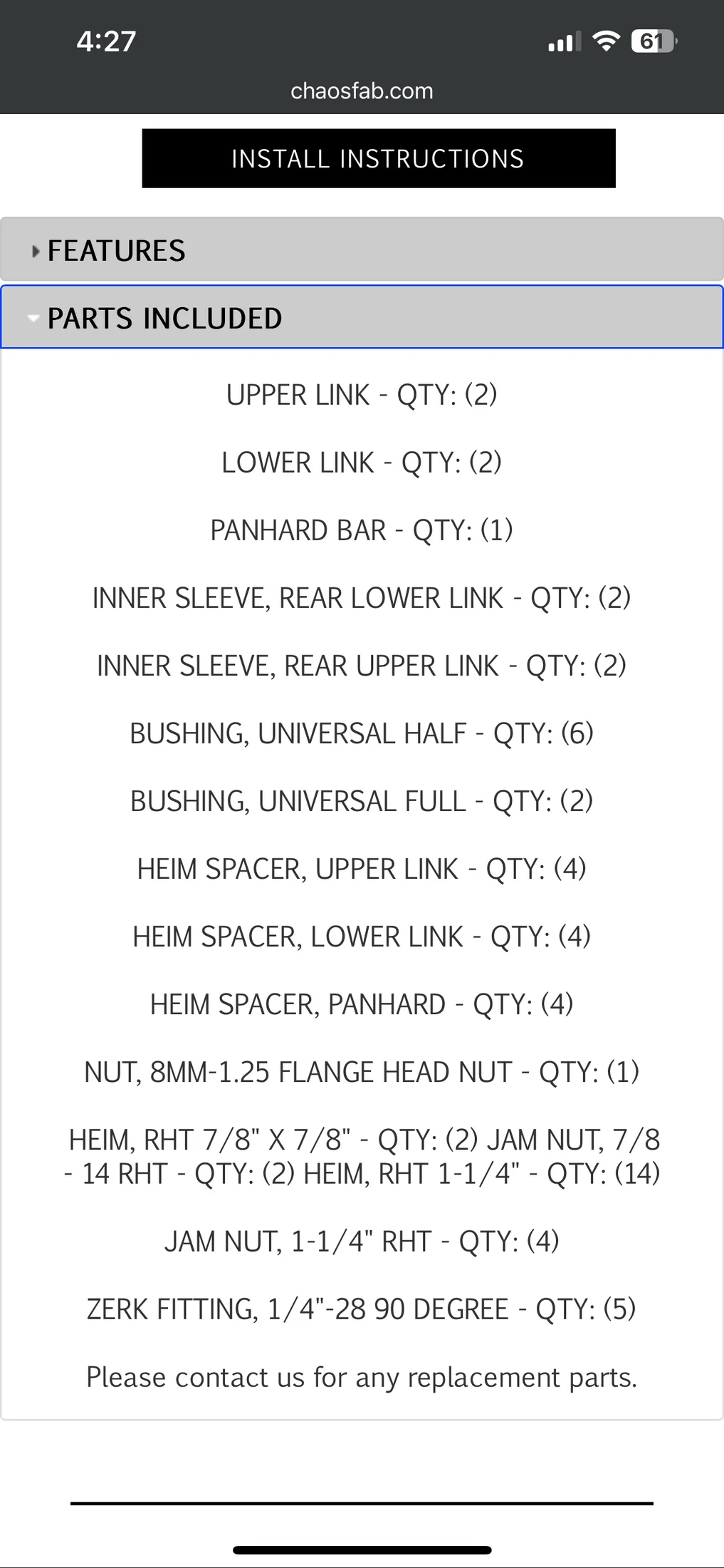

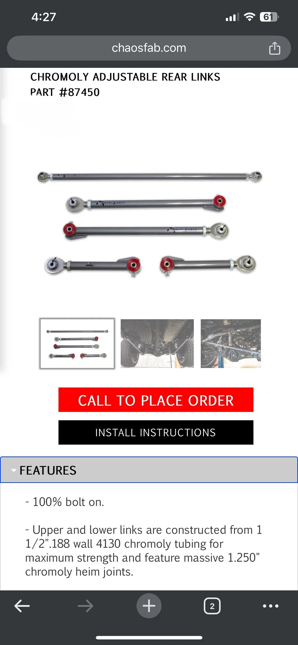

Anyone install these yet? Box is in the garage looking forward to squaring the rear up.

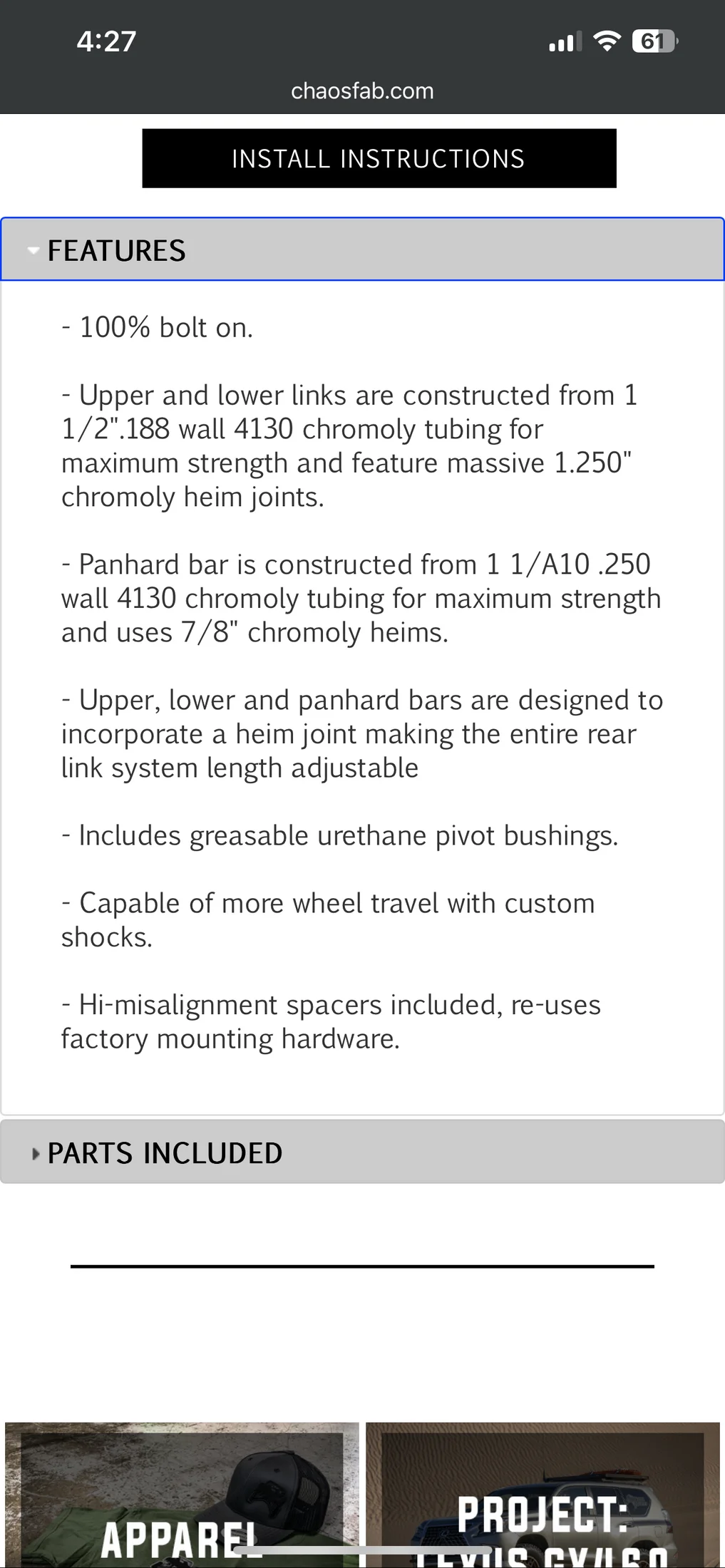

I don’t have any experience with these but I’m going to guess that the heim joints are going to be squeaky and more harsh feeling then factory bushings. Be sure to post up how it goes though! I’m definitely curious
Street car with race parts isn't often the upgrade it might seem to be.
I had them on for a little bit. The mounting bolts on the bushing sides kept coming loose, no matter how much red loctite I put on the mounting bolts. On one of the upper links, I lost a nut and the bolt backed out about half way. After that, I decided I really didn't gain anything from their links and wasn't worth the risk. Took them off, but left their panhard bar on for lateral adjustment.
Much happier with links with OEM bushings and bolts not coming loose.
