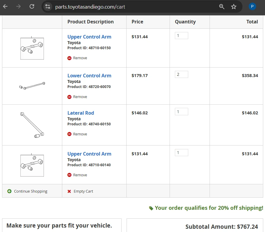

Refreshing the front and rear suspensions. I already have all the front LCA and UCAs ready to go.
I like OEM parts and there's no question they will quietly do the job that's expected of them. No small things that these are also robust Land Cruiser parts. It's hard to do better and oftentimes the aftermarket does it worse.
Found great prices from toyotasandiego.com. Not free shipping but even as they are local, shipping is cheap enough that I'll just get them delivered to my front door.

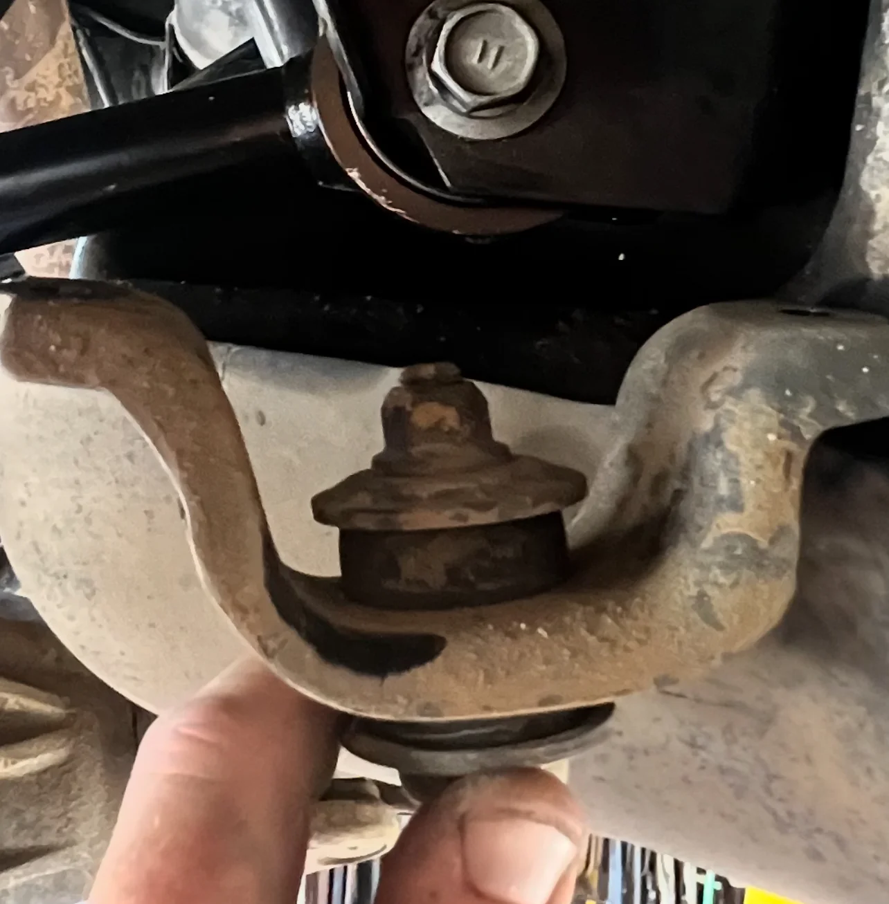

Also, on the rear swaybar, my main large bushings were in decent shape (replaced them anyway), but the small donut bushings on the links were completely toast, one was missing, guessing just fell completely apart overtime.
Definitely a while you’re in there item, as you have to remove those anyway to droop axle.
