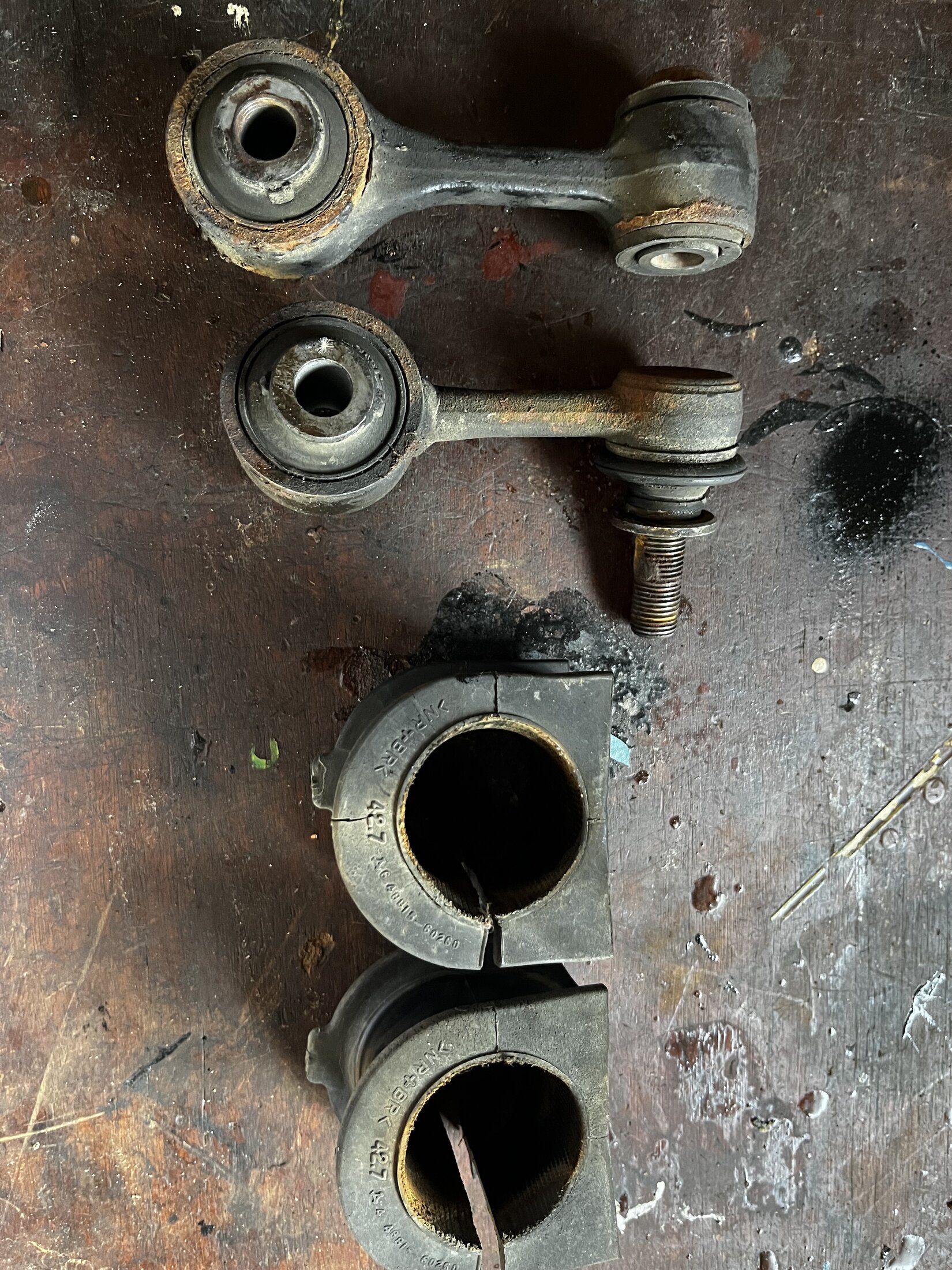

I just did this today on the front axle. 141K on the rig, midwest vehicle. Links and bushings looked pretty good actually. Ball joint on the right link was still pretty tight, even. I'm amazed at how beefy this stuff is (the nut is 19mm for a sway link, LOL), it's insane. I do think it's noticeably nicer driving (less roll in turns) but not like night and day different.
BTW insanely EASY job, piece of cake. Not even 1 banana of a job. I was waiting for an unexpected battle to come up or wrestling match with the bar but NOTHING. Not even an hour, no skid plate removal even.
did you replace entire parts or just bushings? if bushings, what is best method to remove or punch out? thx in advance
Entire parts. One link has an integrated ball joint. The other link could just have the bushings pressed out but meh, by the time you add up the fuss of that it makes sense to just get the part which comes with the bushings installed. I don't think this was remotely needed at 140K and a bit of a waste of money at this mileage. Glad I did it but definitely not an urgent need at all.

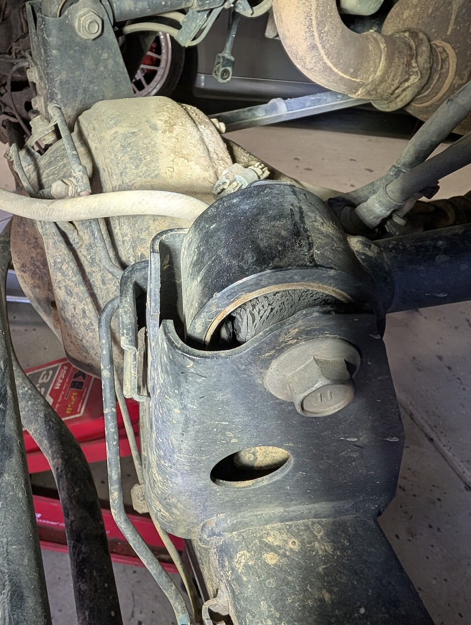

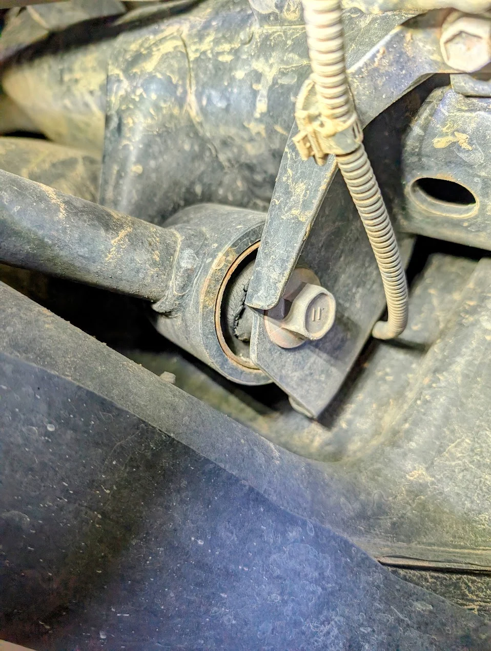

Bringing this back to the top. As @Boston Mangler suggested, the bushings can get used hard on this truck. Probably true for any modern vehicle approaching 200k, but there's some bushings that take more wear than others.
Notably the rear upper trailing links. Took a closer at mine this weekend and they look similar to his. For context, my rig has 175k. Some good towing miles. Lots of fun crawling off-road regularly, fast desert running, and overlanding trips.
Rear upper control arm forward bushing
Rear upper control arm rear bushing

Holy Hell Man!

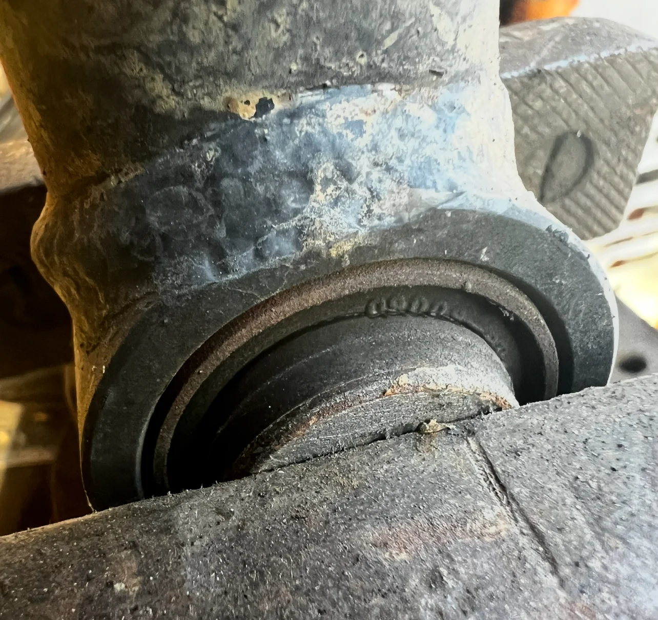

For context, mine looked perfectly fine while the truck sat at ride height. It wasn’t until I took mine out (replaced them simply because the ones in my 100 came out in pieces so I knew they wear) and put them in a vice to check them did I notice how cracked and toasted they were.
Glad you’re addressing this
Will likely notice a substantial difference

570s have track bars? Out of all the arms I took out and replaced, my trackbar was probably the worst, the bushings were literally split in half and detached from the sleeve, random FYI
Look close
