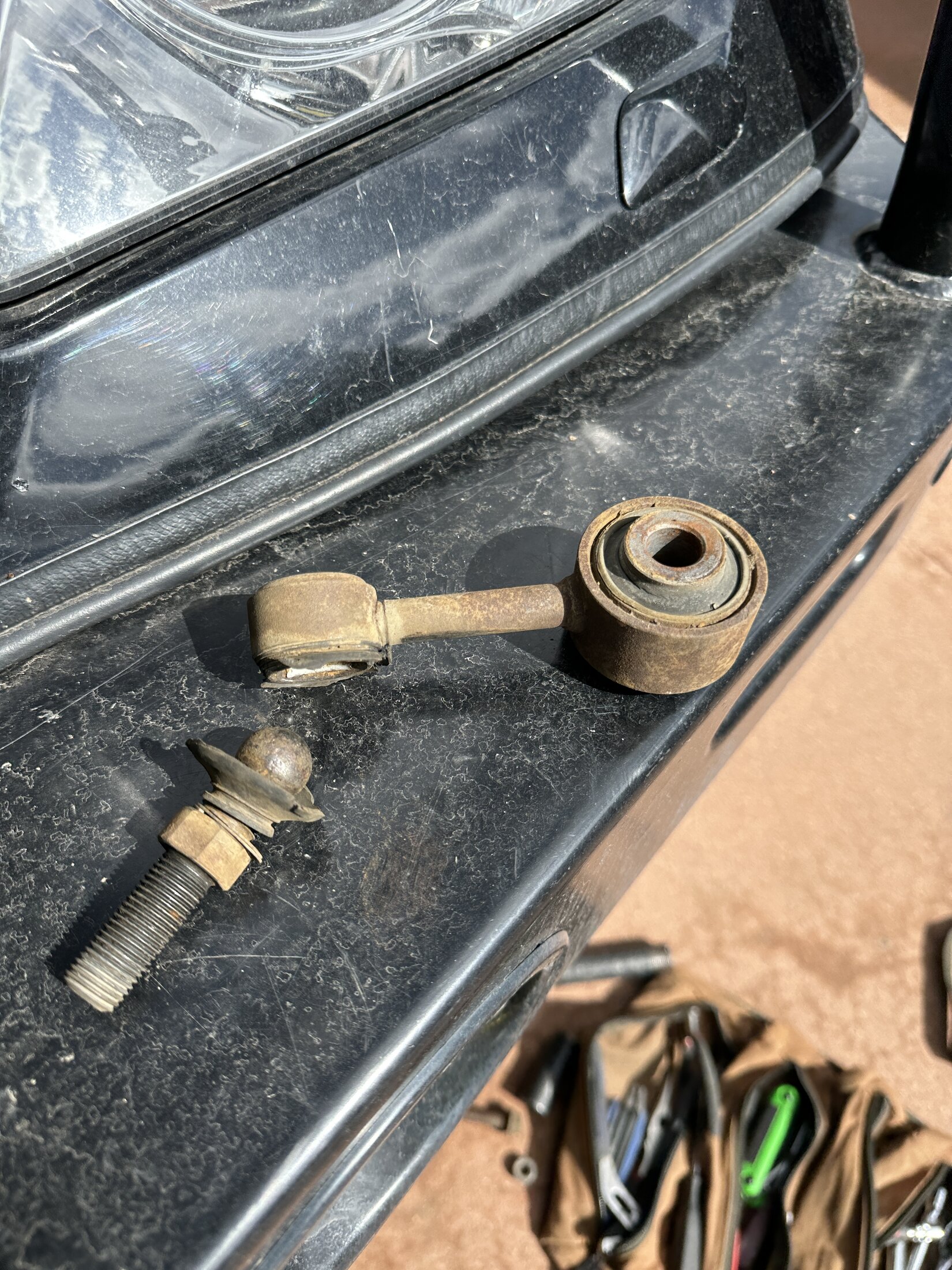

Hey All
I covered this in my build thread, but figured would also make a separate post as well.

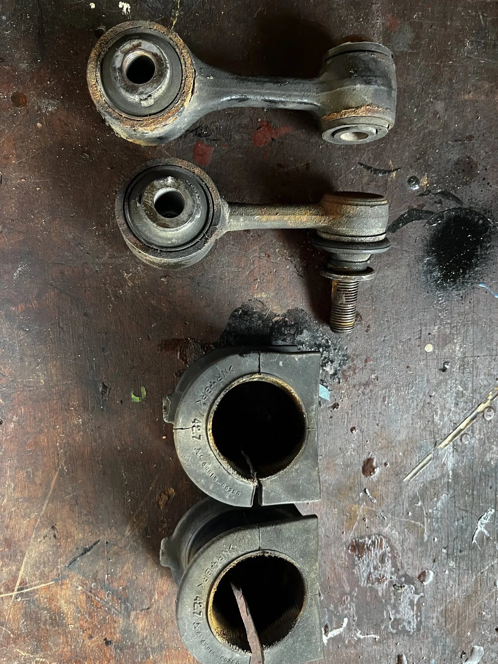

During refresh of my suspension bits, I was baffled by how torn, worn, and toasted ALL of the bushings were.
Replaced ALL with new OEM and it’s honestly a completely different truck. Night and Day improvement!!
Other than the sway bar links, all of these LOOKED fine while on the truck.
My truck was strictly used as a commuter and never ever seen dirt during its 215k life, and these are this bad.
Soooo…. Check all your rubbers!
The OEM complete assemblies are quite affordable
2010 200LC 215k
Swaybar Link:

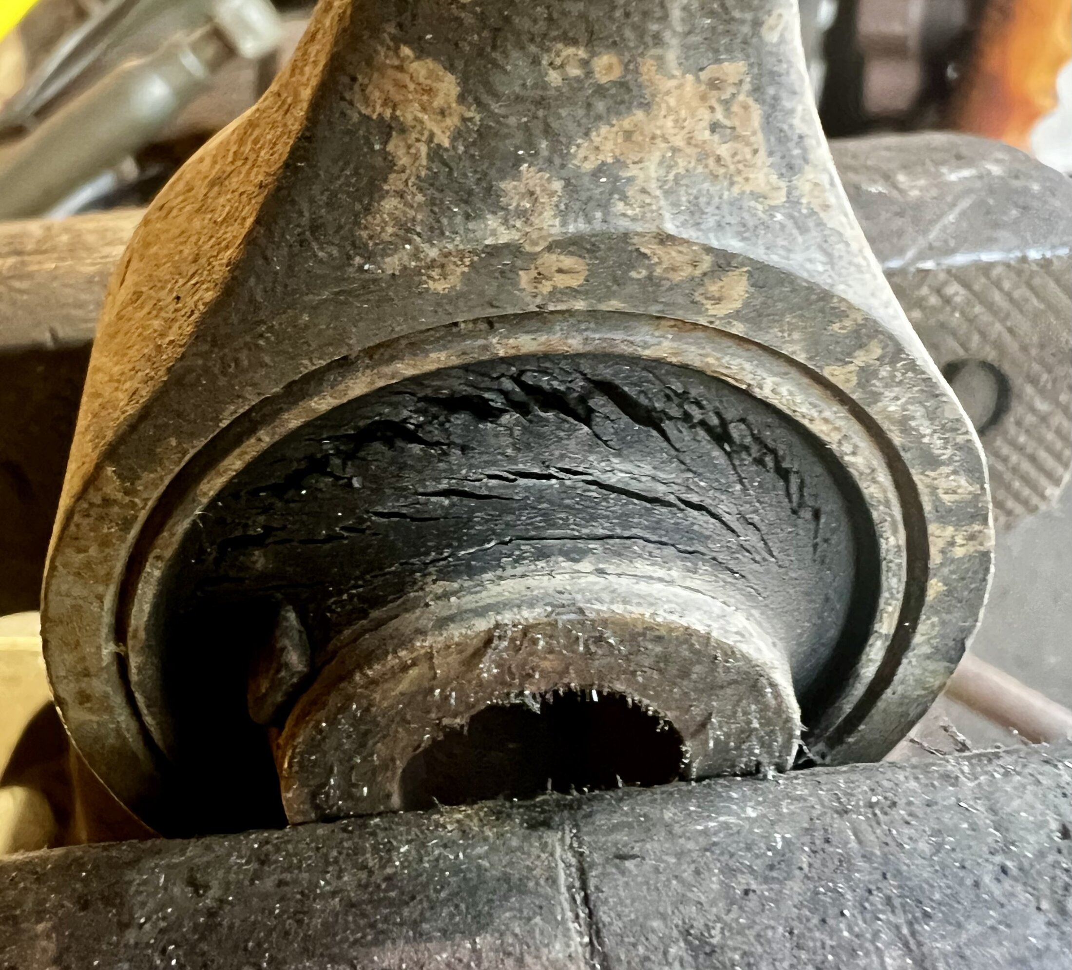

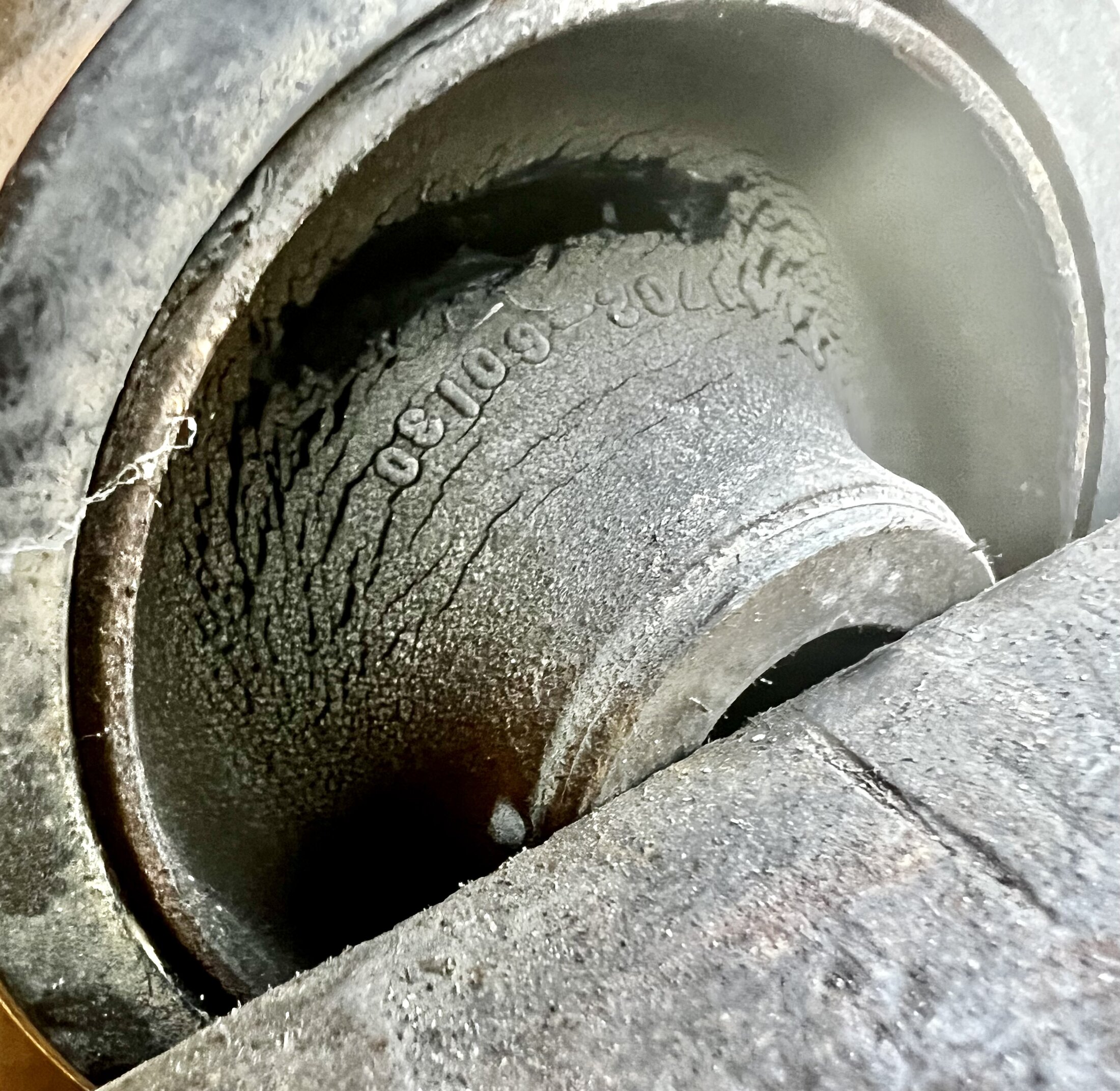

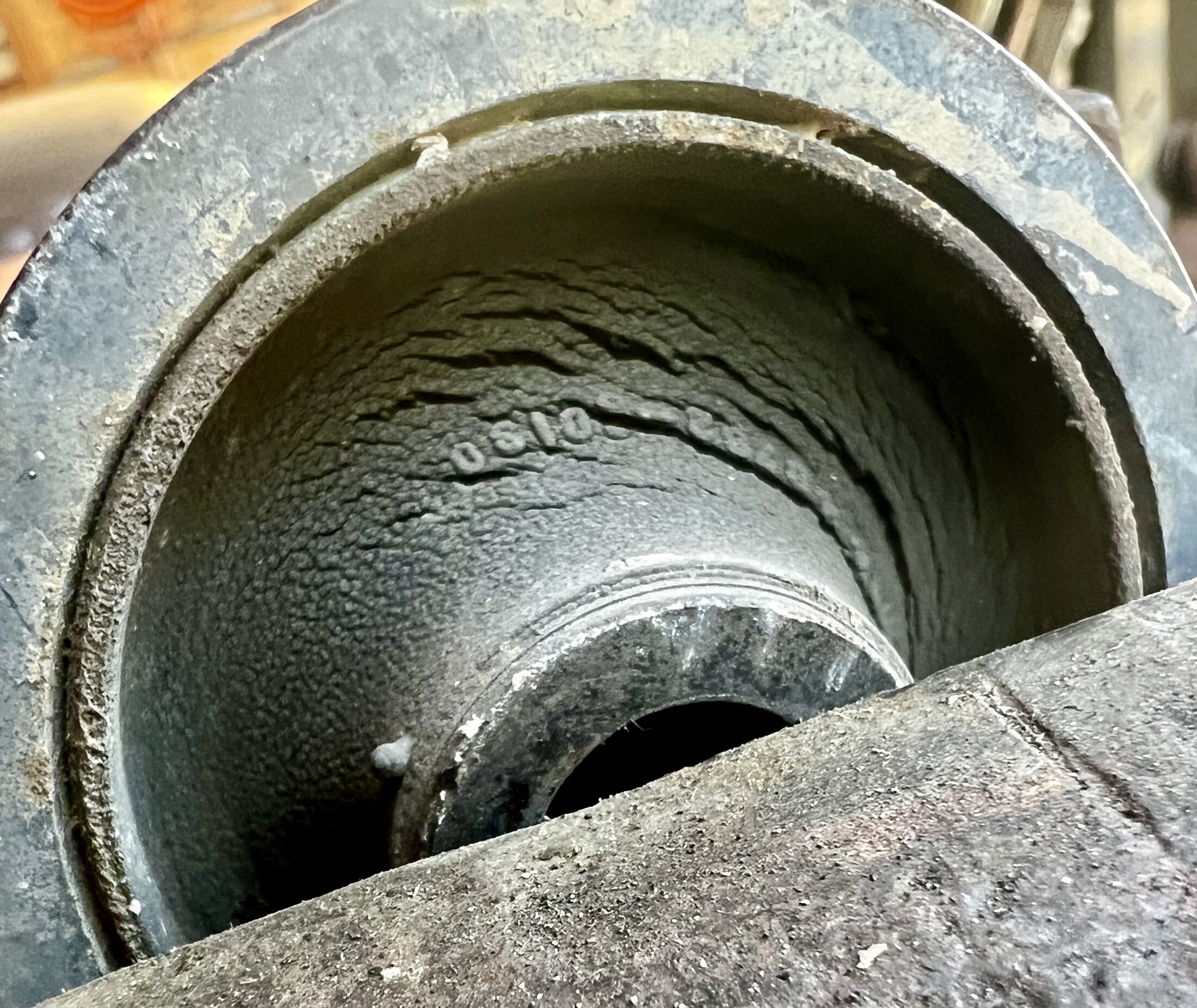

Rear Upper Arm (yes, that’s a gaping hole):
Rear Lower Arm:

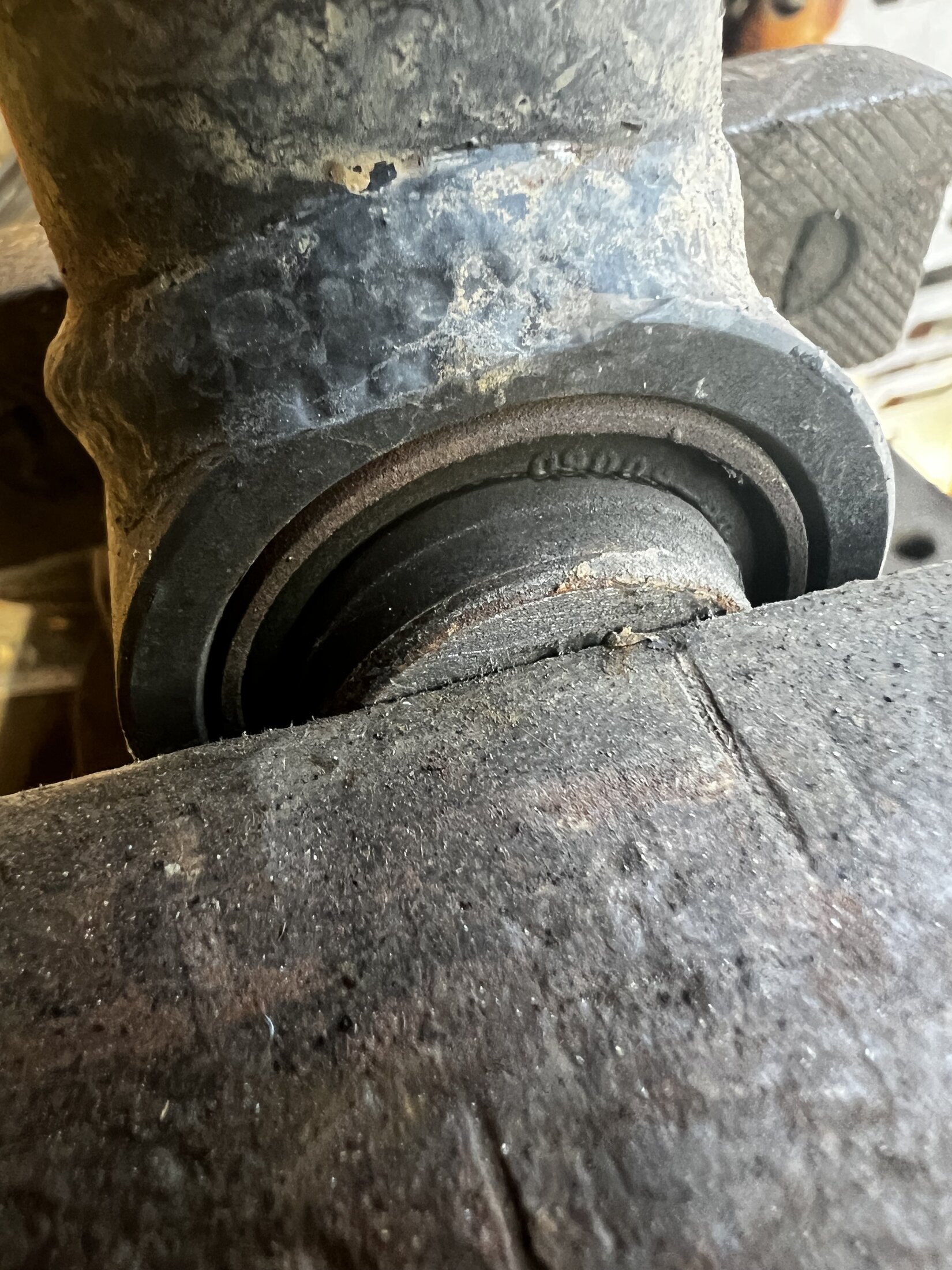

Track Bar (completely split):

My rig had 215k on and it never seen dirt, and was strictly a commuter and ALL my rubber was SHOT
