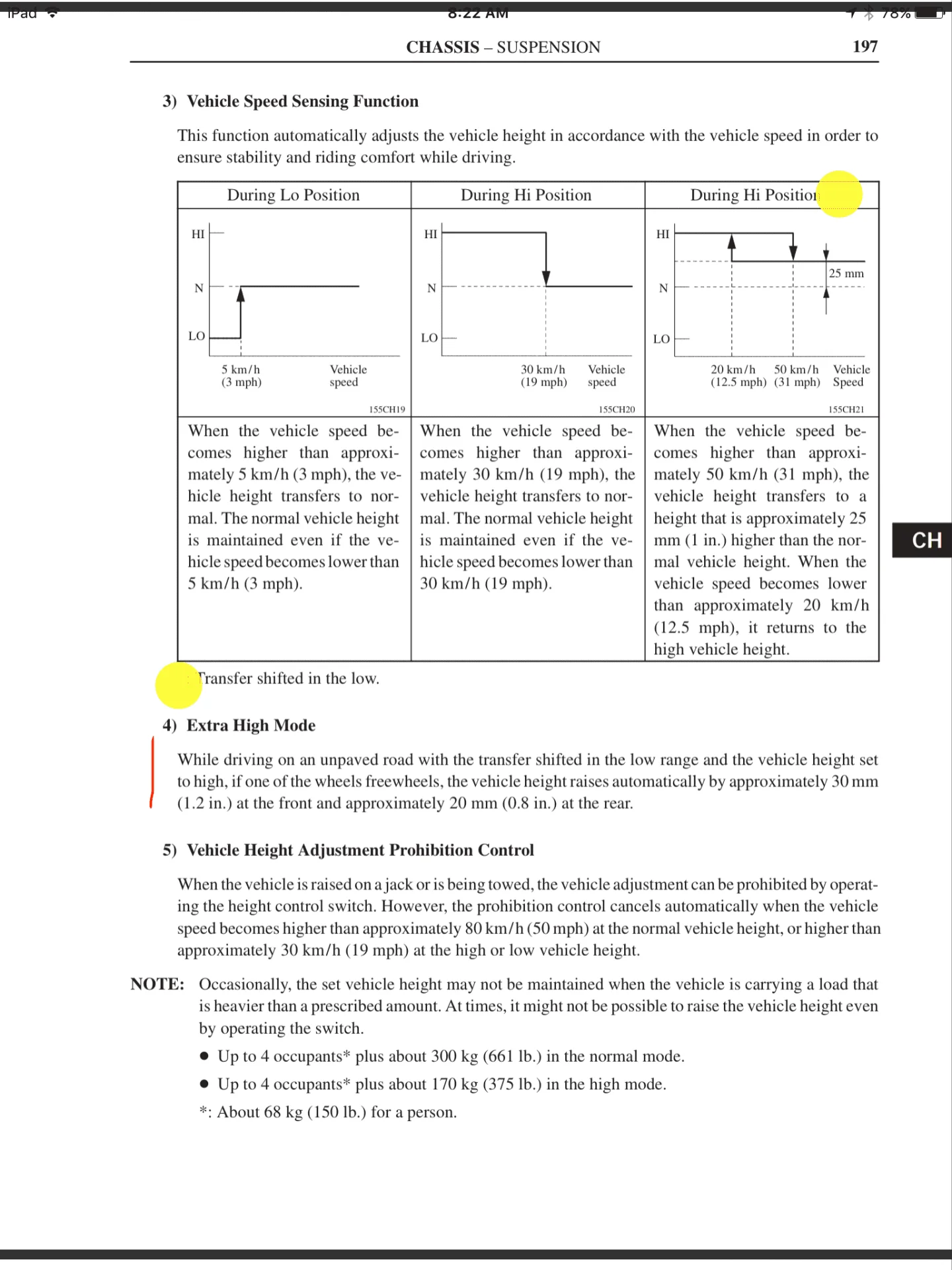

What I do find however, is the car will not stay in L or H - as I being to drive it reverts back to N. In H it seems to trigger this above about 20km/h and from L almost immediately after I started to move again. I'm guessing this is not normal? If this some sort of sensor issue?
Not sure on this Paddo best to ask or if someone else can give input.My does this sometimes to in L.
I'm pretty sure this is a normal function of the AHC system. Once you get over a certain speed the system automatically adjusts back to the neutral position.
I'm not sure if it has fixed the bouncy ride as yet, I'll drive it for a bit and maybe do another bleed in a months time. Given the old fluid was a bit foamy it seems there might be a bit of air in the system
You'll probably want to read up on adjusting your neutral pressures and checking your 4x damper accumulators are still serviceable with the L to H reservoir graduation check. Here's how the speed sensing works - basically it wants to go back to N.
