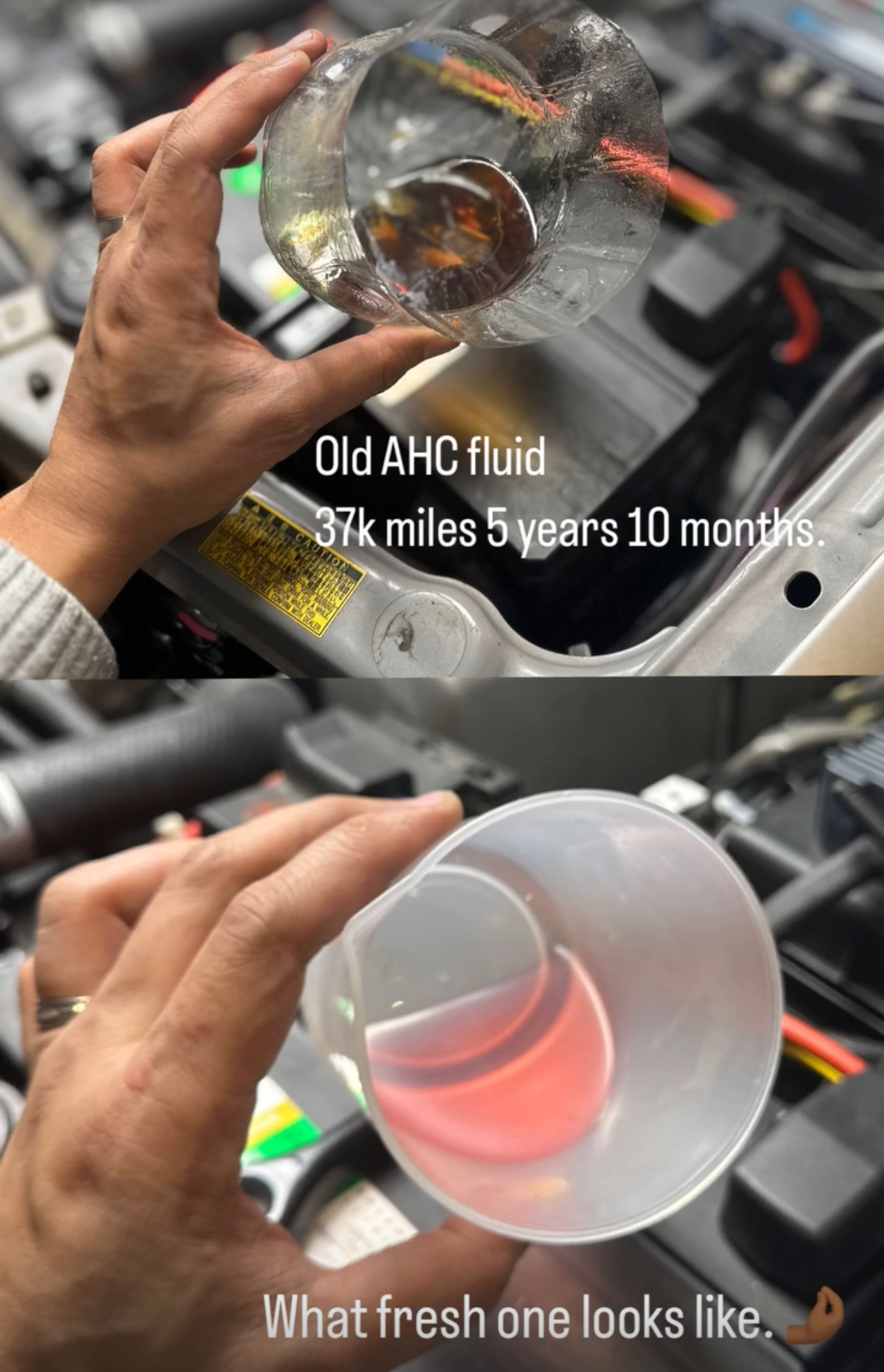

Did an AHC fluid refresh on my 06LX yesterday. Used up all 2.5L AHC fluid in the can and level in the reservoir is right at “Max”. This is after I bled all 4 bleeder valve and new pink AHC fluid came out.
