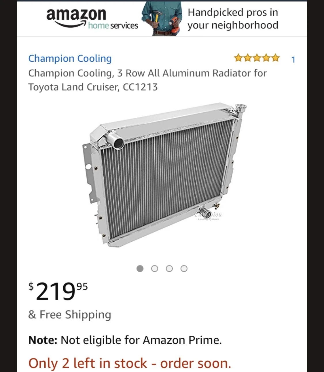

Has anyone run a jegs radiator in their 62? It's almost to good to be true price wise ($180 2 row?). But everything looks like it'll work just fine.
Additionally, what are the vendor options through the forum price wise? Money is tight but I would prefer a new radiator over a used one.

I have a champion 2 or 3 row from ebay. It DOES NOT have provisions for the stock trans cooler for an FJ62, but it works just fine in traffic in Memphis during the summer with the A/C on. About 3 or 4 years going now. I have a plate aux trans cooler in front of it that seems to be adequate.

On the FJ62 radiator, there are provisions for two transmission lines to attach at the bottom of the radiator. The lower tank is partitioned to allow the trans fluid to exchange heat with the coolant/radiator and act to cool the transmission fluid without the two fluids mixing. On my Champion radiator, there are no provisions to attach these two hoses. No holes, no divided tank, nada even though it was advertised as being a replacement for a 1988 Land Cruiser.

I also am using a Champion 3-Row. You will need to add an external transmission cooler. It is a direct replacement in that it bolts up to the factory mounts. but the trans cooler is not apart of the radiator.

You may have had an early FJ60 OEM radiator without the trans cooler lines. That would be normal, before the FJ62 came out.
Ugh, I'm such an idiot. Thanks everyone for pointing out the trans cooler lines, I just totally forgot about them until I was ready to put the new one in (d'oh!). I returned the Champion radiator and got a Mishimoto instead.
