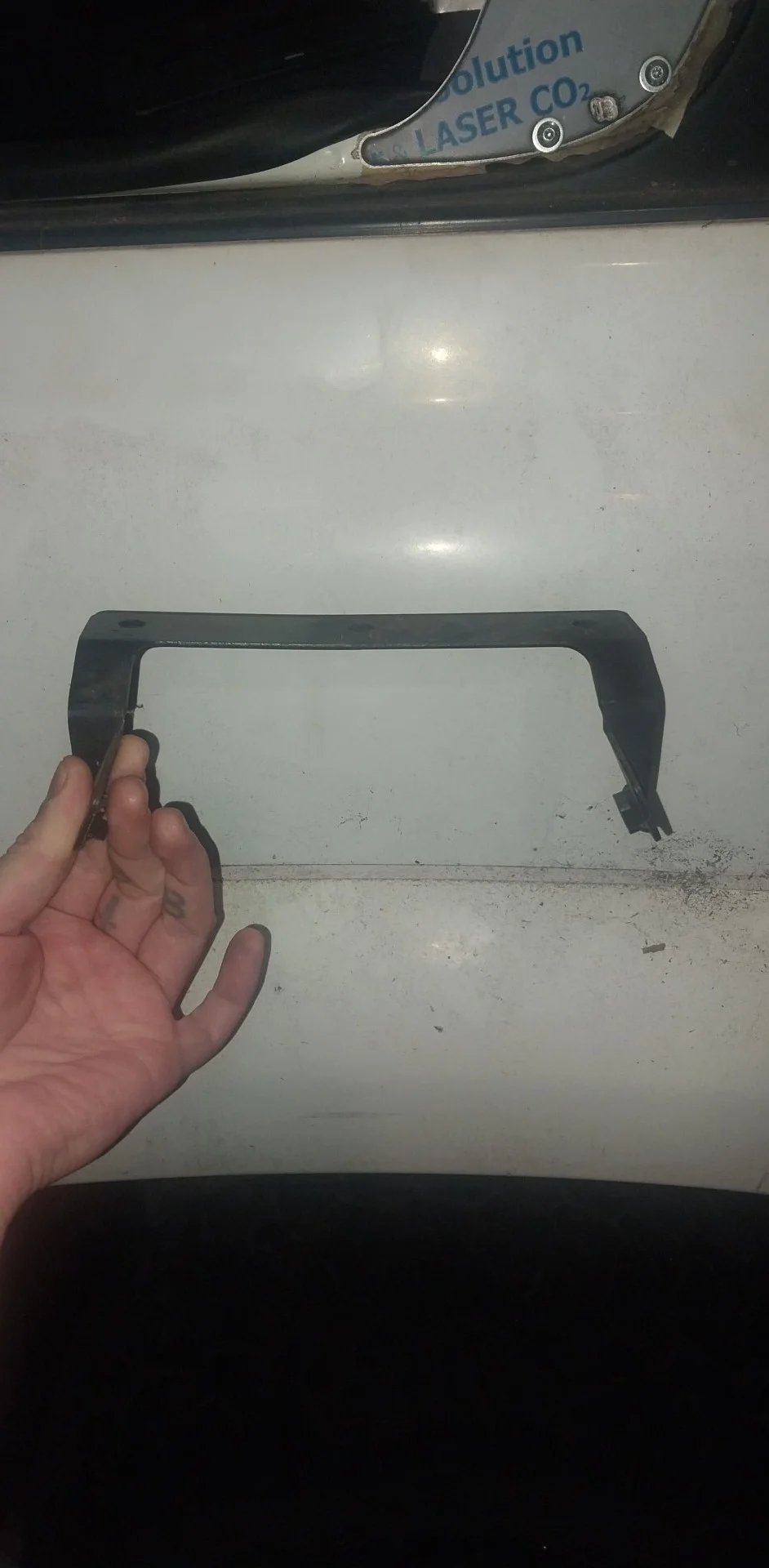

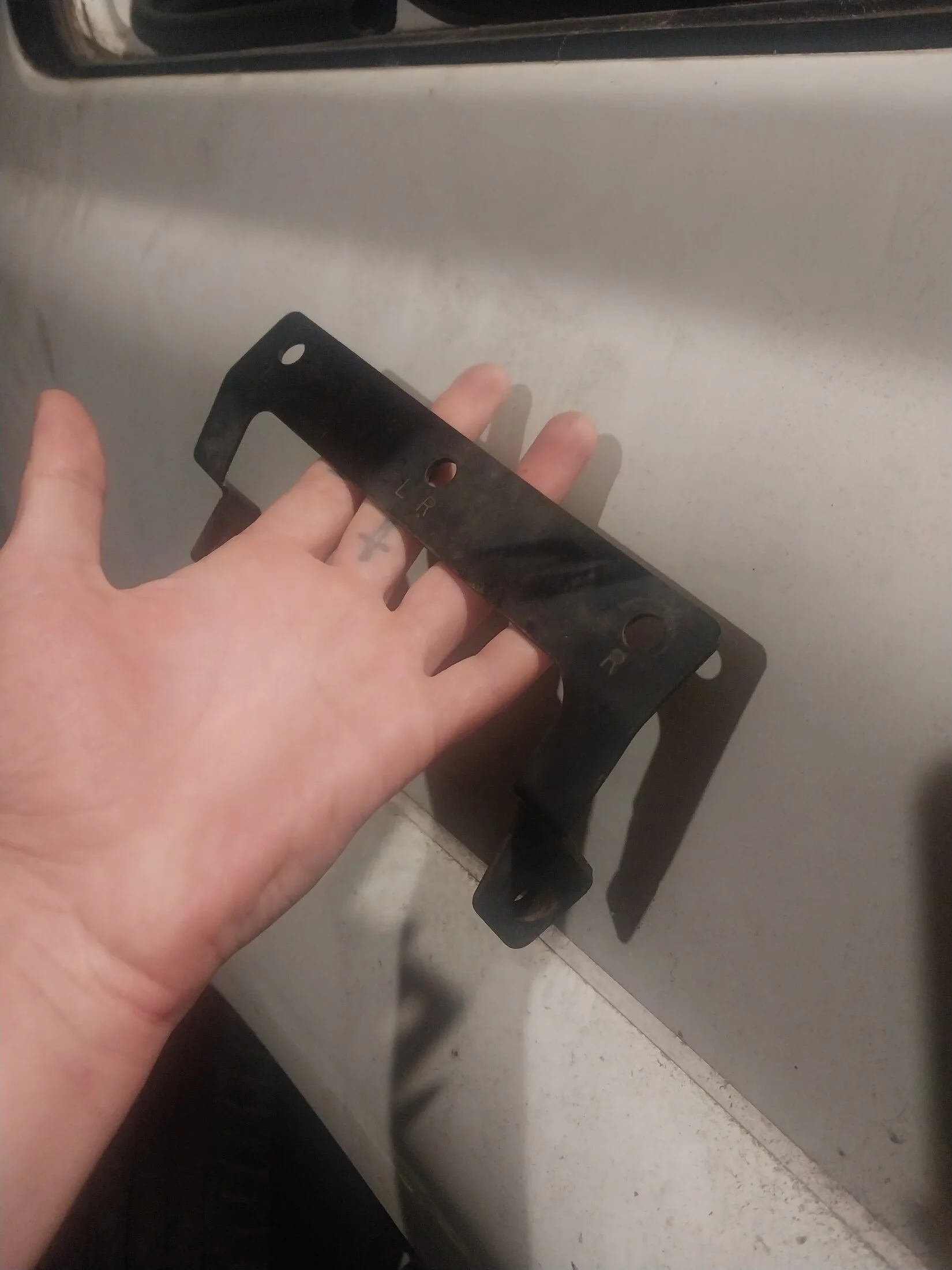

Pretty sure I still have a mounting bracket I don't need, happy to sell. Will post pics in here for reference for future searches. Owned the car for a good year trying to figure out what it was for, wasn't until I removed the fridge from another 80 I recognised it.

Fridge bracket. Wouldn't be impossible to fab something up.
