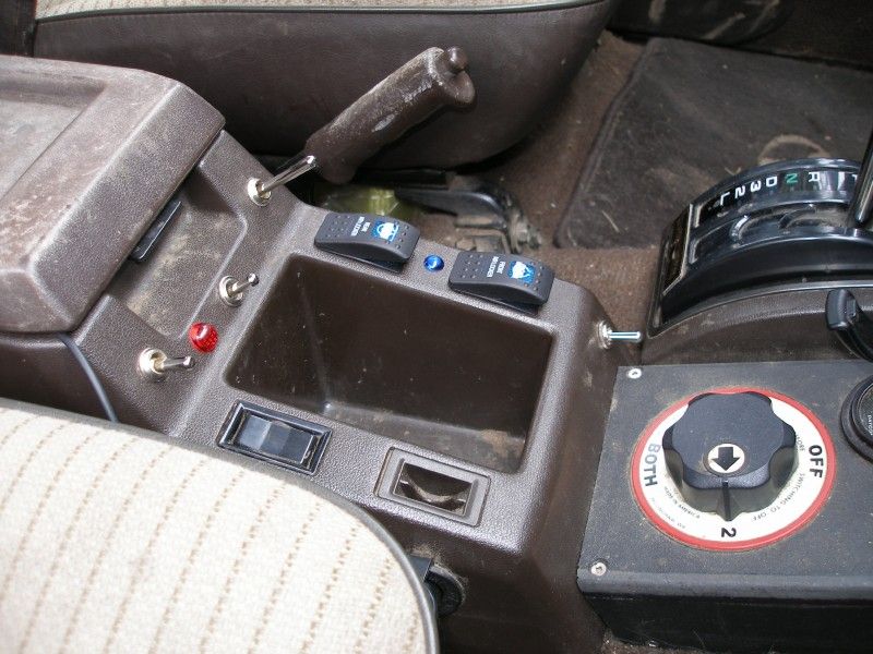

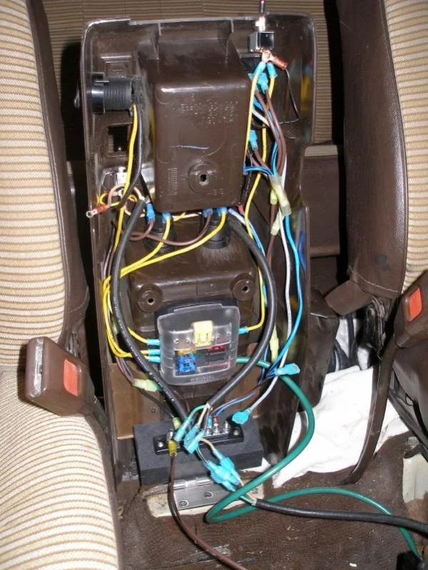

A couple of things to consider in the design stage.
I put a 62 console in my BJ and instead of screwing it down permenently I mounted it on a hinge to access the fuse panel and wires that are under it.
Provide a location to mount switches and electrical crud. Currently I have winch controls, air locker controls and light switches all in my console. Plus 3 12V outlets (GPS, Ipod, etc).

Dude, nice battery switch! Is that for your acc's in the console, or for engine starting/winch?
That switch controls the batteries under the hood. When I moved everything to my BJ I moved that switch under the hood. Its just a blue seas switch available from a marine supply.
