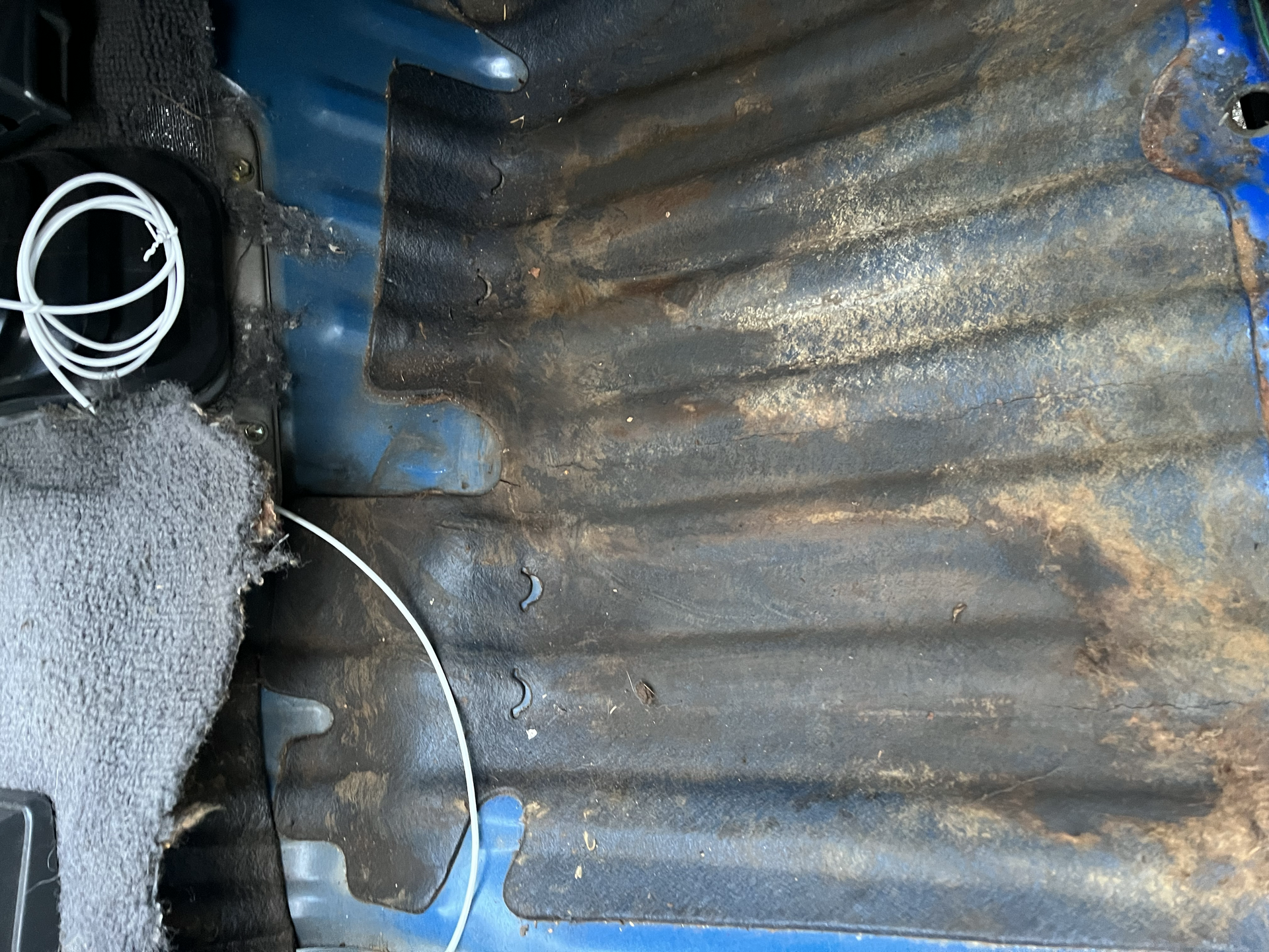

You have bigger problems with interior floor rust, I think you should take this as an opportunity to address that, it looks pretty bad.
OK - thanks for the comments. I just tore out the carpets, will hose it down this weekend and give it a clean. Agree this is the time to clean out that rust, treat it, re-paint, etc. I will also check the other items - wheel bearings, knuckle grease, diff fluids, etc. The dark color on front floorboards (aside from the rust) is just the carpet liner stuck to the floor - which I will remove as well obviously.
That black stuff is sound deadening from the factory. You can freeze it with dry ice and it will chip off, but good luck removing it any other way.
OK your floor doesn't look too bad otherwise. I think what happens is that people get in in winter with snow/slush/salt on their boots. This melts and collects in those low areas by the door. It might evaporate away but the salt is left behind and from humidity in the air it will just rust that area away over time. Was the flood all fresh water, no salt water? If so it did you a favour and washed the salt out for you.

No salt water but probably a mix of oils / sewage / other flood. Will wash out accordingly. The floor boards (even where the rush shows) still feel very solid.
