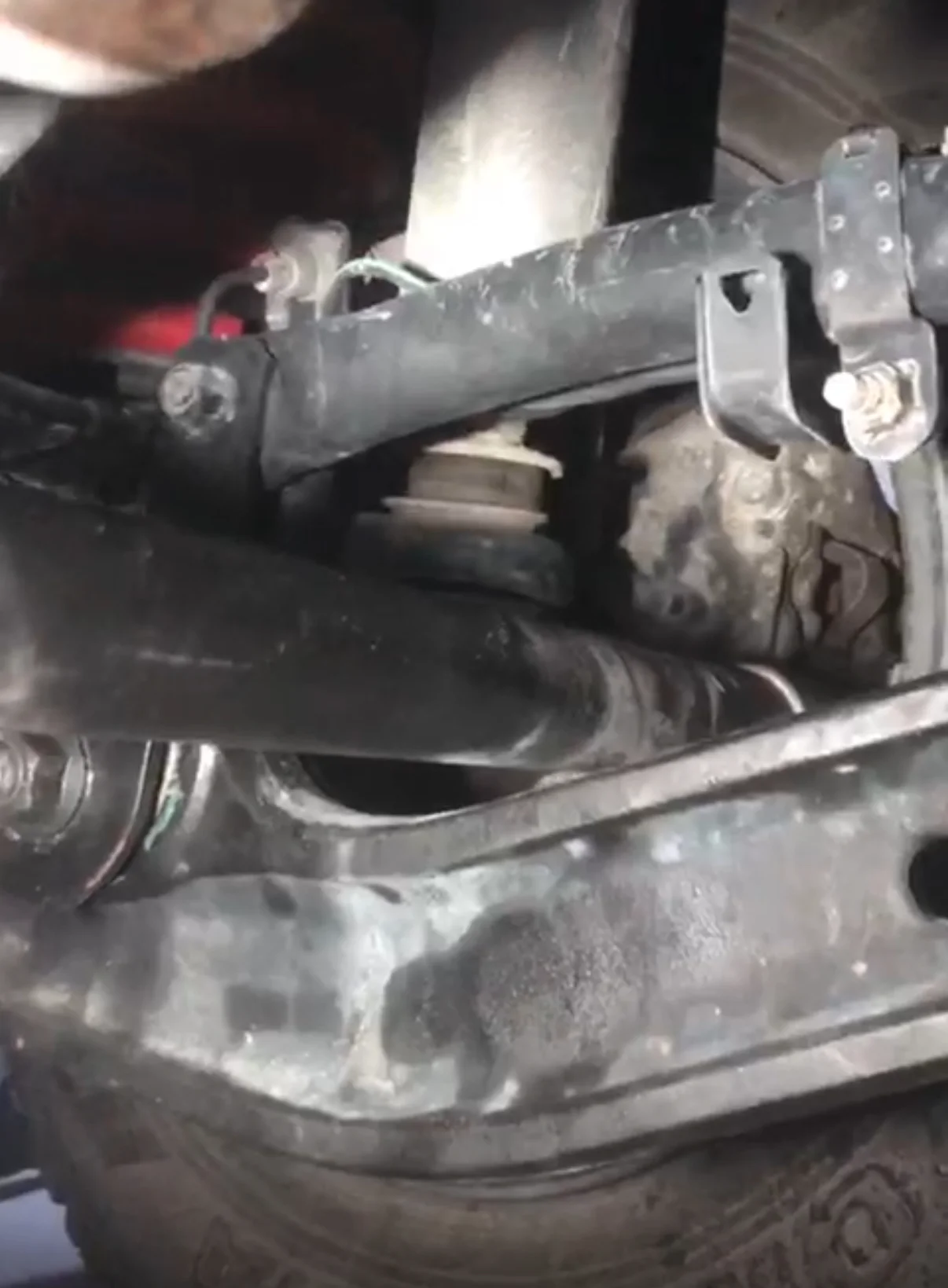

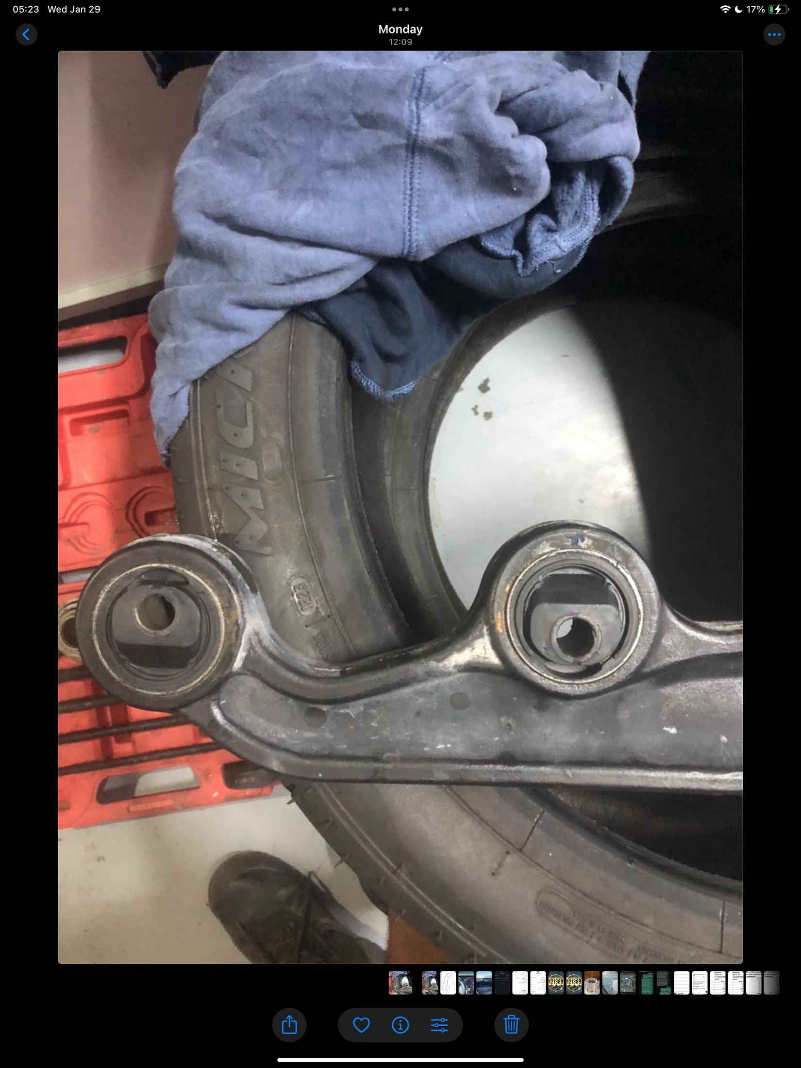

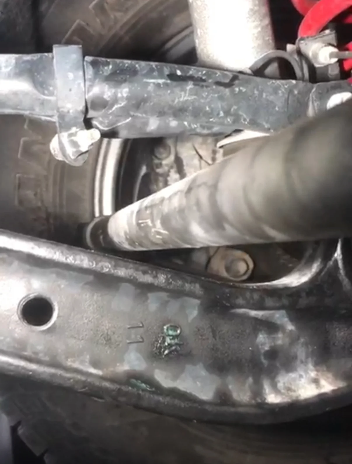

I recently installed caster correction bushings on my vehicle, which has a 2-inch lift, and I’m noticing that the RHS drag link is now touching the radius arm. Both sides’ bushings were installed in the same orientation, so I’m struggling to figure out why this is happening.
Has anyone else dealt with this issue before? Could this be a sign of an underlying problem, or is it related to the suspension geometry with the lift? Any advice or troubleshooting tips would be greatly appreciated. Pictures are attached for reference.

This is very common in the 80 series world and most move away from caster bushings.
Some have ( including me ) ground off the casting marks on the arms in the affected area. Just be careful not to take too much.
It’s 100% due to the bushings moving the axle making the tie rod closer to the arms.
You could also try just removing the rear bushings and run the OEM bushings. It would probably be enough for you 2” lift.
I didn't even think about keeping the original bushing in the rear, that's a great idea. Thanks I'll try it!
