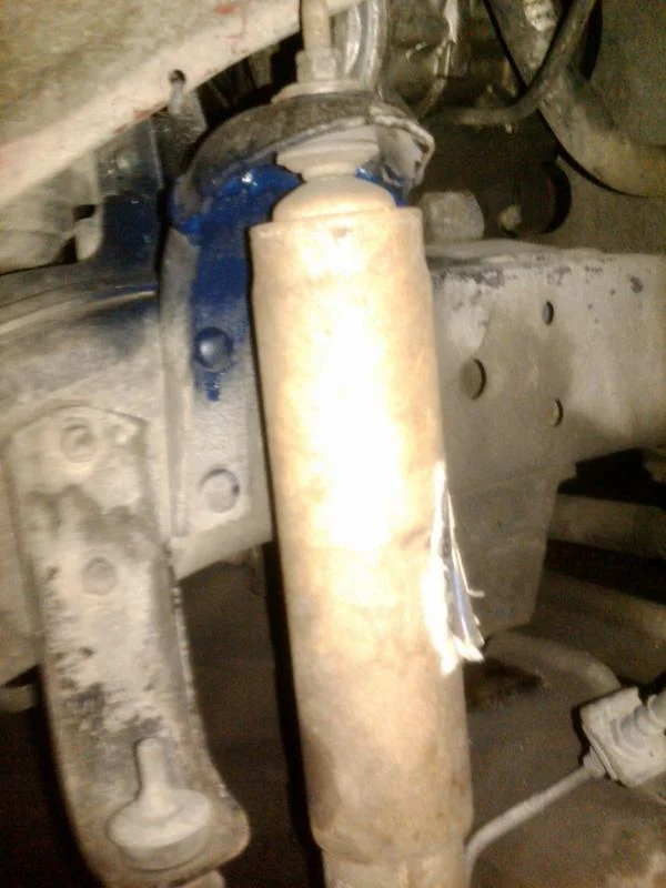

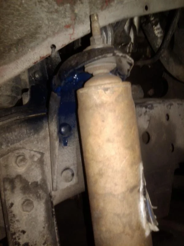

Shocks don't carry weight. Check the truck ride height next time you swap shocks. You'll see there is no change with or without shocks.
You may have the wrong length shocks on your rig. They may be acting as bump stops and would cause the problem you are seeing.

My Passenger side did that when I was running OME shocks with stock springs. Got it welded back together and it has held up fine. Twenty bucks.

uh... yeah... thats how I found out that the shock tower was broken. While I was changing the tire.
I think I get it welded to start.... Any good welder in LA area?
NocalFJ60, you got a picture of your mount?
Cruiserdrew & D'animal, are they held by rivets, or nuts & bolts?

I've just mounted the ford towers, they work great, and let me tell you, you'll never break em. They are super beefy, and have just enough angle to them to keep the shock well out of they way.
94[?] f250 4x4, $30 a piece. I drilled and tapped into the frame, then welded them on. The shock pin bolt holes were a little tight, but a 1/2 inch bit in a drill loosened them up. The old ones didn't want to come off the rivets, so they are a little beat up, but could easily be welded back on - all yours if you want em.

GAS - A - LOT came by this morning (cold - early - ice on the cruiser early!) I got the tower all welded up and sent him on his way. It was a strange break I don't know how it broke where it did. It's a mystery to me.
