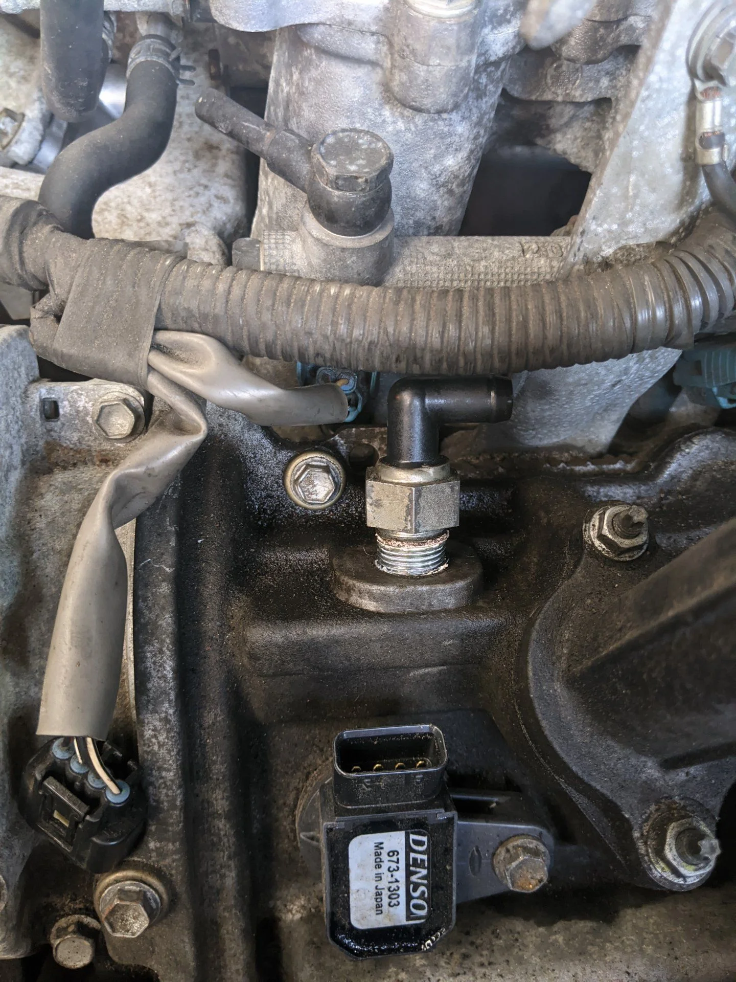

Mine is definitely threaded. I'm hoping there is no grommet on the inside. I let the truck warm up for five minutes hoping the threads on the aluminum valve cover would warm up quicker than the threaded body of the PCV valve. I was able to break it free with a 12" adjustable wrench.
there’s no grommet on that model, looked like mine
Thanks. I figured the grommets are for the push to insert style PCV valves.

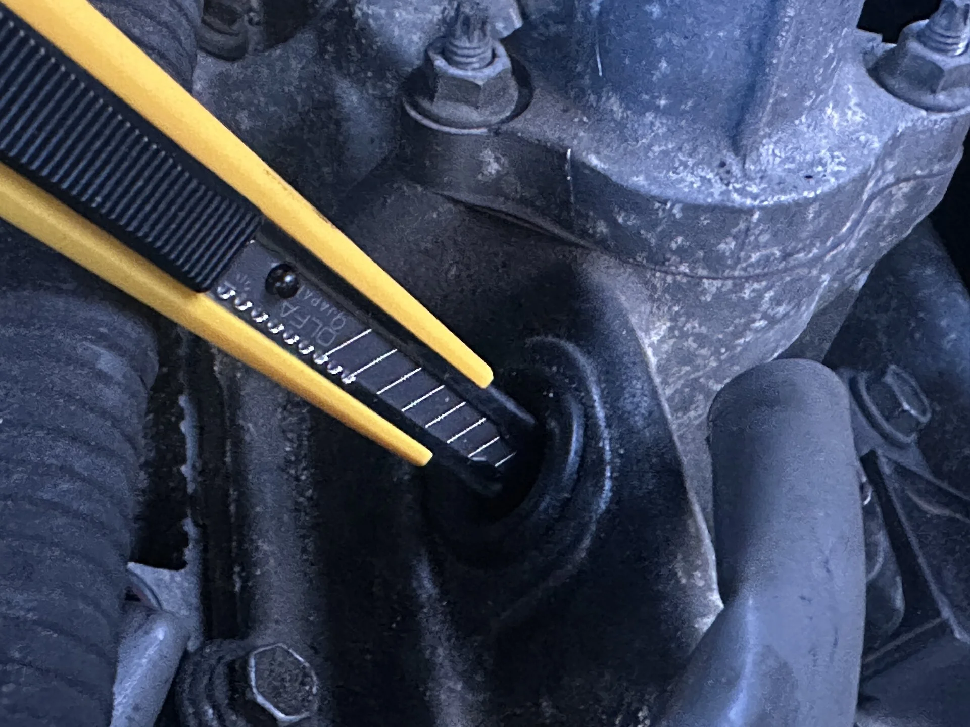

Man, this stupid grommet. I thought I had a good idea to try and take a skinny knife to make a vertical slice and then try to fold the whole thing in on itself, but that sure didn't work! hahaha
Ended up just being careful and after ripping off some of the top, was able fish some needle nose down the length of it and slowly pulled it out. I think I got like 95% of the crumbled parts out? :)
Failed slice
So so brittle:

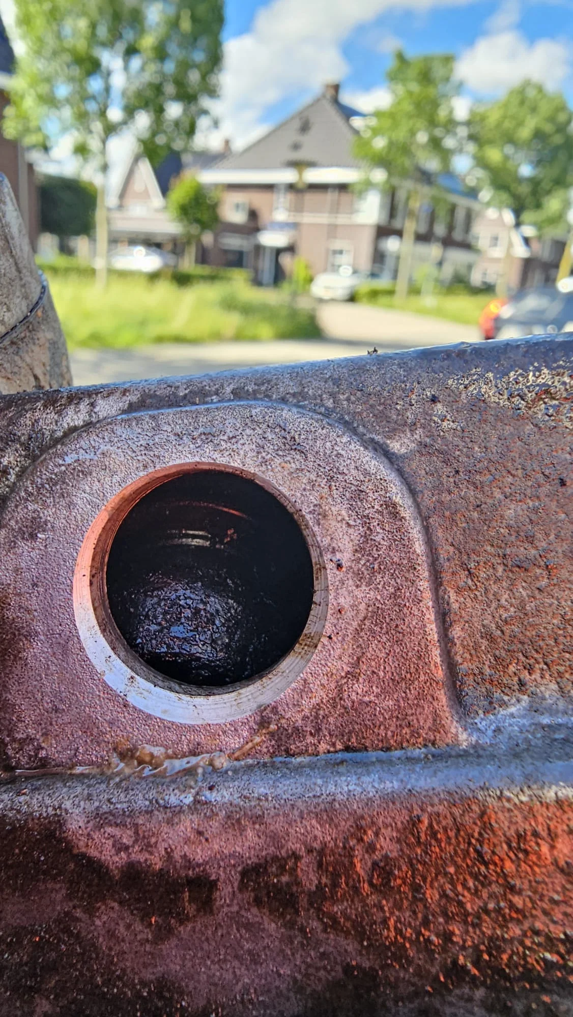

Ughhhh. I botched this job completely now. Had the engine cover and took it for a nice drive to warm up the grommet. Judging by the debris 'blast' ring around the valve it was definitely losing vacuum and due for a replacement. The valve itself popped out super easy with slightest of tug and the grommet seemed quite soft malleable. Then for some stupid reason i rushed the job - thinking it was going to be easy to get it out - the whole damn thing slipped into the valve cover !!! FM. Now i cant see it at all, put my finger in and cant feel it at all, took the engine oil filler neck off but its compartmentalized to the PCV so really no access.
Whats the vote ?? What would u do? Can i leave it in there or should i open the valve cover to get it out? (and risk more snapped off vc bolts like i had 3 brake off on the passenger side a month ago) .
I'd try to extract it if possibe......Can you shine a light in there and see anything? Maybe a vacuum with a skinny tube adapter to the end? Maybe one of these little grabby tools if you have enough space...maybe a stick with a piece of bubble gum on the end =]
Soak the VC bolts and pull the VC (sooner or later). I waited to do my PCV grommet until I pulled the VCs, but I live in a dry climate and the VCs came off without broken bolts. I feel for you - hang in there! You might look for a pix of the underside of the VC so you can see if your lost grommet will stay put for now. If so, you can wait to pull the VC until convenient.
With flashlight you see.
You can also use a borescope.
If you decide to do the valve cover gasket, make sure you do the spark plug tube seals with OEM. I had nothing but problems with aftermarket tube seals used by the previous owner. Since replacing with OEM tube seals, it's been no issues.
Good luck getting that thing out. Give us an update how it went. If you simply cannot find it or feel it, like someone else already said, I'd try a vacuum.

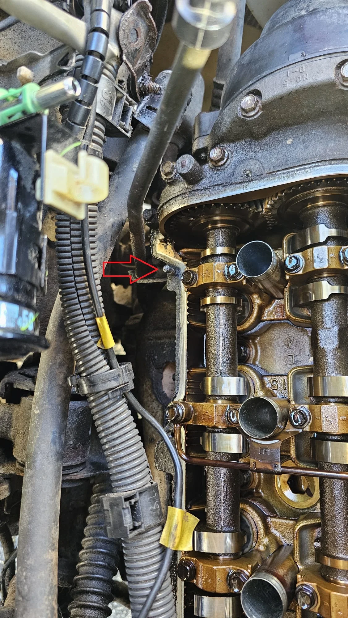

One week later and i want to give update on my pcv valve replacement job. The good news is that i got the valve cover off and i got the whole grommet out in 3 pieces.
The even better news is that i 'only' snapped of 1 of the 9 vc bolts this time (vs 3/9 when i did passenger side few months ago). Im so happy because its not the dreaded one near the firewall on bottom row - and the head of the bolt snapped off so there's still hope to get it out with a vise grip - but drilling should be quite doable:
