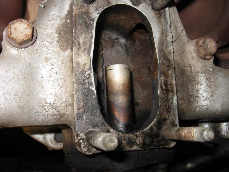

This is your manifold on crack:
attachment.php
attachment.php
Looking down thru throat of intake manifold. That crack is extreme. Even if you have a hairline crack, you should get it welded at a good machine shop, or replace with good used one.
