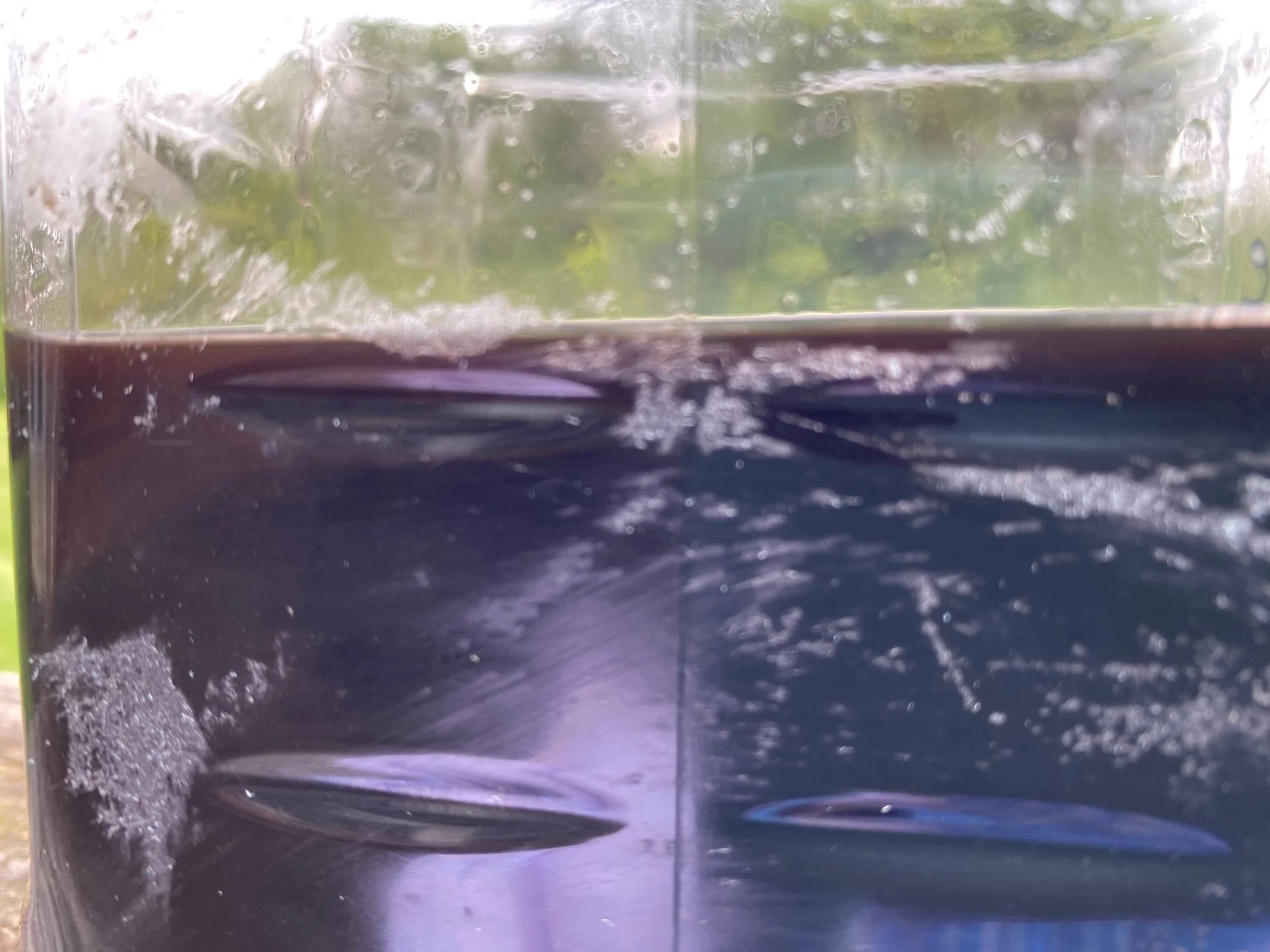

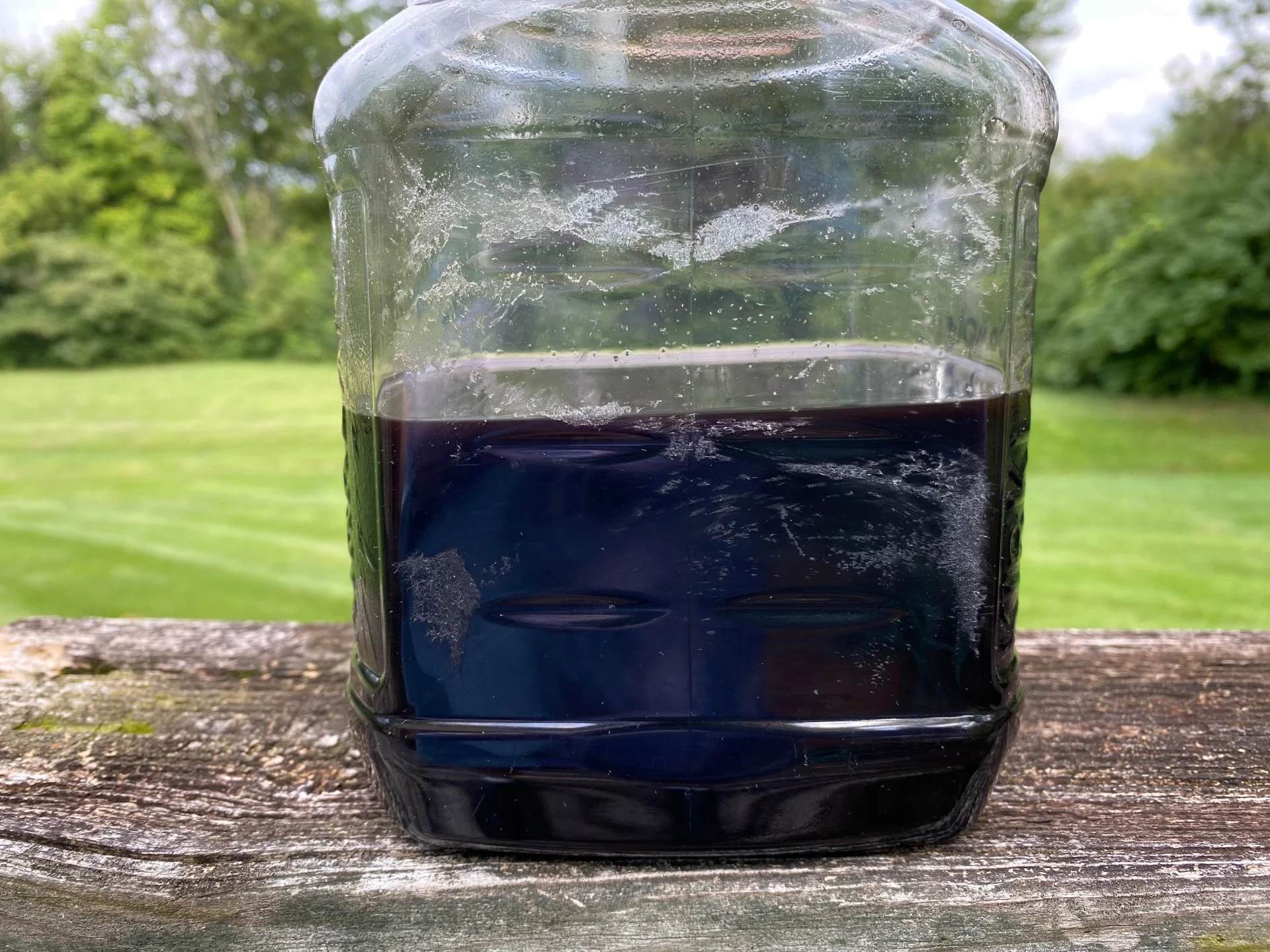

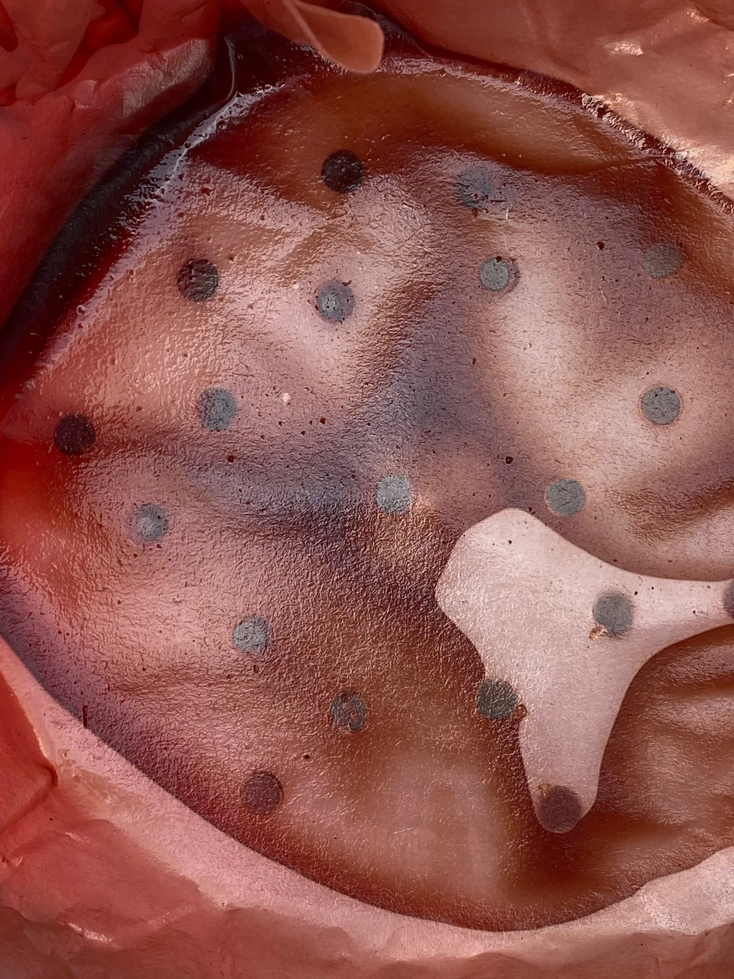

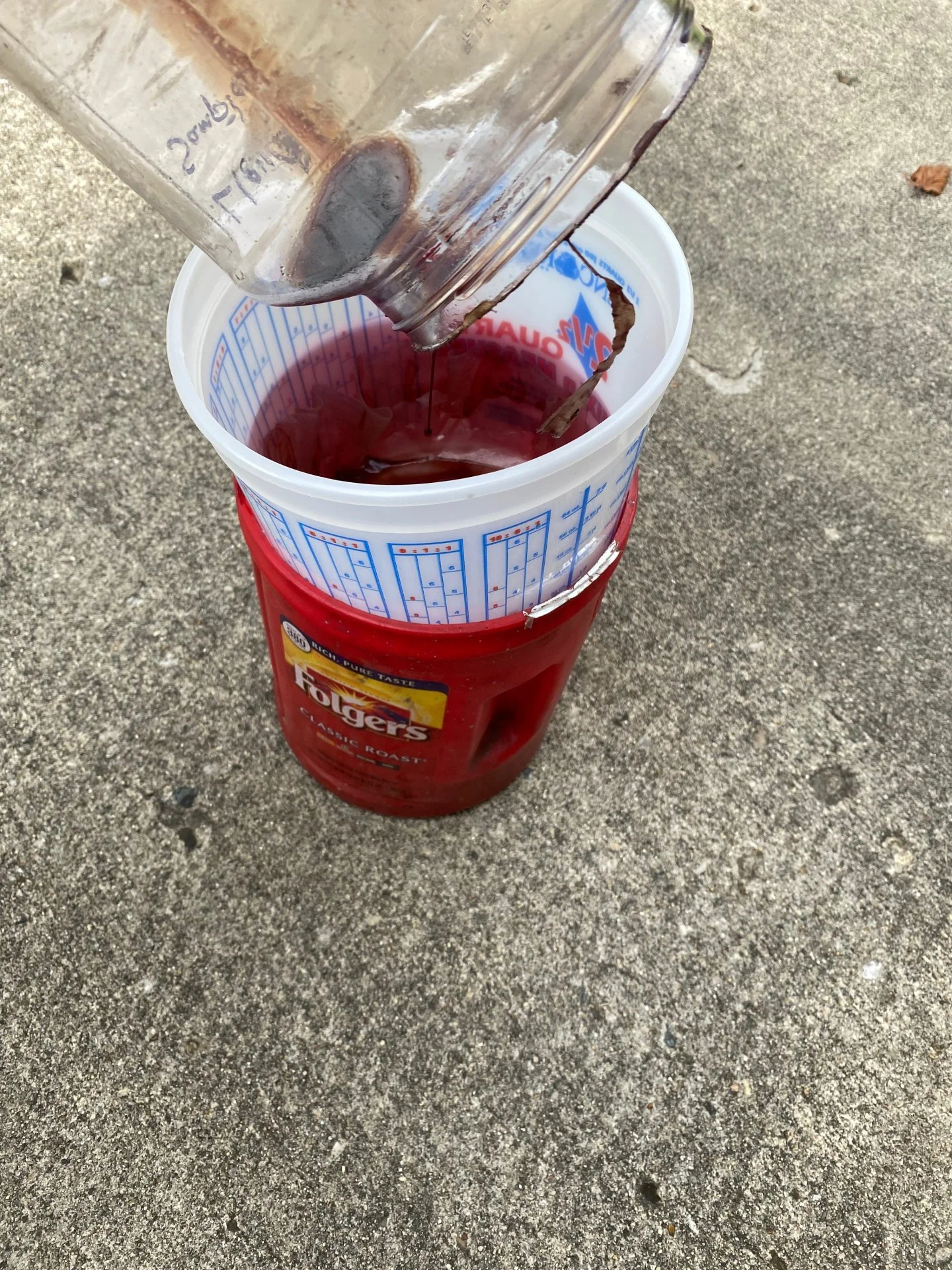

I strained the original never before changed ATF and found hardly any debris or sediment. I don't have the experience to draw conclusions, but it seems to me that with so little debris, there may be some justification to have "lifetime ATF" in vehicles that do NOT tow or do heavy off-roading.

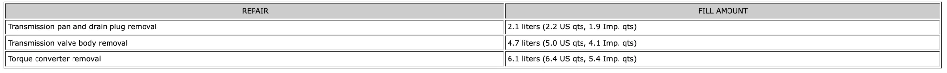

8 spd:

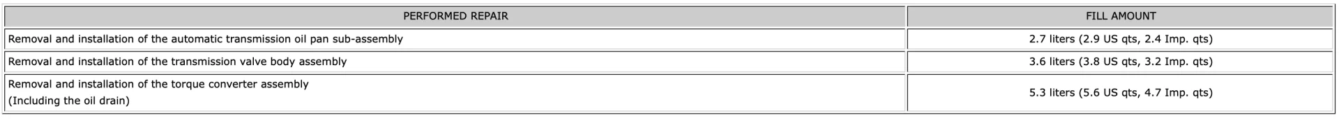

6spd:
