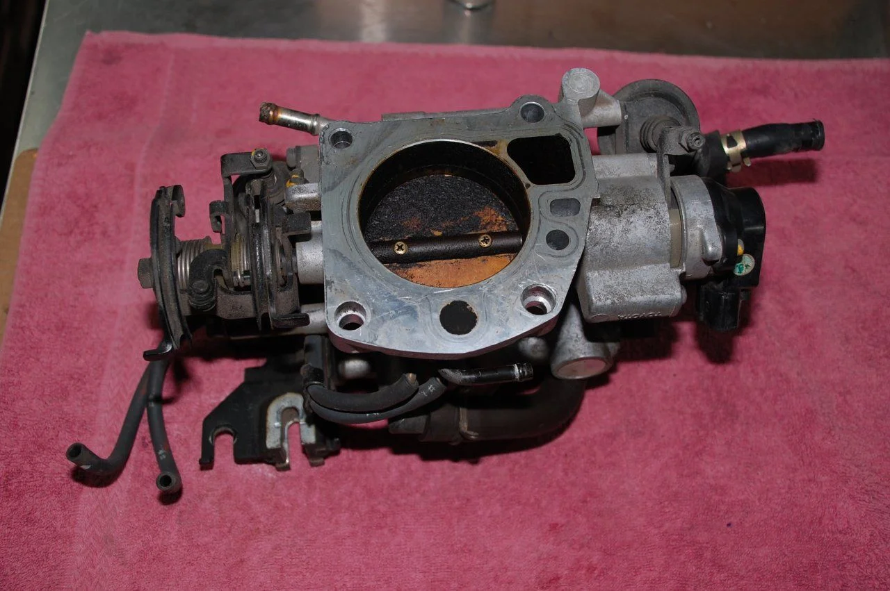

Yup. Just did this last weekend. If I recall correctly, you undo one front coolant line, 3 electrical connectors and a couple vacuum plugs. Then undo the 4 bolts and the thing moves over.
Take good close up pictures from above before you remove any cables, if you decide to remove them.
The nice part about removing them is that you can get your T-body on a bench and give it a good cleaning while you have it out.
Unless yours happens to be clean for some strange reason... Mine was't.
Oh yeah, and here's a tip that might save you time. Before you yank the rear coolant hose out of the engine, remember how it is threaded towards the bottom. I had to fish mine down about 4 times because I forgot to take notice how it was positioned in regards to the fuel rail and other wires and hoses.
