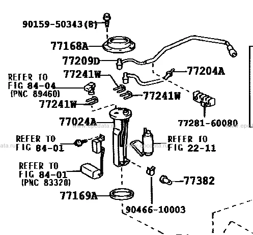

Can anyone point me to the power wire that sits inside the gas tank and powers the fuel pump for a 2003 LX470?

It's inside 77024A and it connects here.
I had a fuel pump failure in southern utah and had to splice in a NAPA fuel pump to get me home on a long road trip. I'm going to install OEM now that I'm home but I can't find this dang wire.
Thank you!
I replaced mine and I recall the assembly came with one. I think 99-02 oem didn’t have it and 03-05 did, or visa versa
Tmoneyallday, I am trying to replace my fuel pump & it had previously been replaced with a generic pump with a non OEM plug. I am trying to track down the proper wire as well does part# 77024A come with the wire?
I never found the part so I just bought an entire assembly from the junkyard and put a new fuel pump in it.
