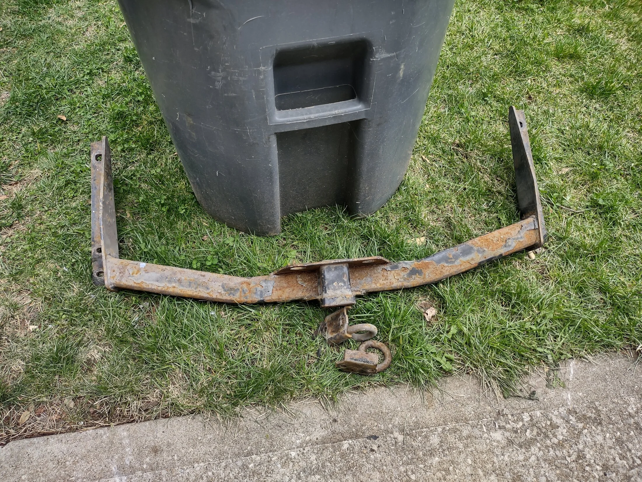

The 1994 FZJ80 trucks had a hitch added at the port in the USA. Those hitches bolted to the frame rails and have a 2" receiver.
They look like the following picture:
