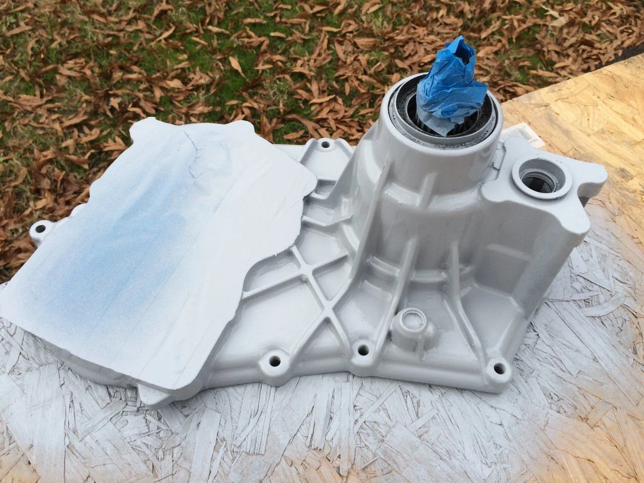

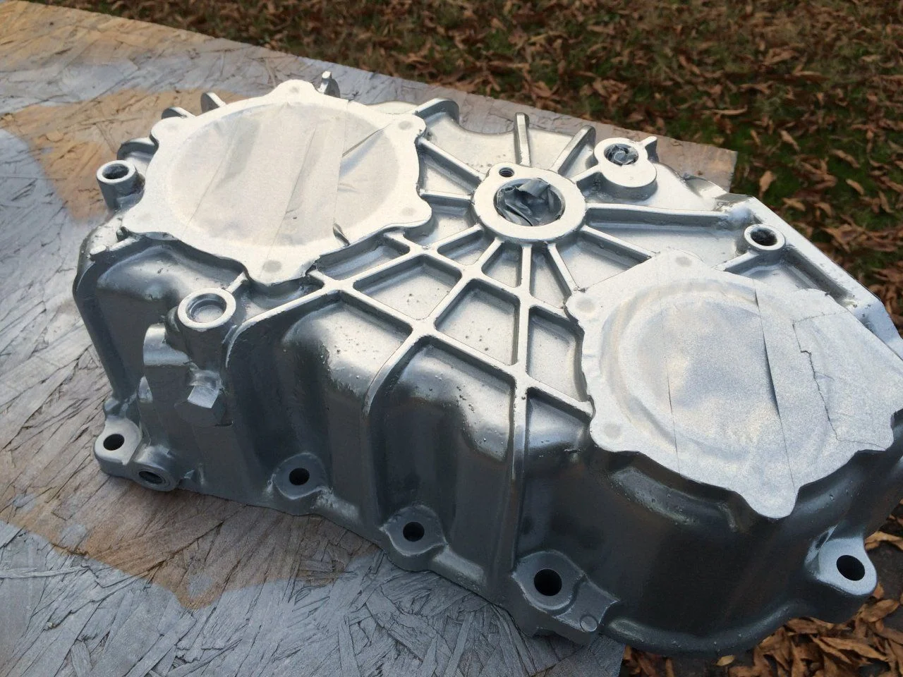

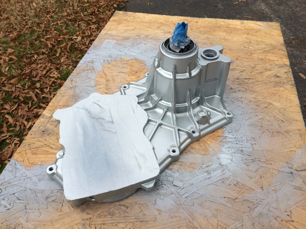

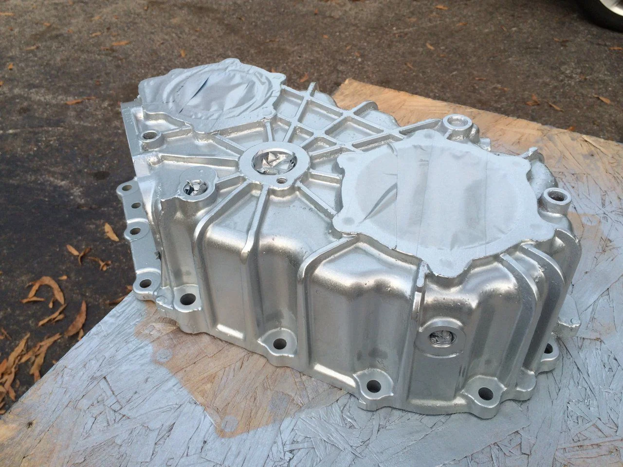

First case half disassembled, cleaned and powder coated. Rustoleum-ed.
Original Toyota final color. I'll clear coat it too so it should be easy to keep clean-ish.

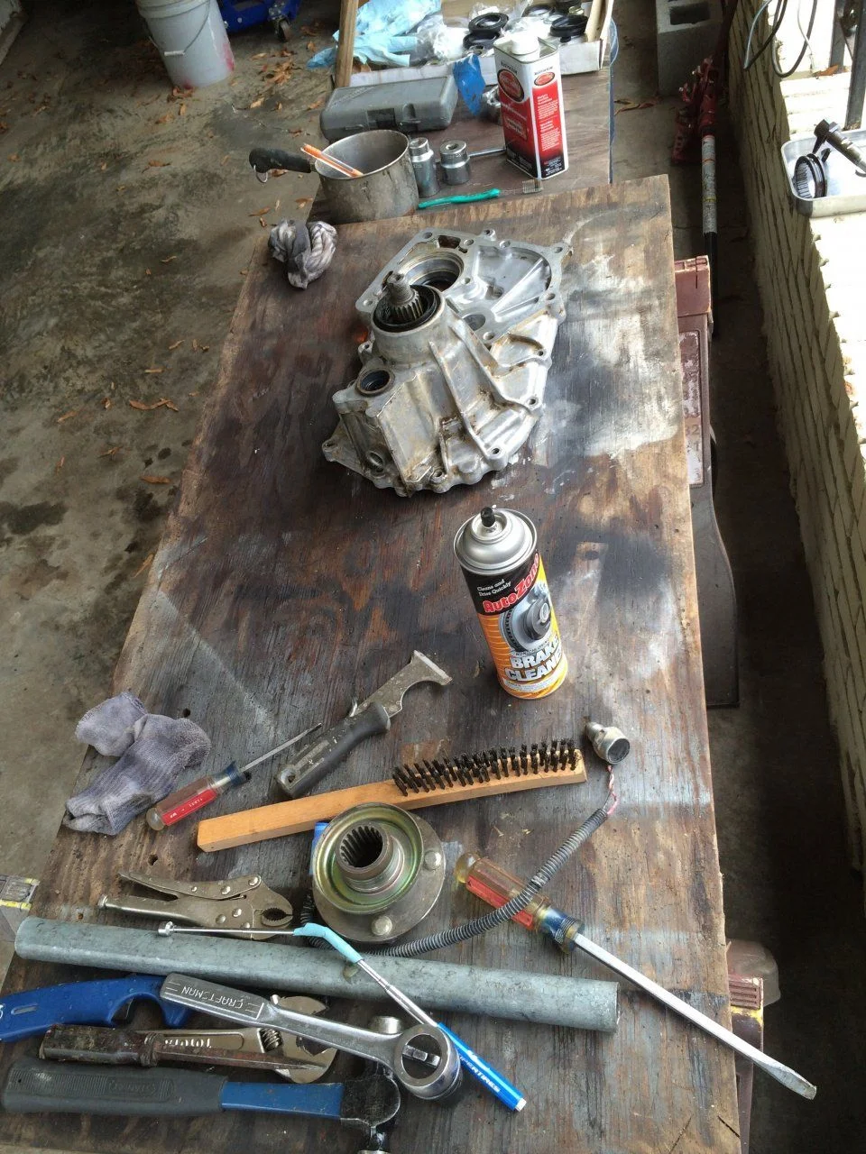

The back half was nasty. I won't show the "clean" pic. I may have had to paint over a little grime. There's lots of nooks and crannies to clean.

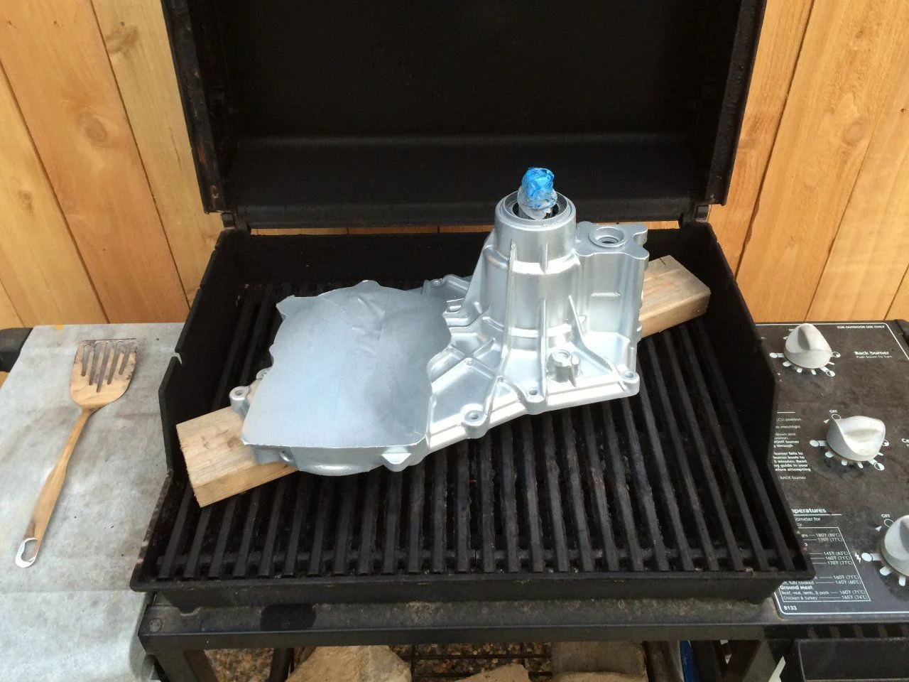

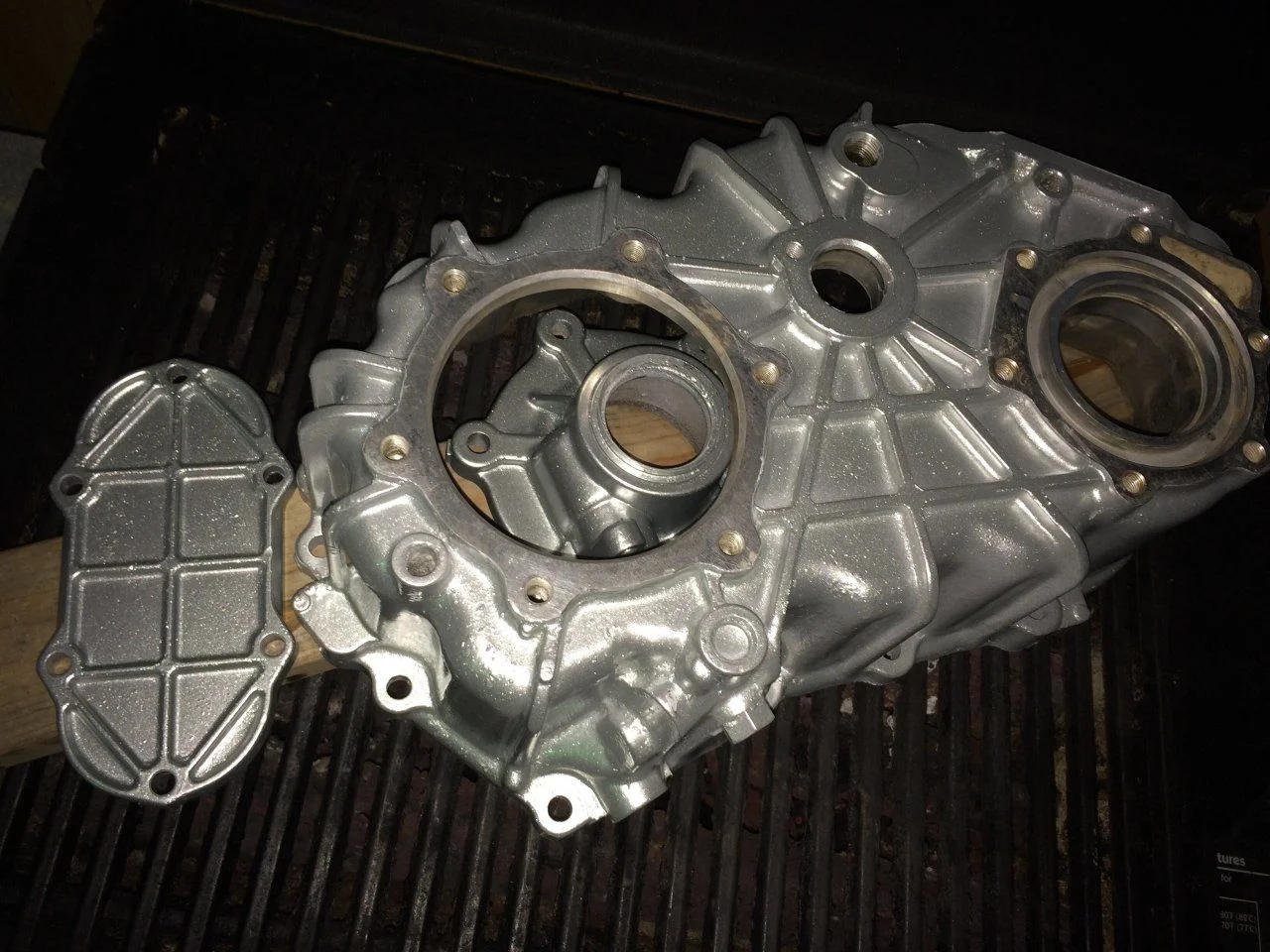

Oven cured...
Last batch of clear coat in the cure oven. The clear really melts down smooth as glass after an oven cure.
Should be hanging off the transmission tomorrow.

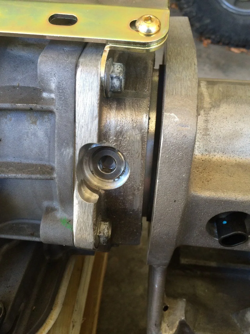

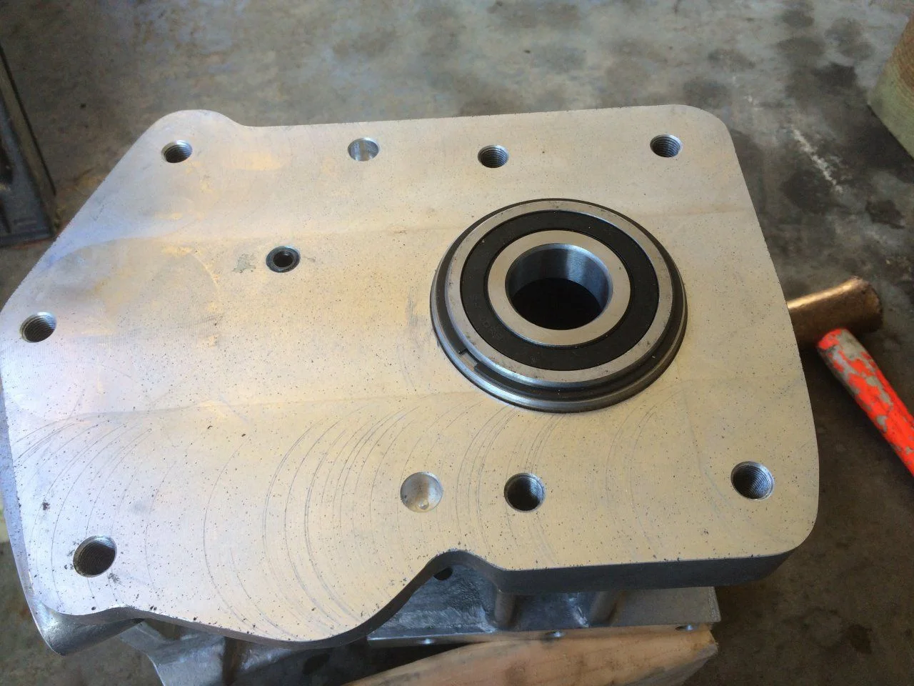

I installed the proper Lokar bracket. Then drove in the bearing and spud shaft into the adapter. I test fit the adapter to the transmission and it bottomed out on the trans output shaft before the adapter seated.
It looked like I might need to trim the output shaft a little, even though it was cut to AA specs.
A quick Georgle confirmed that I wasn't overlooking anything, but I decided to assemble the t-case on the adapter and install on the transmission as a complete unit later (Georgle method of assembly). If all went well I would cut the output shaft down last since that is non-reversible.
After painting the case half & adapter with my new Permatex 3, it was installed and torqued to spec. We (my niqqa Rob came over to help) then started putting in all the gears and idlers and bits and pieces.

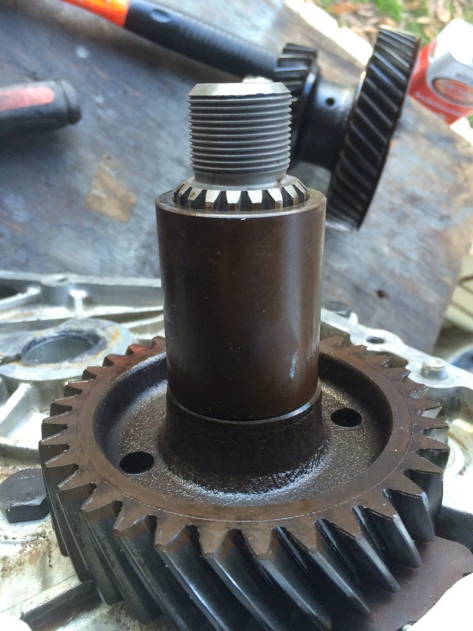

When we got close to the end, we realized the spud shaft wasn't long enough to hold the gear, spacer and bearing.
Turns out is short by about the same amount that the adapter wouldn't reach the transmission by.
Looks like it wasn't machined right. It was probably supposed to be turned down to this groove.
So, no pics of the blingin' t-case installed. I'll call AA and get this fixed. I'm glad I didn't cut the output shaft though.

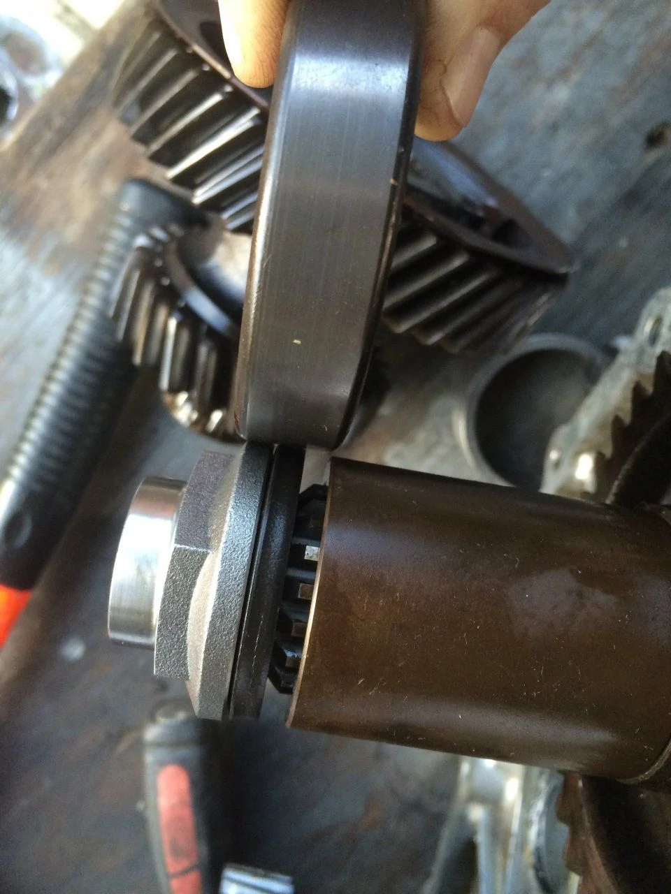

So it turns out that I am not good at reading directions or AA's drawings.
I installed the bearing in the adapter based on other build threads I've seen and the instructions on AA's website, which is now out of date. They have since changed the design of the adapter kit ever so slightly. The bearing (pictured below) should be flipped 180° and should have been pressed into the t-case instead of the adapter.
:oops: :grinpimp:
image-jpg.1007915
