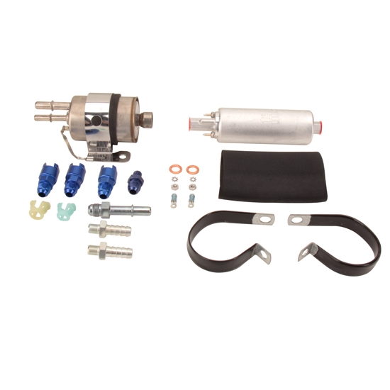

After a lot of overthinking (because I don't know anything about AN fittings), I ordered most of what I'll need to fab up my fuel delivery and power steering. I'm still a ways off from needing this, but I don't want to have to figure it out and order when I get to it.
After trying to fit together bits and pieces and looking for the lowest price, I ended up getting this kit... http://www.speedwaymotors.com/LS1-Fuel-Filter-Regulator-Pump-Kit,103299.html
Post-build edit. Don't buy the kit, source the pieces separately. The filter/pressure regulator is an off-brand, hecho in China, and mine failed. Luckily it happened a few miles after returning home from a 5000 mile trip so I wasn't stranded. Be sure to buy a genuine Wix 33737 filter/regulator and carry a spare. Filter failure will appear as a pump failure.
I ran the TBI version of this (Walbro) pump on the 2F TBI system to replace the pump supplied by AFI. The (lack of) noise was remarkable compared to the kit pump. It was virtually silent. I'm hoping that's the case here.

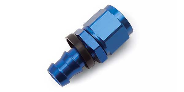

That got me everything I need except the hose and fittings between the pump & filter/pressure regulator, and between the filter/PR and the fuel rail. For those I got (4) of these Russell push lock fittings and some hose...
Amazon.com: Russell 624010 Twist-Lok Red/Blue Anodized Aluminum -4AN Straight Hose End: Automotive
Amazon.com: Russell 634153 Black 15' -6AN Twist-Lok Hose: Automotive

Correct me if I'm wrong, but I believe I can put together the rest of my hoses (power steering return and transmission cooler) with off the shelf hose & hose clamps since they are low pressure.
Cool, good to hear it is quiet as well.
Amazon (prime) has 'em for $83 right now:grinpimp:
I went to the trouble of making a list of all the little part numbers and trying to shop around, but still couldn't get it any cheaper than the kit. Plus, this way they'll all be in the same box for safekeeping.
I should be a Russell AN fitting salesman now. I know all the numbers by heart.
Yes the low pressure side of the p/s system can run conventional clamps and hose, since you are in a low pressure environment. Just make sure the hose is good for the fluid type to be used. Same with the transmission hose.
I tried a different hose (do-it-yourself) type setup on the pressure side of the p/s system..never got it to seal correctly. Resorted to the old school setup with having local hydraulic shop make up some hose with fittings for me. The have the fittings that you crimp with the machine that puts out some crazy pressure...but that seems to be what it takes to get the fittings to seal on the high pressure p/s hose side.

If you have a choice, I'd go with some crimped high pressure hoses. The kind you're using are great for trail repair, but I don't use them since I had a hose connector fail on the trail once. All my high pressure hoses are crimped.
Well dang. I guess I'll make one for now and then get somebody to copy it with crimped fittings later on.
Make the hose you need so you know the length and orientation of the fittings. Take the hose(s) to an auto parts or anyone else that can make hydraulic hoses and have them made. Should not be too expensive. Keep the original hose you made for a spare.
