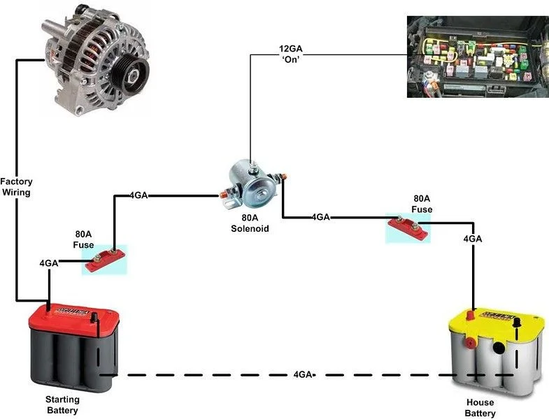

3) Dual battery - the tried and true staple of overlanding and 12V fridge owners. Dual redundant solutions with house load on one battery and recreation load on the other. You always have a backup. This is the most expensive solution (possibly). Source a 91/92 battery box, buy a battery, and buy the components for a dual battery setup along with relocation brackets for wiper fluid. Scoring a 91/92 for cheap is possible. Interstate blims or a battery from Costco are very affordable. Wiring through fleabay. I could make this work. When the fridge drains the second battery, no problem. Start the truck and charge it back up again. I would feel safest with this solution. Best part, it doesn't take up interior space.
So I will be assembling a dual battery solution on the cheap instead. Later down the road, a small 30 watt solar panel might go on the roof rack to help slow the drain of the second battery.
BTW, if I had an RV or camper with a flat top, I would cover the top in solar panels. The panels would act as a barrier to heat and provide electricity.
This is how I am doing my dual battery on the cheap...I stole this from someone else's write up, but I confirmed with the guys at ACC and they said this is the way they recommend doing it now, no complicated sensors or displays....K.I.S.S.
I got this 200A solenoid for $43-ish
Amazon.com: PAC PAC-200 200-Amp Relay Battery Isolator: PAC: Car Electronics
And these ANL fuse blocks with 100A fuses (sold in pairs for $14)
Amazon.com: InstallGear 0/2/4 Gauge Ga ANL Fuse Holder + 100 Amp ANL Fuses (2 Pack): Car Electronics
So other than the 4ga wire, you have a kit for about $60. The only "downside" is you still have to wire a winch directly to primary battery to keep it from overloading the solenoid in the second battery loop. But you can wire all the other accessories to the secondary.
