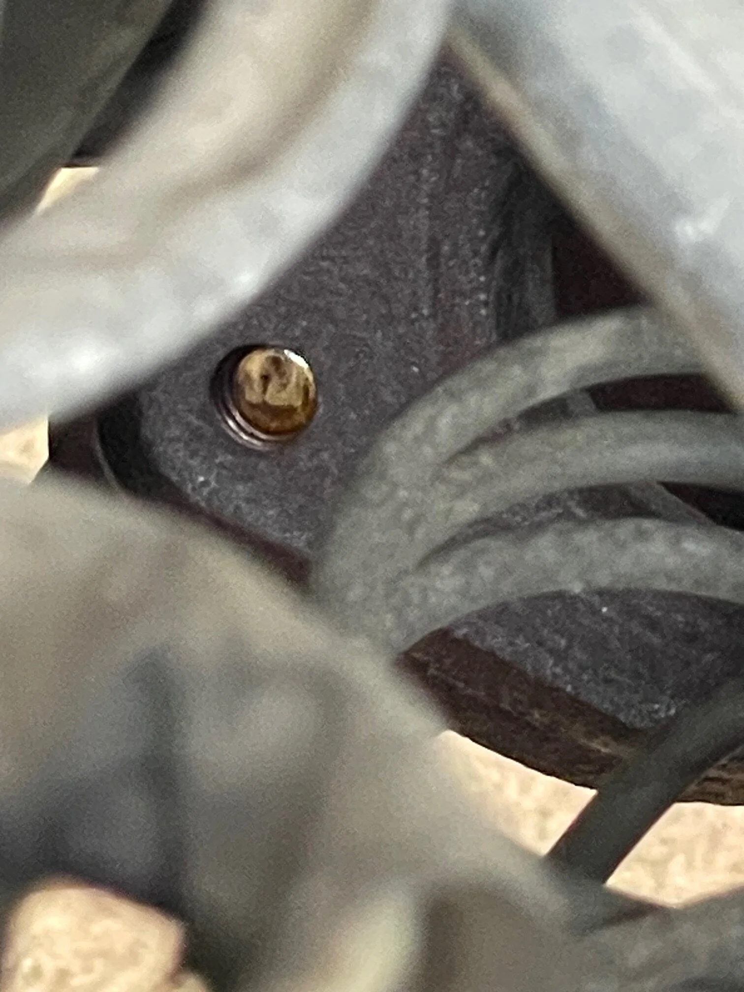

I am going through a similar situation, but.. I found an exhaust leak where the passenger CAT pipe attaches to the header downpipe. I am going to try to tackle this in the driveway with ramps (and the AHC full up). The exhaust on my 06 is very solid. What do I need to disconnect to replace the gasket in that connection (also purchased new bolts (look like studs to me)), though the ones in there look really good. Hit it with some PB and letting it sit.
Can I just unbolt that flange (3 bolts) and slip the new seal in there or do I need to disconnect other bits of the exhaust to give me enough play? When under there I can't move the exhaust system what-so-ever. - thanks in advance.

You can slip in a new gasket. But you'll not be able to clean the mating (each flange) surfaces effectively, for the gasket to seal/set properly.
The exhaust manifold to cat flange. Has 3 studs in exhaust manifold. I wire brush threads of studs form below, as clean as I can get them. Then add penetrating oil. I do this, days in advance if I can and keep re adding P oil. I do the same for rear cat to Y pipes 2 nuts and bolts. I do the same, for sensors.
When ready to remove cat for exhaust manifold. I unplug the o2 sensor. I use long 1/2 drive impact extension, 14mm impact socket and impact wrench. This is when the prep of thread cleaning and P. oil, pays-off. Hopefully, the 3 nuts come off, without damaging the manifold studs. If studs damaged, often they can still be used. By chasing the threads. If not, good luck getting old studs out.
If the two rear Y pipe nuts, are to far gone for removal. I get out the angle grinder. I do not reuse any bolts or nuts. So makes no difference if these two bolts cut off. Just takes more time and tools.

This is a one owner and I don't believe we have ever had the exhaust worked on. These studs look really good. I haven't crawled under the 02 to compare. But I'm getting pretty nervous about buggering the manifold studs. Southern its whole life.
Those studs look good. But still I'd clean and P. oil. They almost always remain in the exhaust flange, as nuts comes off.
So a new Cat to Y pipe seal is also in order? Or just drop, clean up the downpipe and cat upper flanges, install new seal there, bolt back up and just use new bolts in the Y pipe attachment using the old seal. Stealership didn't have the seal so that is on order.
Thanks.
Yes! The gaskets (seals) at each end of cat, must be replace, if removed. Which they must be removed to clean up.
