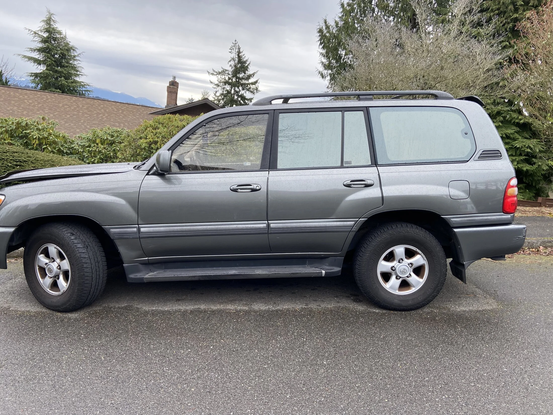

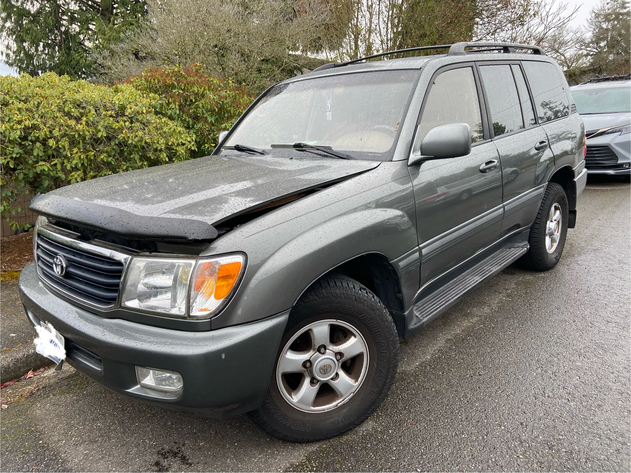

So… lotsa pics for the ‘Mud hive mind to feast upon. I’ve only had a half hour with it but here are first impressions:
Body looks straight, there are a handful of bruises and scrapes.

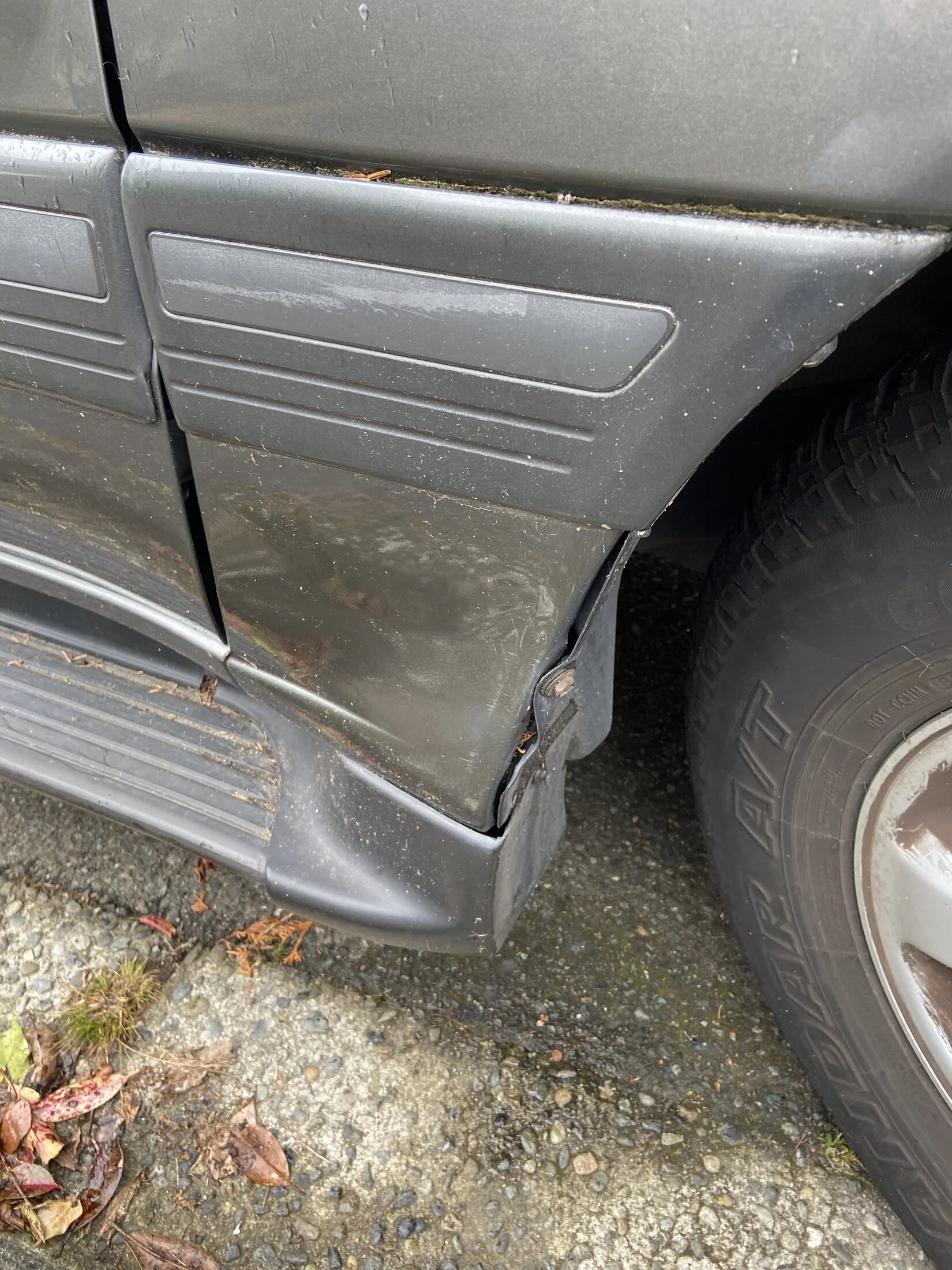

On both sides, the sheet metal between the door and front wheel well looks dented, or is that just a really convoluted stamping?

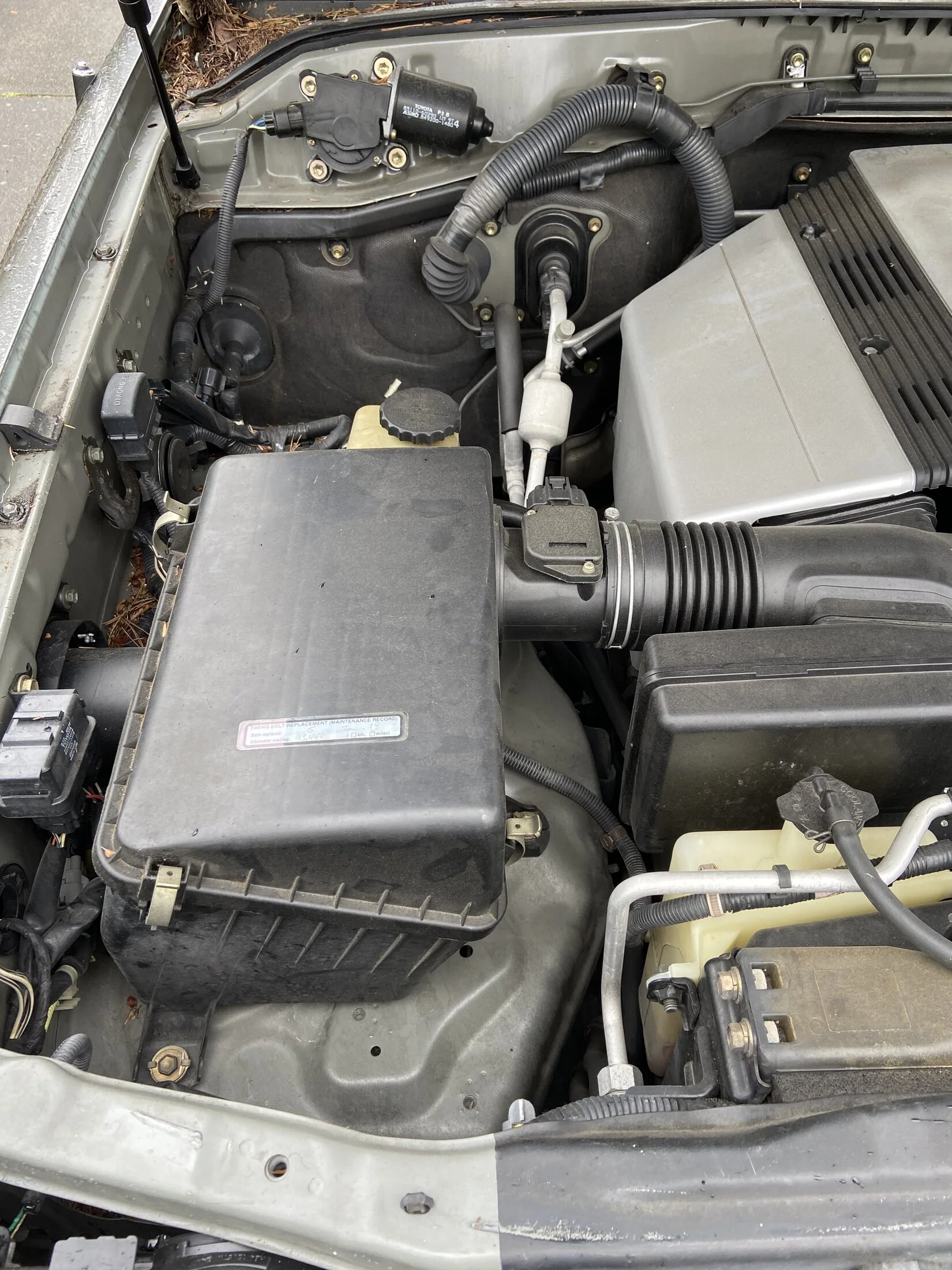

Engine bay does not appear to be a horror show. Gotta get under of course, plus determine if there have been critters nesting in all those pine needles.
TB and WP were done 15 years / 50k miles ago at the local Toyota dealership, it comes with the accompanying invoices for that and much more. 80-90% of the care was at the dealership since the current owner bought it there in 2003.

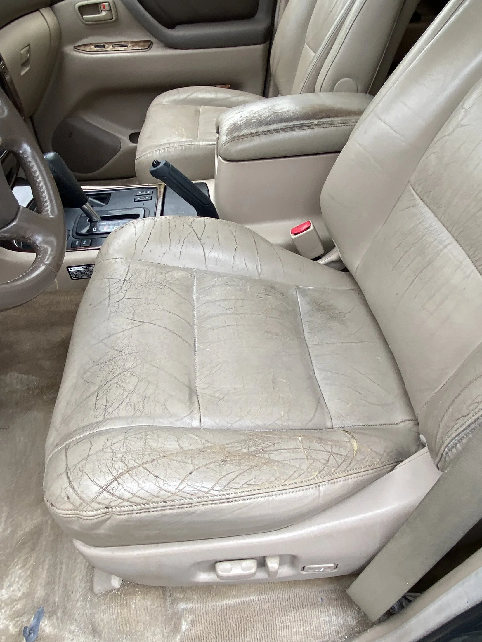

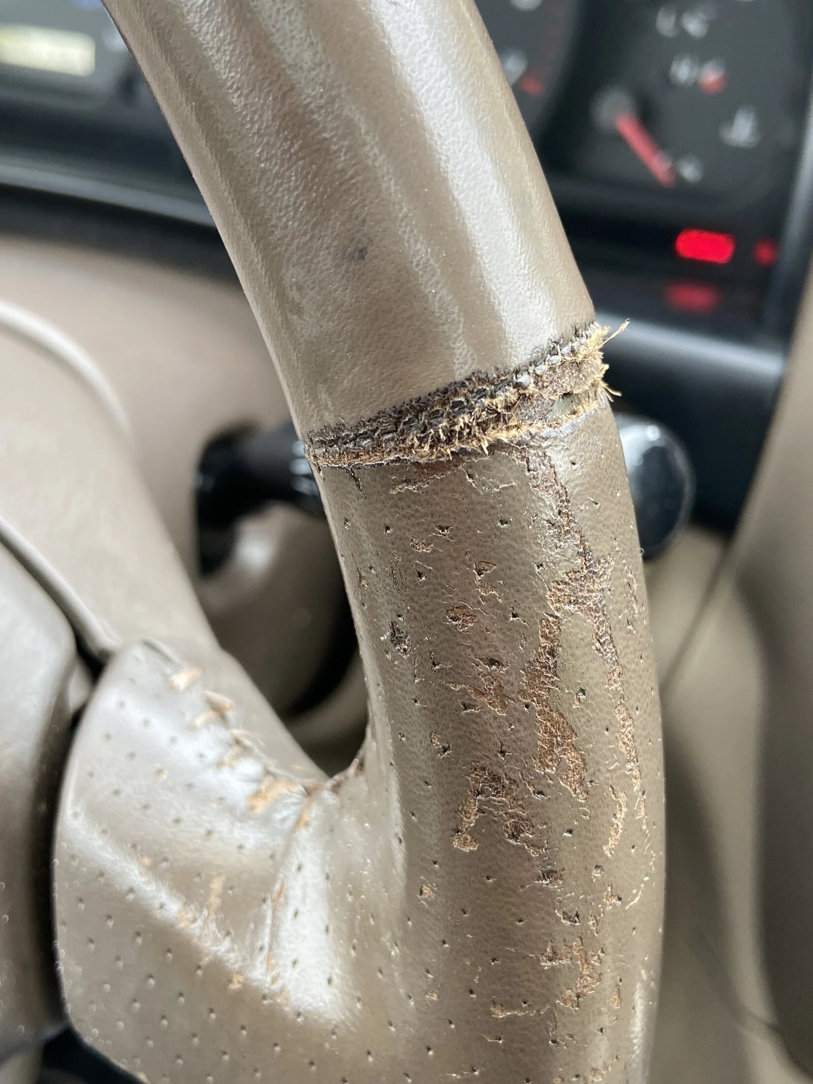

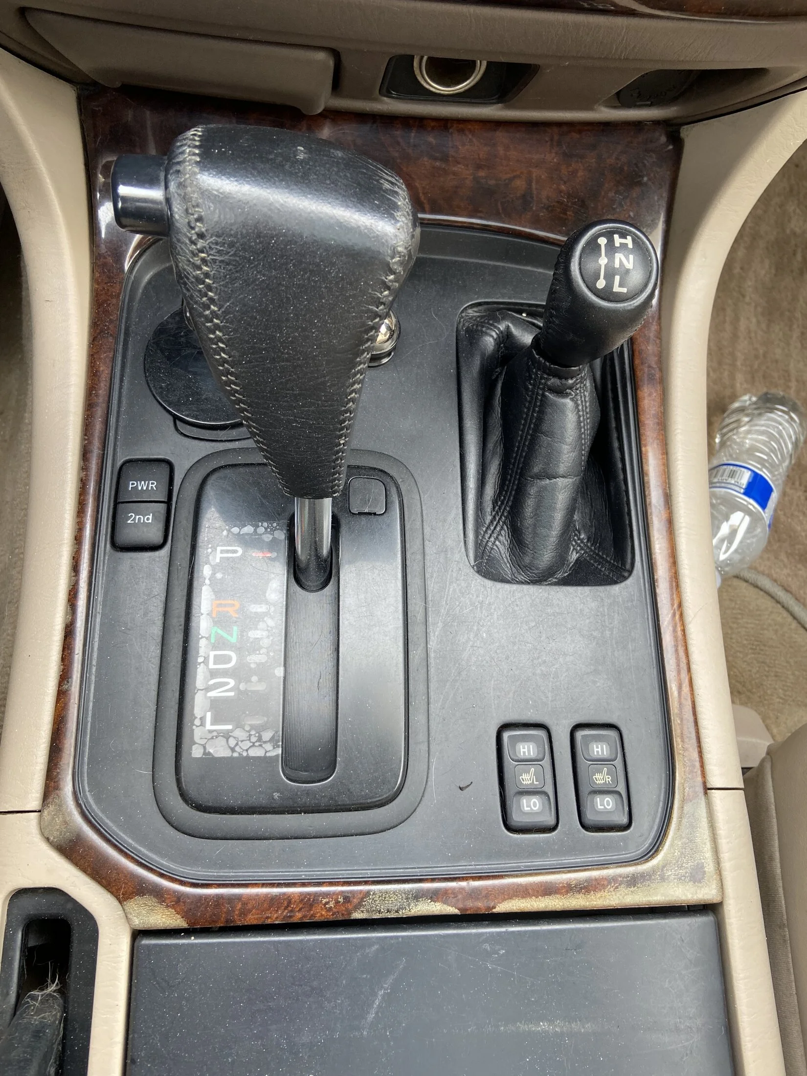

Interior has the expected wear areas, I’m showing the worst of it. The rear is much more lightly worn. It was primarily used as an adult driven, single driver vehicle. No evidence of kid or cargo hauling.
