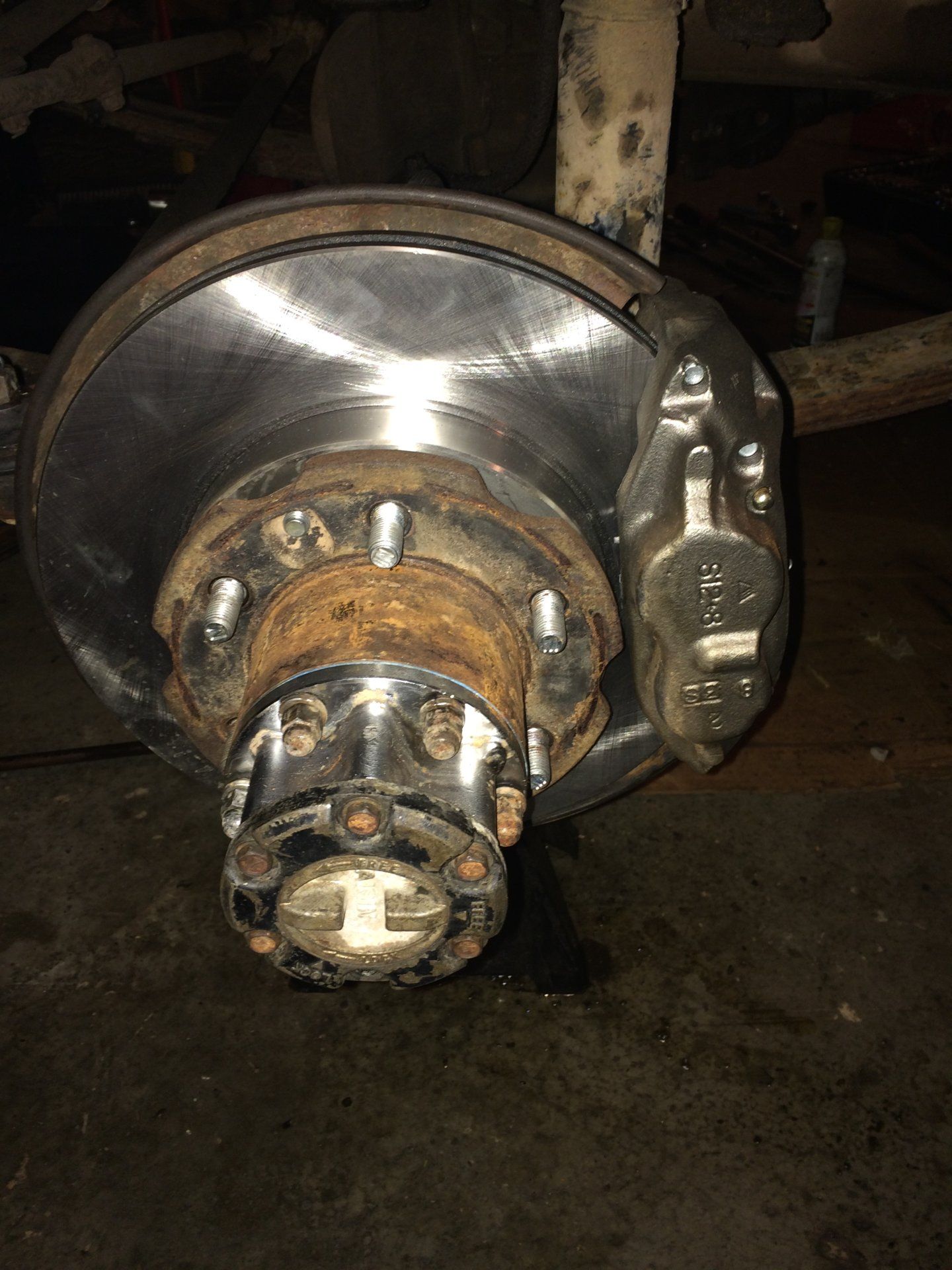

Ongoing baselining includes birf inspection and repacking of the drivers side. New rotors, calipers, and pads after the wheel studs are pressed in. I tried the lug nut method but couldn't get the studs in all the way. Took them to a shop with a press.
All buttoned up and waiting on the rotor. Brake line was in good shape but in my rush to tear everything apart, I cut it and thought I could just put a new soft line in. WRONG! Everything is seized up and the nuts came pre-rounded. Time to utilize specialty parts for the hard line.

The counter top is getting more room. Front axle service, kept the bearings and races. New rotors, pads, soft and hard brake lines. The mity-vac is not set up to do as much pumping as was required to fit both front rotors. The pin in the handle kept popping out and shooting across the floor. Thank goodness I was trying to keep the area relatively clean or it would have blended into the mess.
