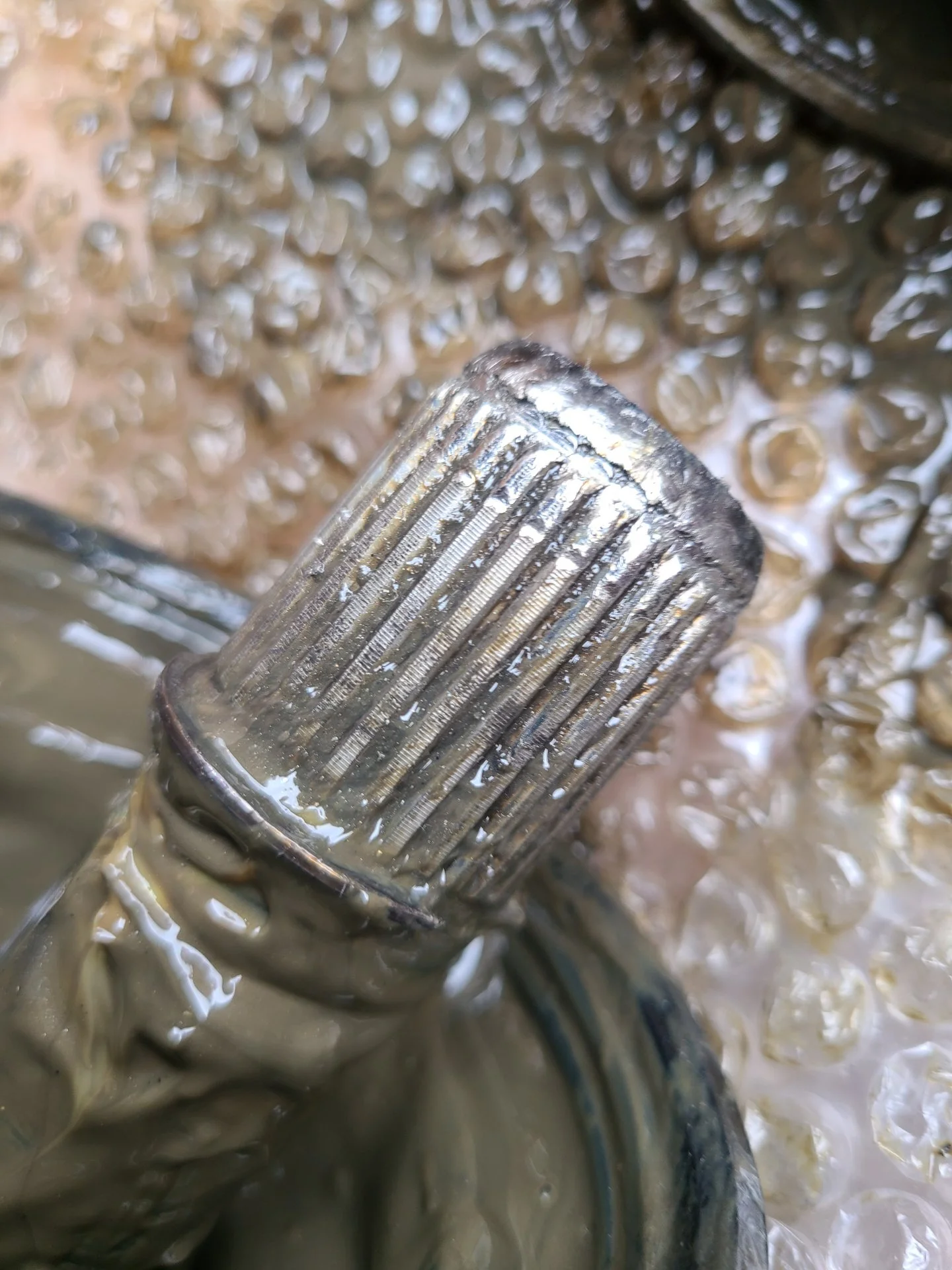

Puller er out and it looks like the splines are busted. I think there is supposed to be a c-clip at the end of the shaft's well that isn't there. I re-booted these a few years ago. I'm pretty sure i includes all the clips. Either way, cruiser outfitters has a whole new unit on the way!

B. Dead CV. Buy a new assembly. OEM is best, but expensive.
Nice picture. Looks like the clip failed/fell off and then the splines pulled out a little and then sheared right off. Was that an OEM CV? New clips used?
