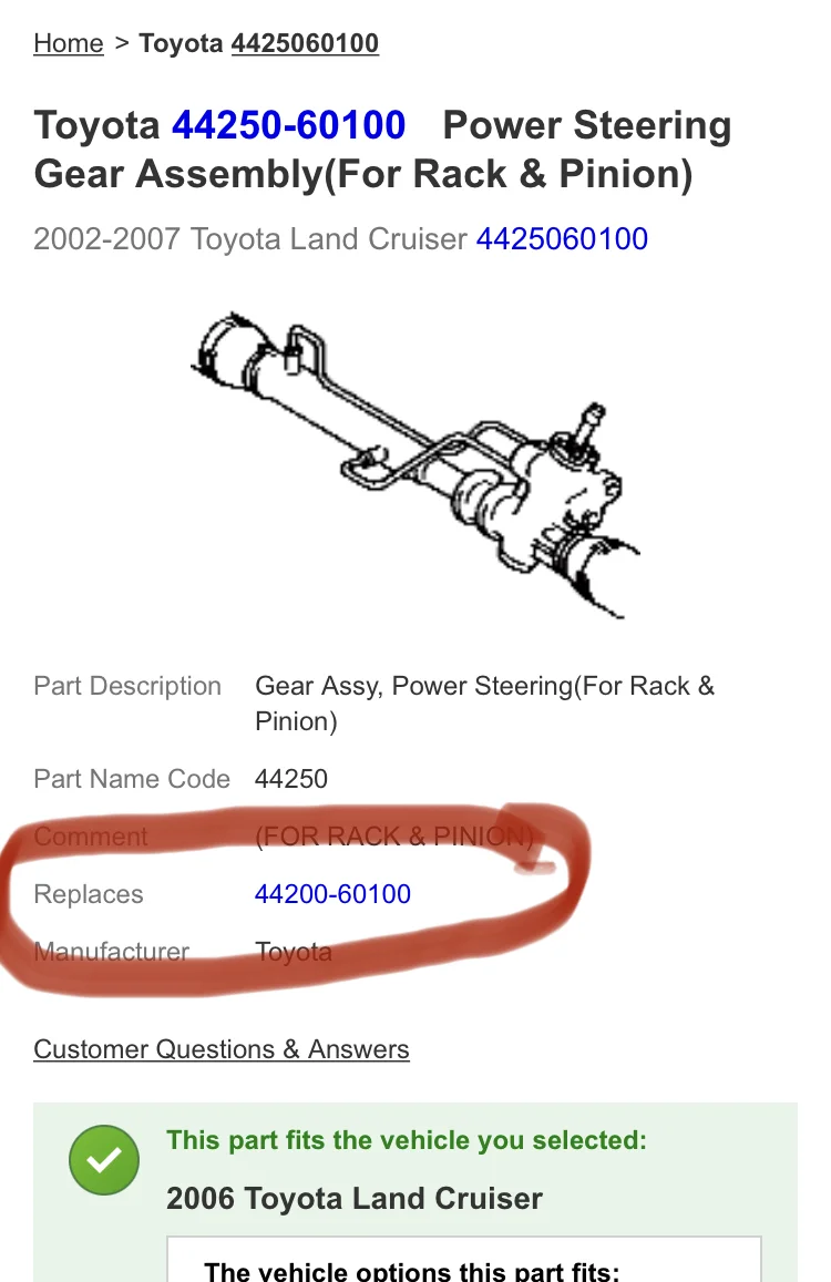

Which tells me a different part number and it's discontinued.
Dude, no offense intended but you gotta read. For the 100 series, 9 times out of 10, if a part number is discontinued it’s because it was replaced by a different part number. Rarely are 100 series parts NLA. Part numbers get superseded all the time.
Okay - offense intended, I can read fine, and saw that the new part number superseded the old. My question was how you found that part number in the first place. When I searched for it, all I found was the old part number that showed discontinued on quite a number of toyota parts sites with no mention of the new part number.

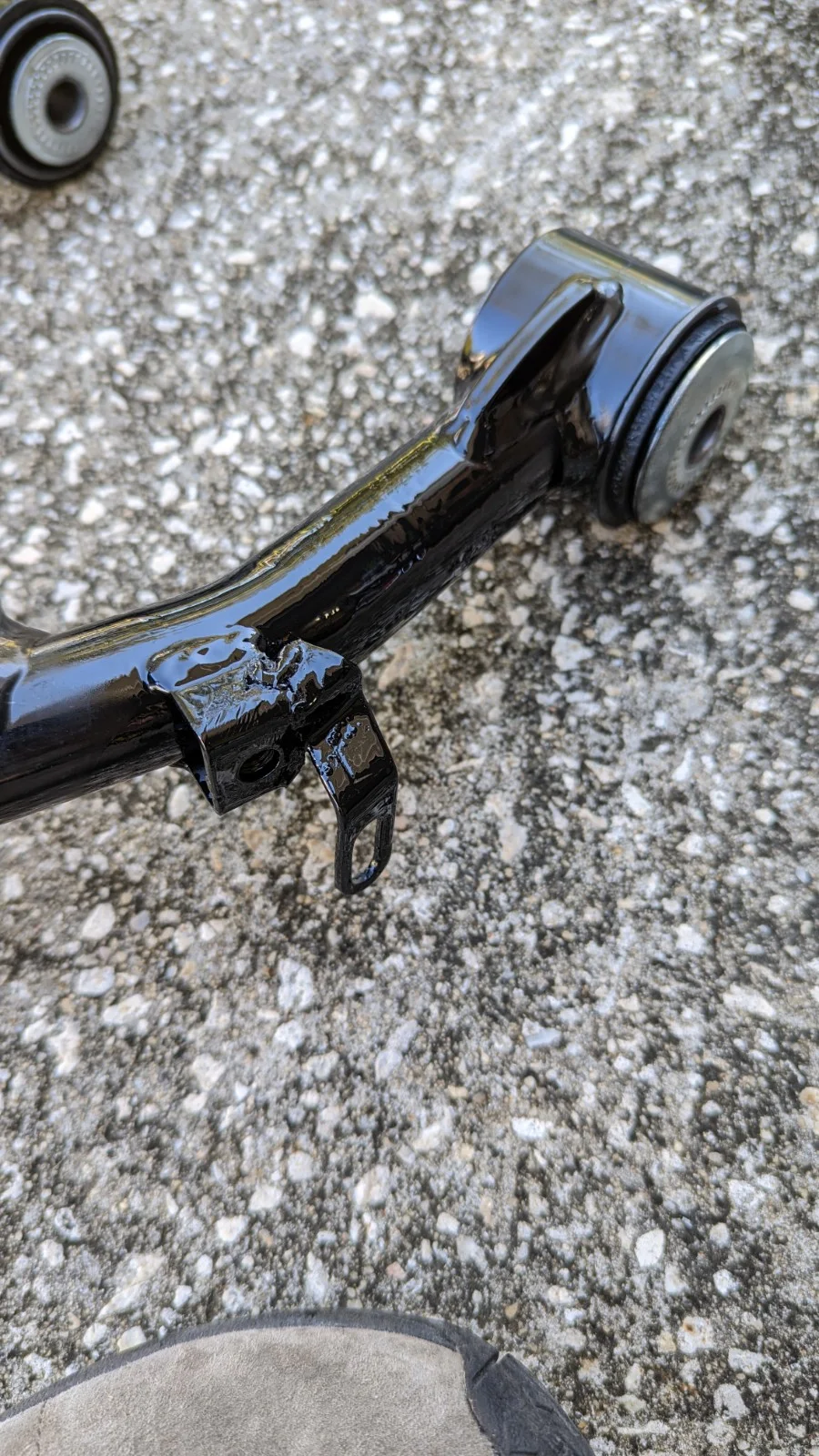

Edit edit: nitro UCAs with added AHC bracket:
