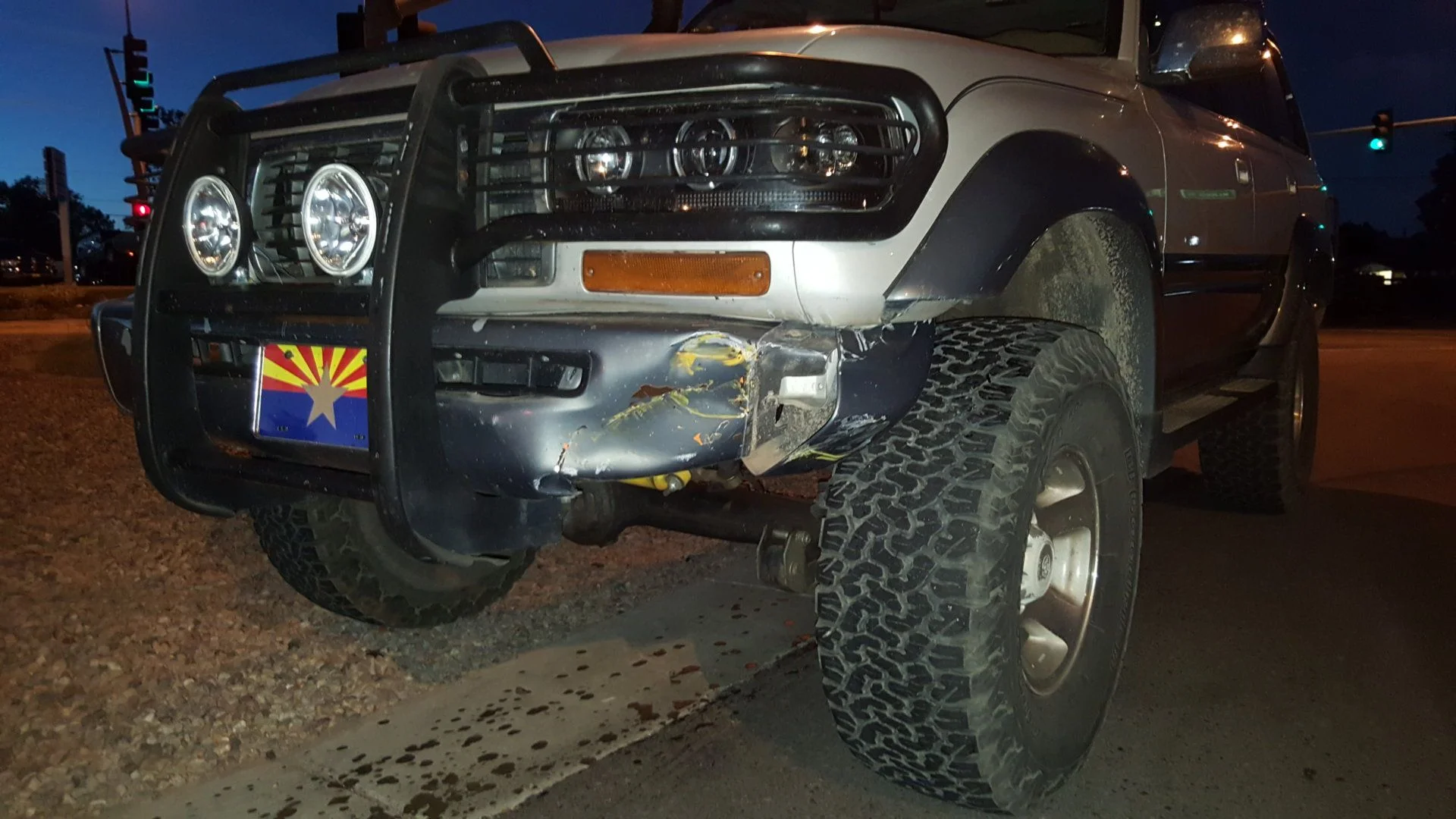

I got into a bit of a fender bender the other night. It wasn't my fault so I'm just awaiting the check to pay for the damages.
Its time for me to replace those stock bumpers.

From the car blood on the road it looks like a "you should see the other guy" moment
Thanks for the comments and tips! The other guy, surprisingly, did quite well. It was a 91 Jeep. Damage was a small quarter panel dent and the fan nicked the radiator. Basically, this was a low-speed collision. The Jeep had a steel C channel bar bumper that did most of the damage on my side.
