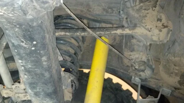

. By the way how much room (tape measure if you'd be that kind) between the bed and top of dif?
I am not sure if this is what you are looking for, but I have almost 14" from the top of the diff to the underside of my bed. I am sitting on roughly 5.5" of lift (4.5" w/springs & 1" body lift).
Here's some
If you look at the last picture, the axle is on the left and right is the tank. The upper control arm ends just before the tank.
I don't think a double triangulated 4 link will work with the gas tank location. Assuming that is what you were planning.
Mine sits almost dead flush with the bottom of the rail.
The tank is attached to the body via straps so if one were to install a 1" or more body lift you could have the clearance you're looking for. I can confirm later this morning but with the 1" BL on mine I recall the gas tank protector being flush with the bottom of the frame.

Sorry for the delay, life happens. Just to confirm, the 1" body lift will get the bottom of the gas tank cover flush with the bottom of the frame. I don't have any pics available.

That picture is with NO body lift. Body on frame.
Here you go. A couple more
The gap you see is between a 1/2" and 3/4"
