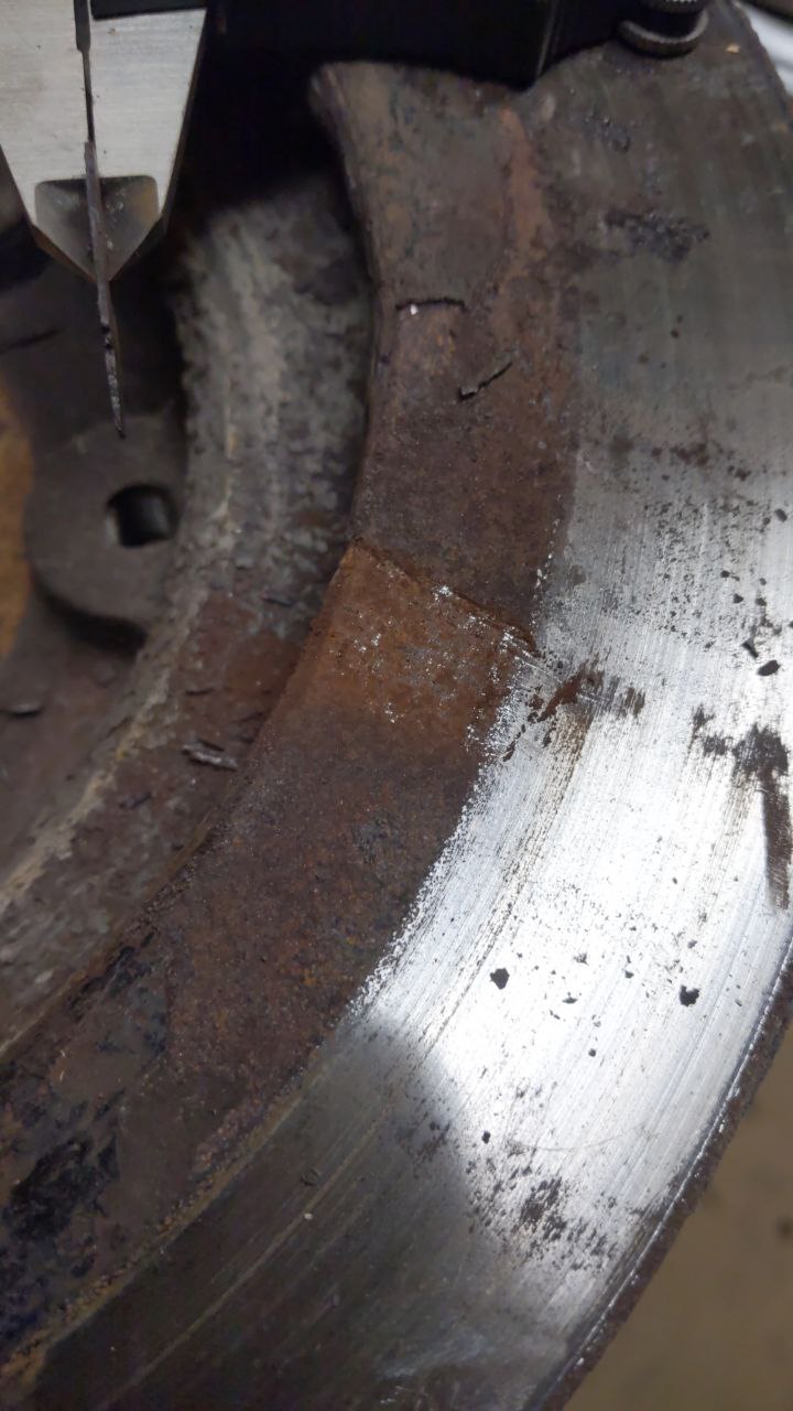

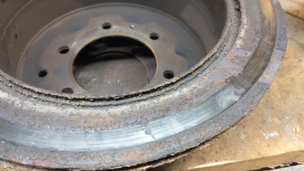

I'm working on our '93 FZJ-80 with discs all around. I did the calipers and pads a while back. The rotors, from the outside, looked fine and I ignored them.
The typical "warped rotor" feeling came, I think getting progressively worse after the job. Pulsating while on the brakes.
I had heard about rotor buildup before, that the rotors aren't normally warped. but since I didn't see anything obvious, I just let it be.

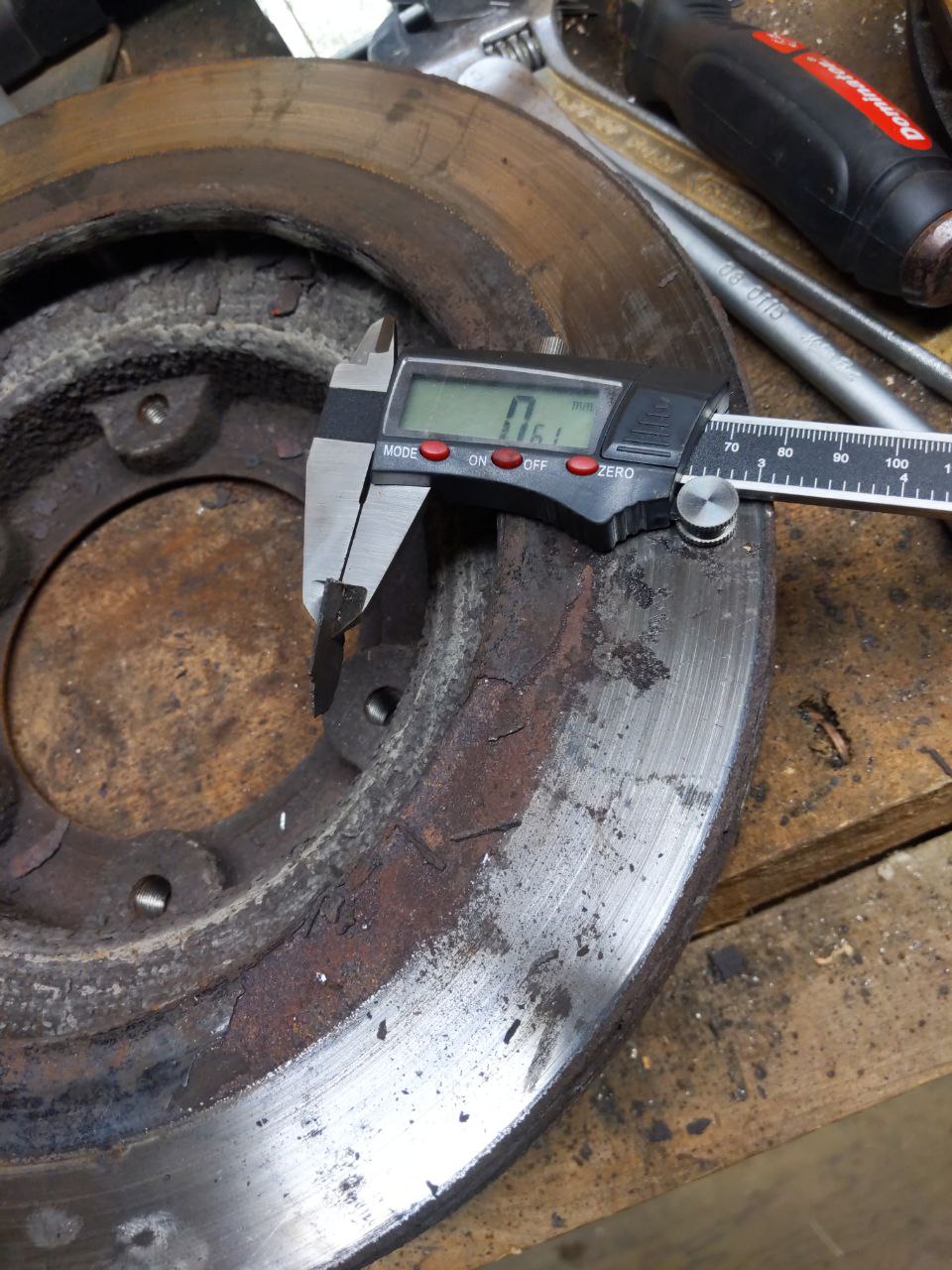

After buying some rotors and now finally tearing into it, I finally got started on the front right corner. I really ought to get a dial caliper as the spec is pretty tight -- 0.15mm. But nothing obvious visually.
After removing the caliper, I noticed something very odd. Swept area is significantly different from outside to inside. The inside of the rotor has a ton of buildup in one spot. I was able to hammer lightly on it and break it up. Underneath was a layer of rust, which I was able to scratch off fairly easily.
Maybe my rotors are fine and this is just the buildup that people talk about? Is this a common spot for it? How does it usually manifest? Can you clean it off well without removing the calipers? Not too happy about having to take apart the hubs to get the calipers off as it just adds an extra step and some more bits to get wrong. Although I'm thinking it may be the only way.

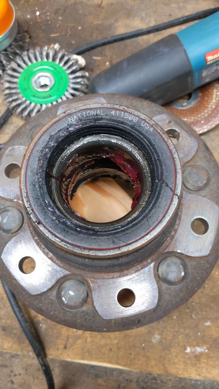

My inner hub seal looks fine, although was replaced with an aftermarket part. But maybe at one point it was leaking? My theory about the buildup, and I don't know what I'm talking about with this, is that the inner seal may have been leaking a long time ago and some molybdenum rich grease coated around that spot and created this strange deposit. Please let me know if that seems sensible or impossible.
I haven't gotten to the other corners yet.
Thank you!

Part of that is from not driving it enough.
Second, have you bedded your brakes properly? This helps prevent that issue.
I did a couple of the bedding practices, but definitely not perfectly.
What is the cause from not driving it enough? We do lots of highway driving and only a little bit in the city, so they don't get worked all that much.
My rotors look like that all the time but we see salt on the roads in the winter and I just assumed it was from that. I go "Cuban Style" on them like you did, hammer off the rust, run a file over it and reinstall. Easier in the back than the front so the fronts just get replaced with new. I've been driving my same 80 in this climate since 2007. If there is some other cause that can prevent this I'm interested to hear it.
Coming to a stop with your foot on the brakes after a long drive can "melt" the pads into the rotors and cause a buildup like that.
If you're really easy on the brakes or ride them a lot that gets the pads and rotors hot, then when you come to a stoplight and hold your foot on the brakes can do the same.
Bedding the brakes spikes the temps up and down. The heat from it helps cure the pads and make them "harder" and they will last longer and be less likely to do this buildup.
When I do my bedding, my brakes are smoking by the time I'm done, but I do NOT hold my foot on the pedal. I keep rolling until they cool.
Also, if the truck sits for week(s) at a time, the area where the pads are can hold moisture behind them and will cause rusty areas. My wife's van does this because she may not go anywhere for a week or more at a time, then she doesn't drive aggressively enough to get the brakes warmed up and polish off the rust.

IMO you'll spend more time cleaning those rotors up than they're worth, new OEM rotors are inexpensive and high quality.
Next is to get a set of early 100 series front brake pads (1998-2002 IIRC) (for the front calipers). They're slightly larger than the stock 80 Series front pads and cover the front rotor out to the edge. OEM pads are also great quality or IMO a good second choice would be Akebono pads. (note: you can't use 100 series pads for the rear pads, those stay stock 80 series pads (size)).
Some people had issues fitting the 100 series front pads in an 80 Series, they didn't drop in (I had to lightly tap them in), but the front brakes did not run hot and I'm still running the same set with 90,000 miles on them. FWIW.
Also check that your calipers aren't sticking/stuck. Might be a good time to rebuild or replace the calipers.
For the hub seals, consider Terrain Tamer HD hub seals, cuts down on wear into the spindle from the OEM style hub seal.
FWIW
I agree with @Kernal above, i wouldn't bother cleaning up those.
Also, have similar experience to what @BILT4ME described. Vibration felt through the brake pedal in a work car that mostly saw easy city use.
On the highway on a downhill, without to much traffic about, stand on the brakes hard, wash off speed from around 50mph down to 25-30. Come back up to speed, repeat 4 or 5 times. Stop before your brakes fade fully.
I've done this a few times, and it will help if there's a light build up on rotors causing a vibration. I wouldn't expect it to fix what you pictured though

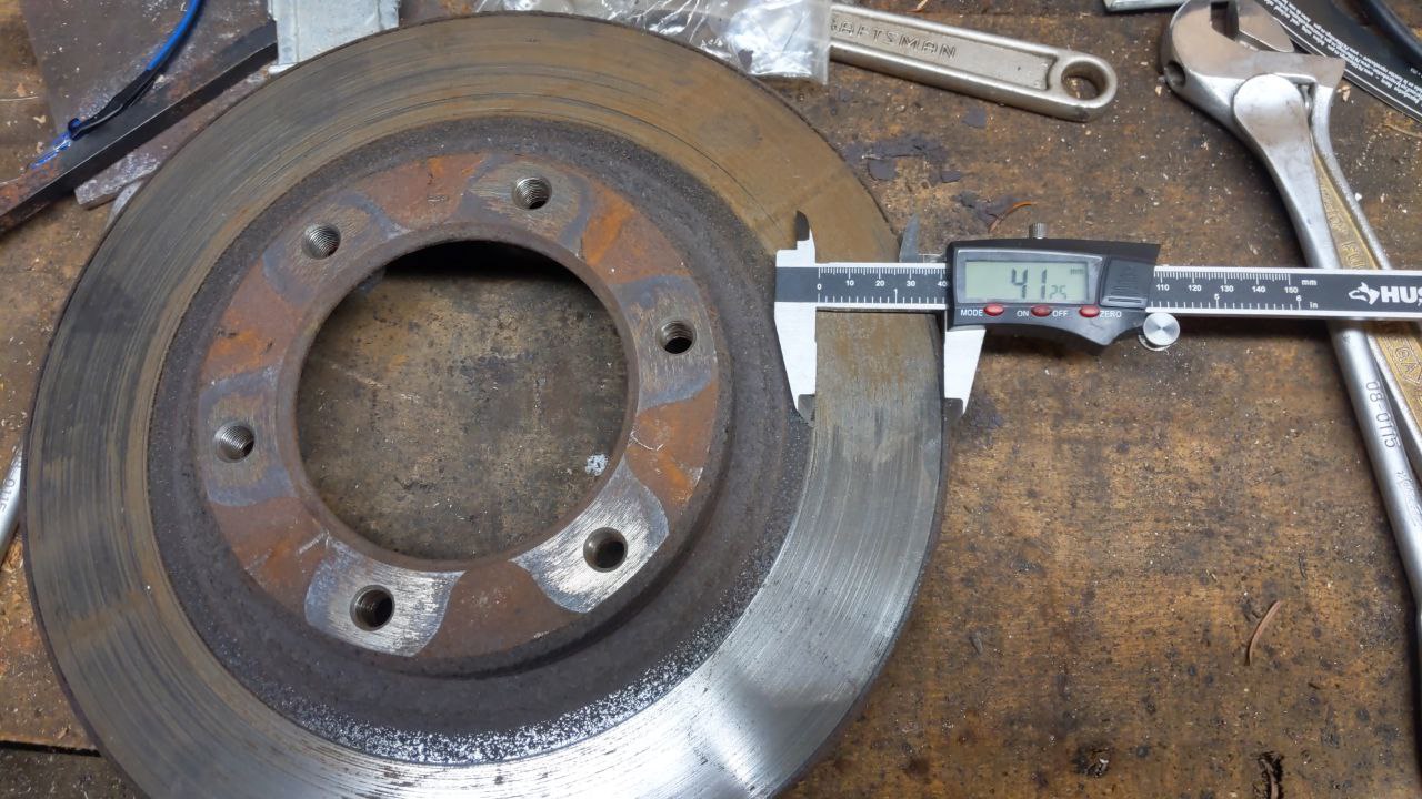

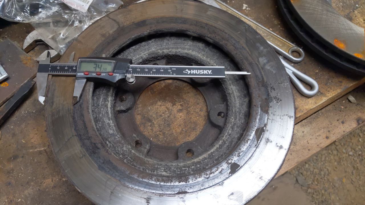

I finished all but the rear right rotor. Rear right ended up giving me some grief. My nemesis, the rear disc brake, has struck again.
The rear left rotor came off without any struggle, so I was expecting none for rear right. I didn't back off on the parking brake adjuster on either, and it seems that was a mistake for rear right. I was too aggressive getting the rotor off and didn't realize the parking brake was sticking to the rotor (must've been misadjusted?).
Parking brake is all apart and the rotor is off. Rear left rotor wasn't bad looking, but rear right is looking rough and definitely worth replacing.
I'm hoping I didn't bend up any of the parking brake parts and that I can manage to put the contraption back together.
I am seeing some weeping on the inside hub seal, so maybe it is time for those Terrain Tamers after all. Way less than the other side though, and makes me wonder if it was leaking but the leak was stopped and never fully cleaned up.

I managed to sort out the parking brake and put it back together. Little tedious, but not too bad.
Brakes feel really nice now! But not surprising there's an improvement given how nasty some of the rotors were.

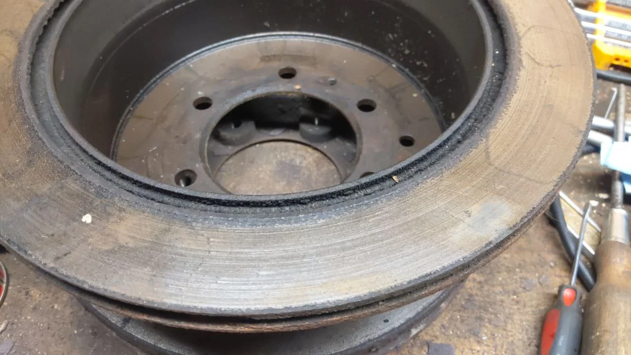

Rear left:
(Note the well oiled parking brake surface.)
Rear right:
Not sure what those two dimples are about.
Rear right also had stuck sliding pins. I must've forgot to grease them, but might've also been from parts being delayed. Moving much better now. Hoping the uneven pad wear sorts itself out.

Ummmmm. Your Right rear appears to have a pad inserted with backing plate against rotor surface and fused to the rotor surface Itself. That one is done.
