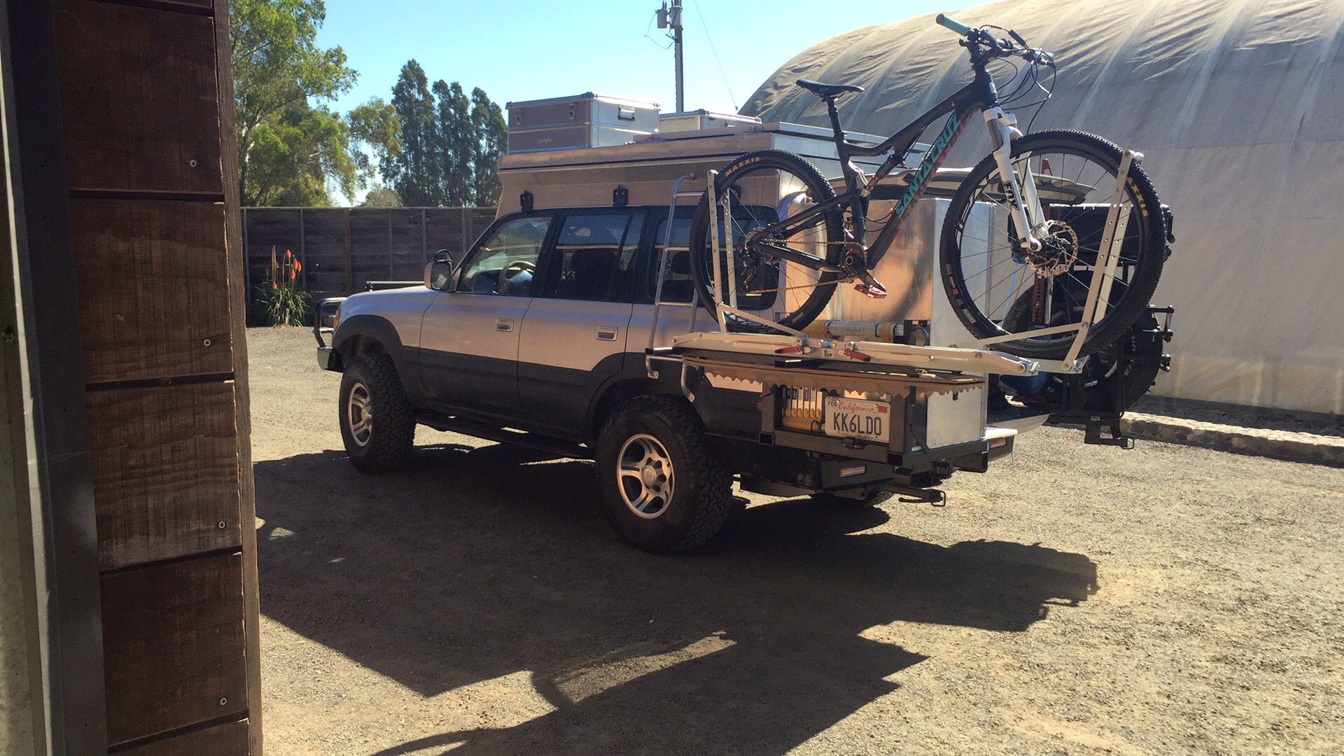

One thing I did manage to get done before leaving though was finally covering up the 1000 holes from the cladding with black bed liner and mounting an ARB front bumper and a kaymar rear. I have something special planned for my dual swing out rear bumper: I'm ordering a big aluminum toolbox to put on one of the swingouts for extra cargo. Once I'm back from Brazil...

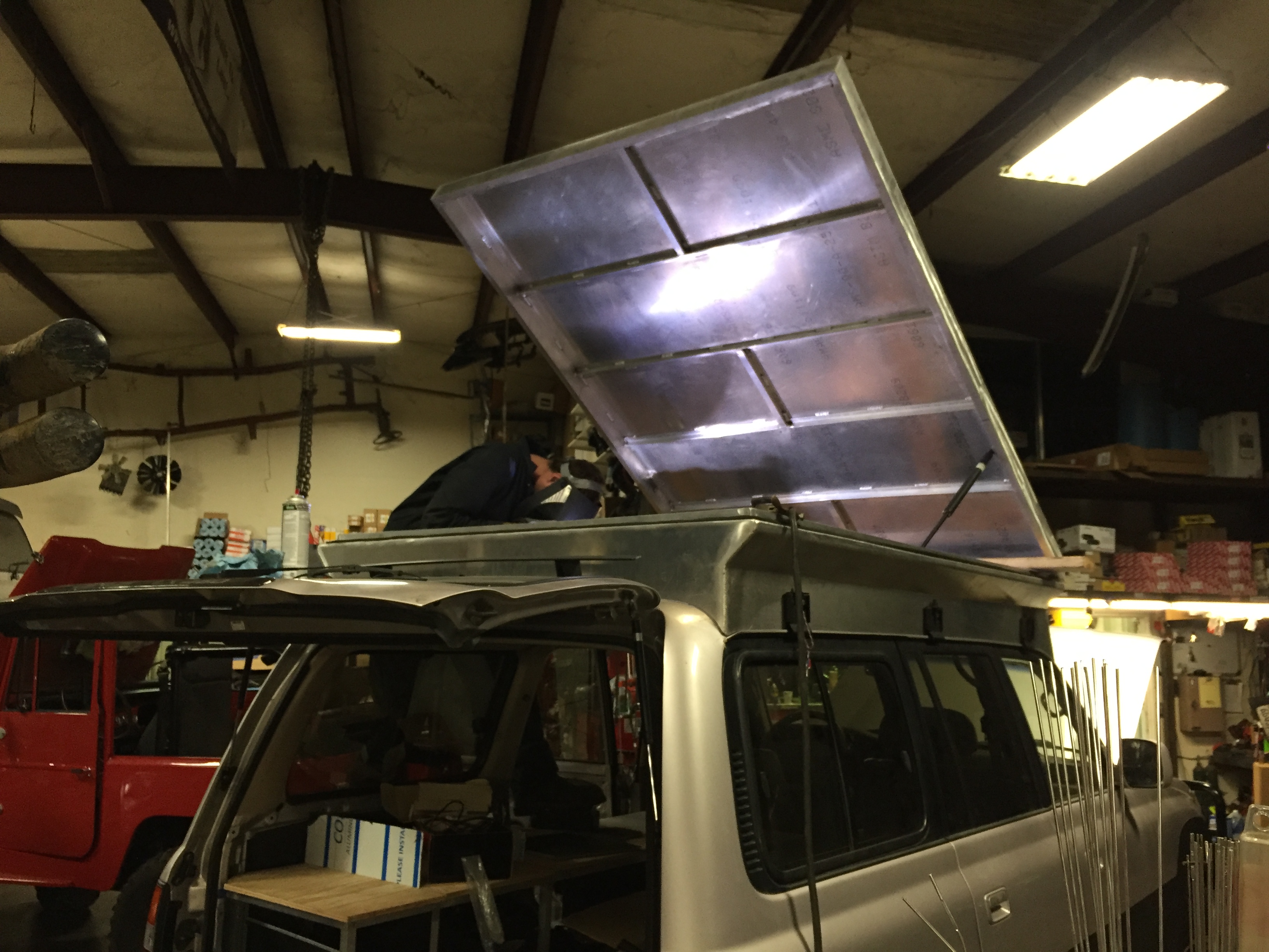

It's been a very long time since I've had time to actually work on the roof. I've mostly been focusing on the interior (hot water heater, water filtration, propane stove). But a few weeks ago we finally did it, we cut the roof and glued the top down with sikaflex (a caulking like glue).
I initially planned on cutting just behind the sunroof. However seeing how small that hole is and how much headroom we'd gain by cutting more, we decided to just keep going and cut some more :D
Once cut, we glued the roof down with sikaflex. The roof won't be coming off anymore like that. As for stability issues: the roof is pretty sturdy itself and should easily compensate for what was cut out.

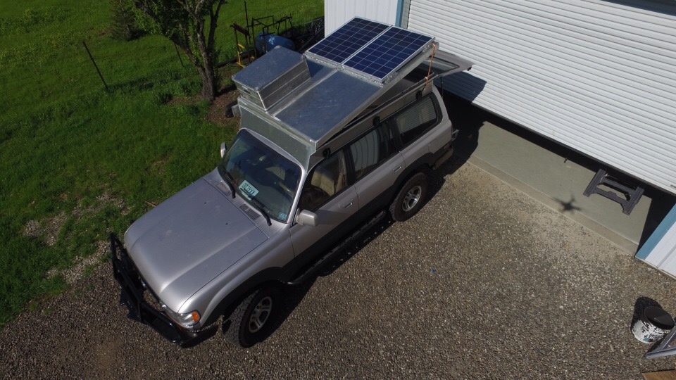

I also found a pair of 100W solar panels that fit perfectly onto the top. Along with two 120L Alu Boxes in front, the roof will be pretty loaded. But for the kind of traveling I'm doing, I will need the extra room. The alu boxes are bolted in through the roof, without breaking them open, you will not be able to take them off and that way I don't have to worry about ratcheting them down.

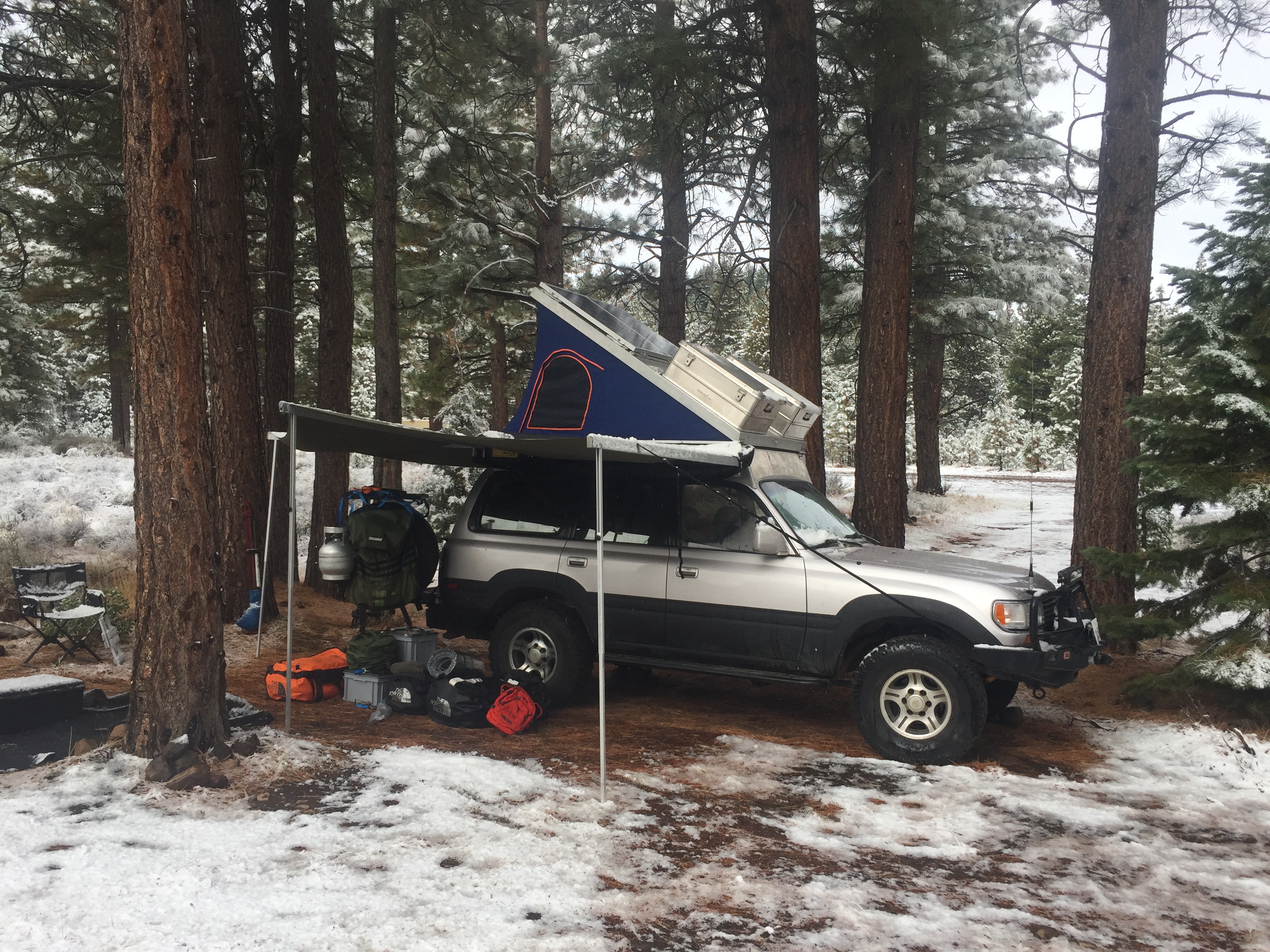

We managed to hit the first snow in Tahoe a few days ago when we took the car to small shakedown cruise...

- Kaymar rear bumper with heavily modified swingouts to carry a huge aluminum toolbox for light cargo and room for bikes on the back

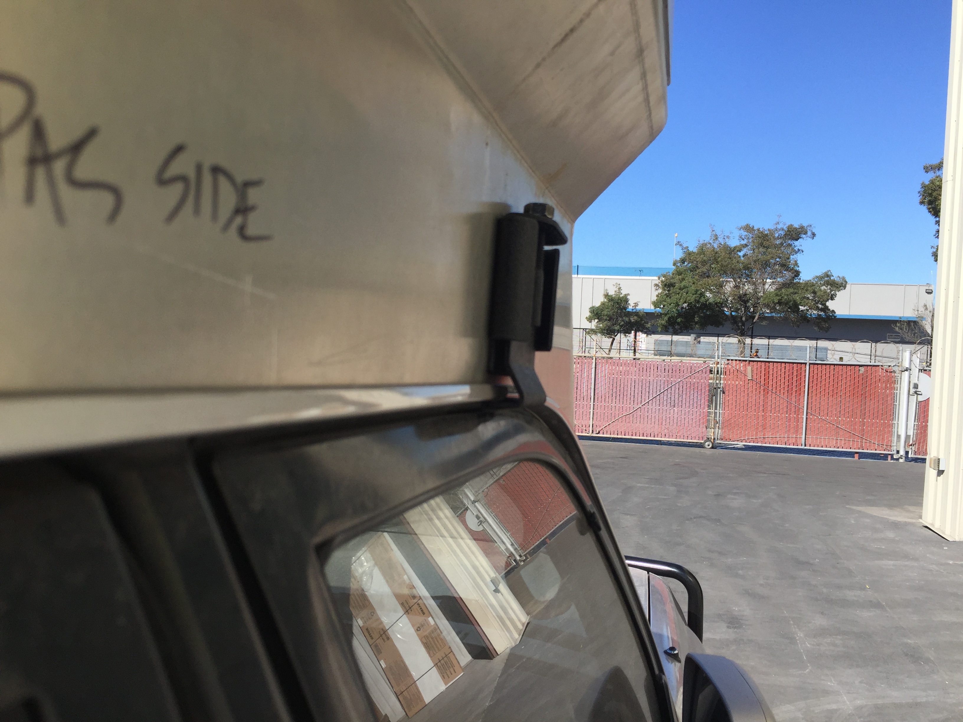

Other than that, I had to one other adjustment (picture of that will follow soon): the piano hinge that went along the entire front of the vehicle didn't hold up the weight of the roof. The problem was that the rectangular tubing that built the sidewalls of the roof pushed mostly on the outside and the weight wasn't balanced along the full length of the roof. We ended up cutting out the piano hinge completely and screwing on two burly stainless steel hinges with a 1/4pin on each side.
