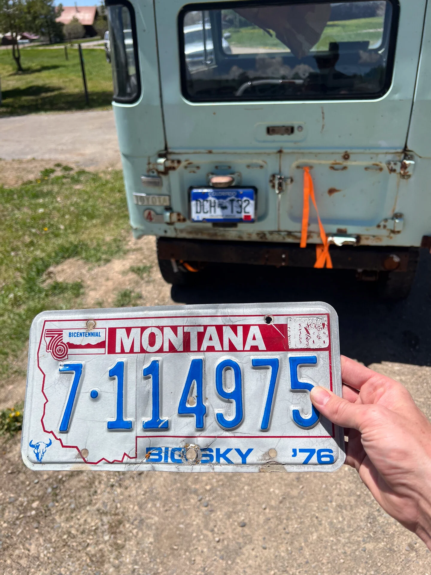

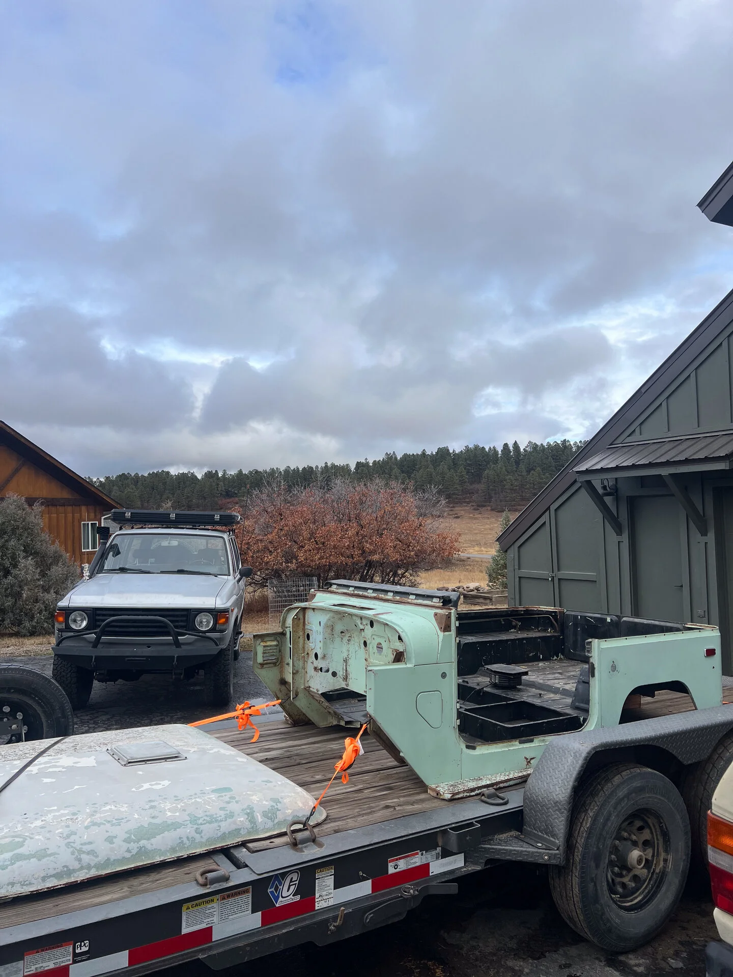

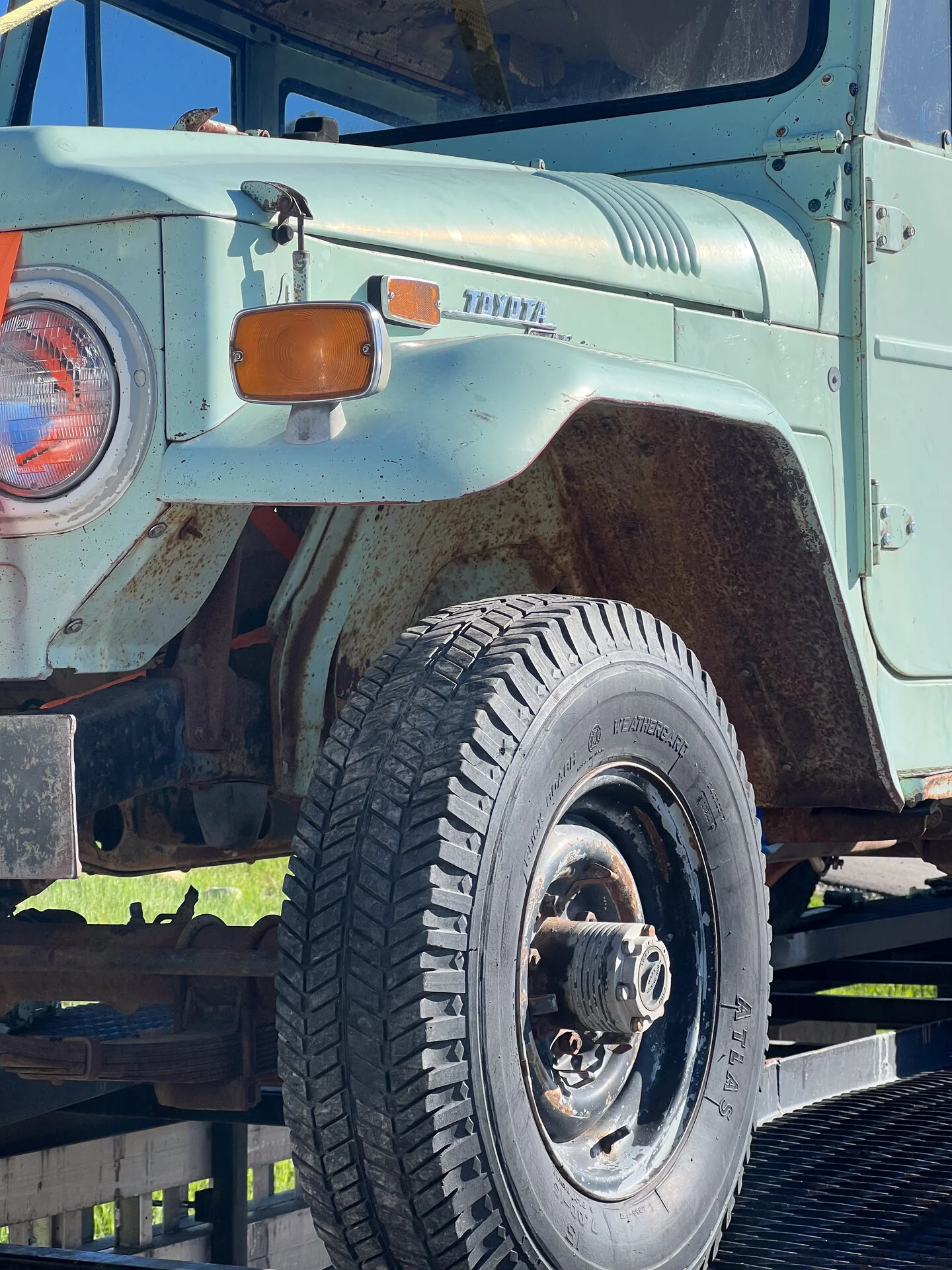

Hey all! I'm back with another FJ40 project. This time I am way over my head. But I'm pretty excited about it and have a project I can learn and build from the ground up. (Stupid, Expensive, Obsessed.) o_O
Some of you may remember this 40 from the classifieds early this year. But I purchased this from @wileycoyote in Montana in May and had it shipped down to Colorado. Just moved back to Colorado and I have been daydreaming about rolling around in another 40. I showed some friends and family, and I got talked into it by my girlfriend at the time. Who doesn't love Spring Green?
The basic:
1970 FJ40
Good Patina
No Drivetrain
No front seats
Been taken apart before
The last Registration was in Montana in 1988
No Title *edit* Rebuilder Title in progress
A little bit of rust, but overall not bad.

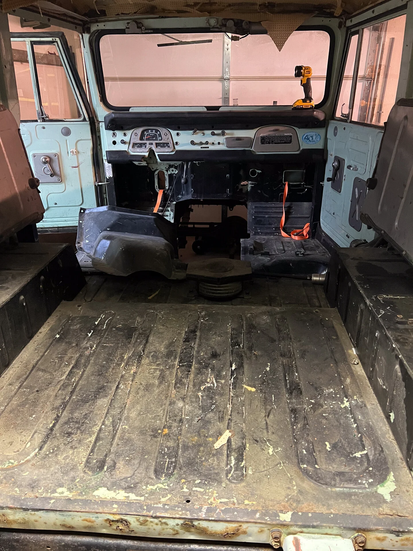

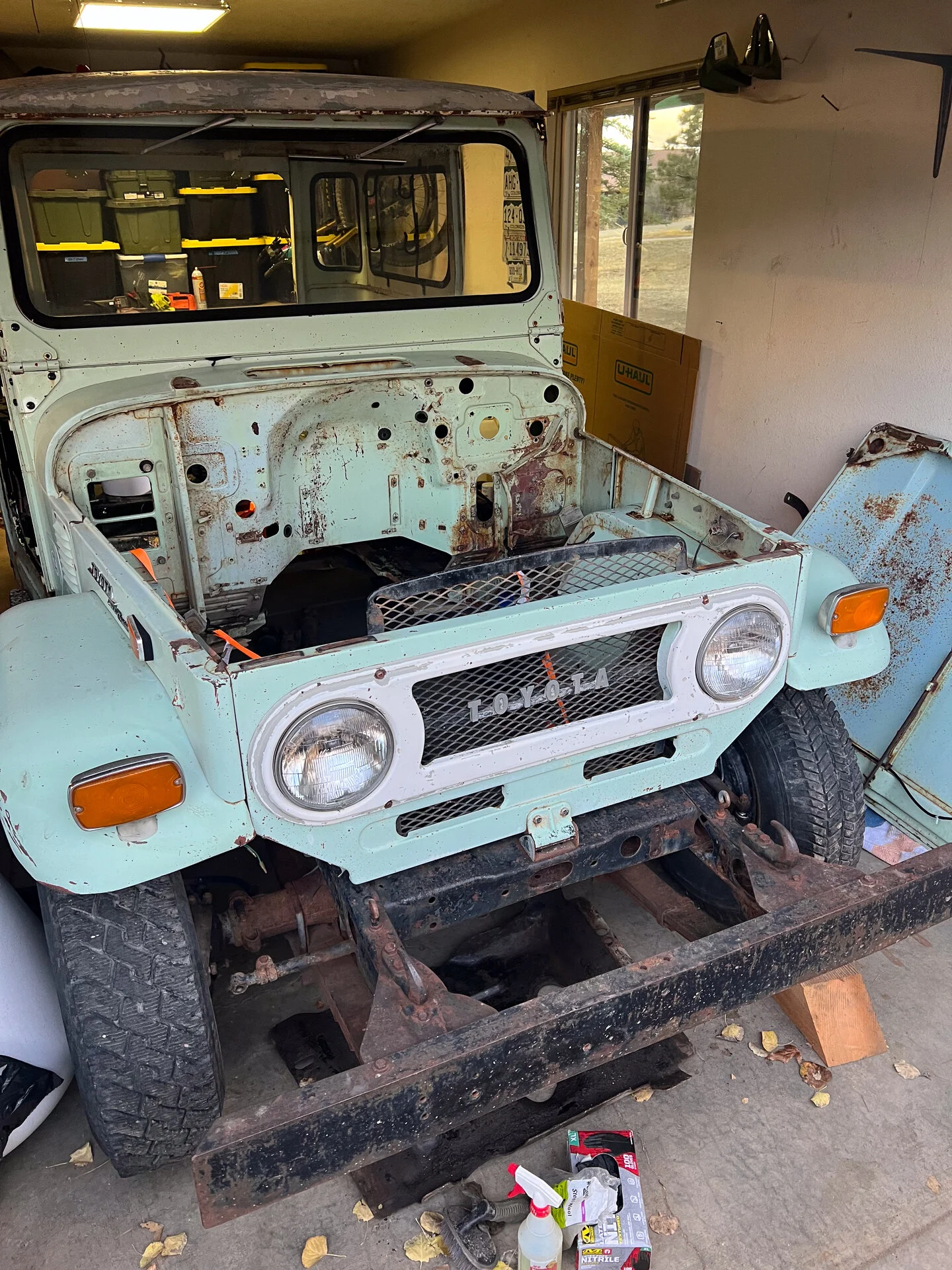

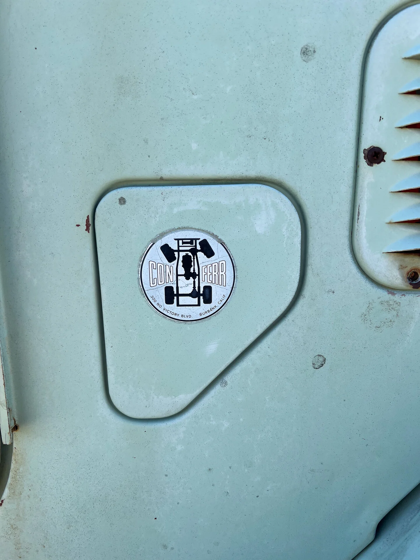

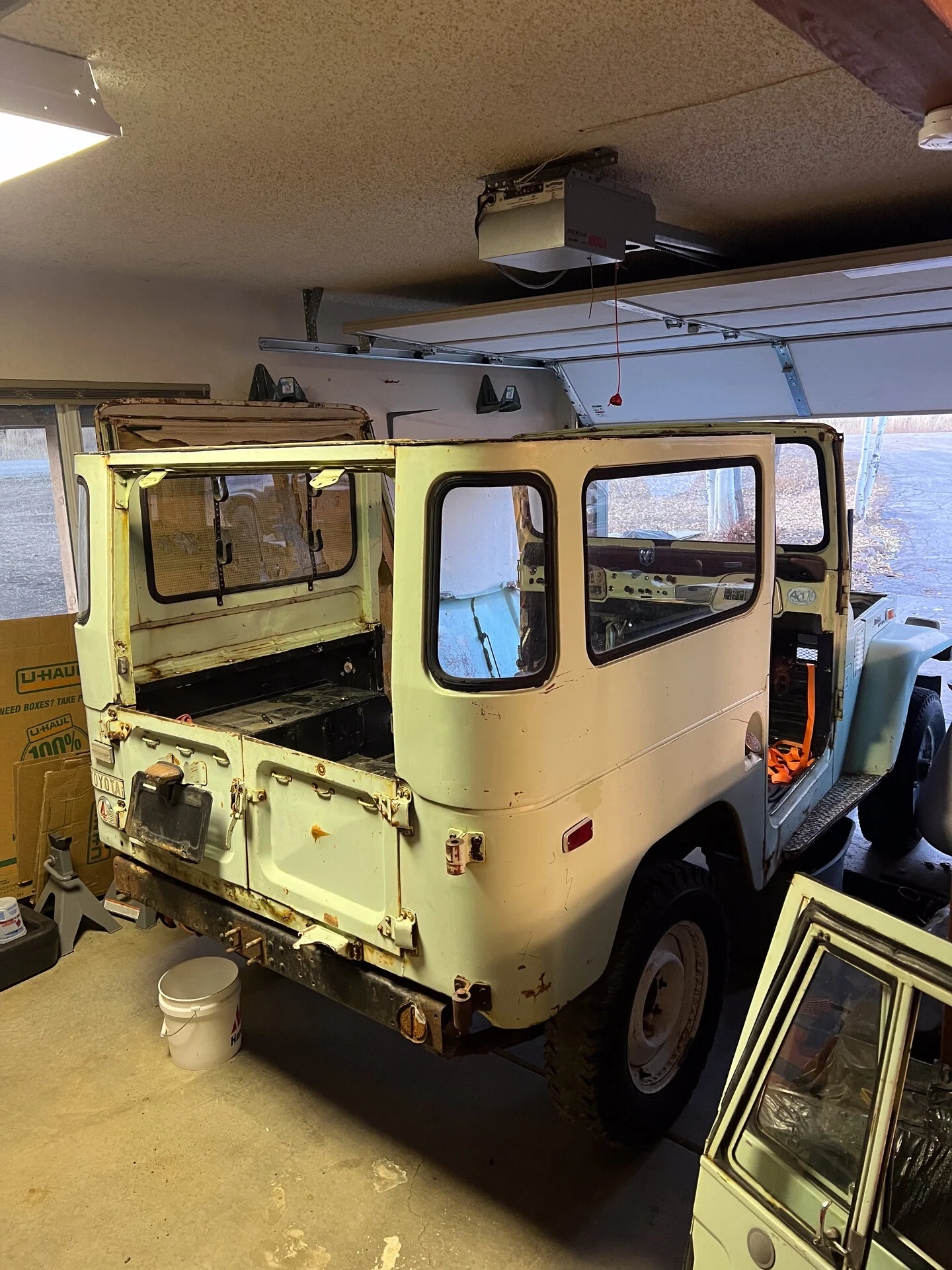

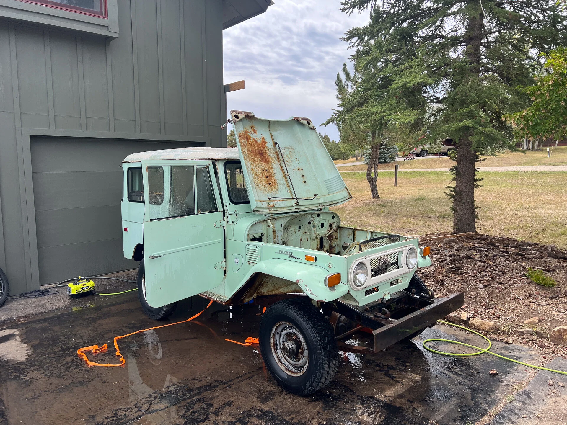

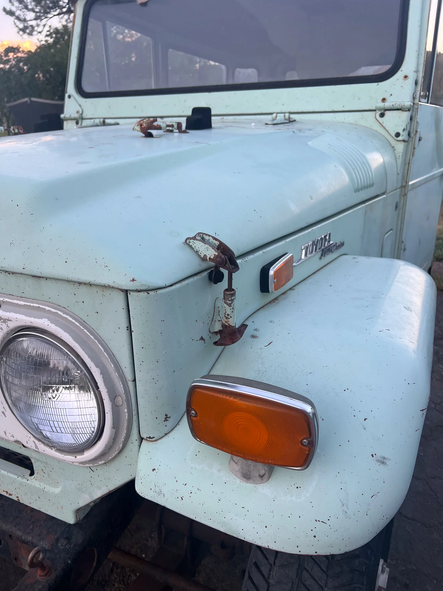

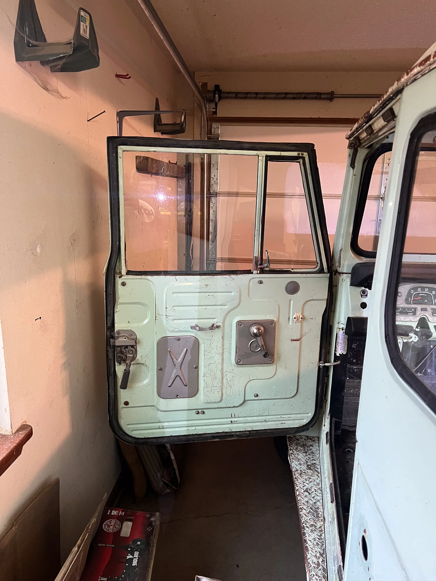

Some more photos of the body as I got it into the driveway! Can't wait to scrub and buff this baby! Some spots where someone thought about doing some rust patches. But not overwhelming (yet)
It just like Burger King - do it your way. Looks like there is plenty of good stuff to work with sheet metal wise but I'd start with getting the paperwork in order asap.
Thank you! I saw someone else using something close to that as well! At some point in this, it will be nice to patch some rust!

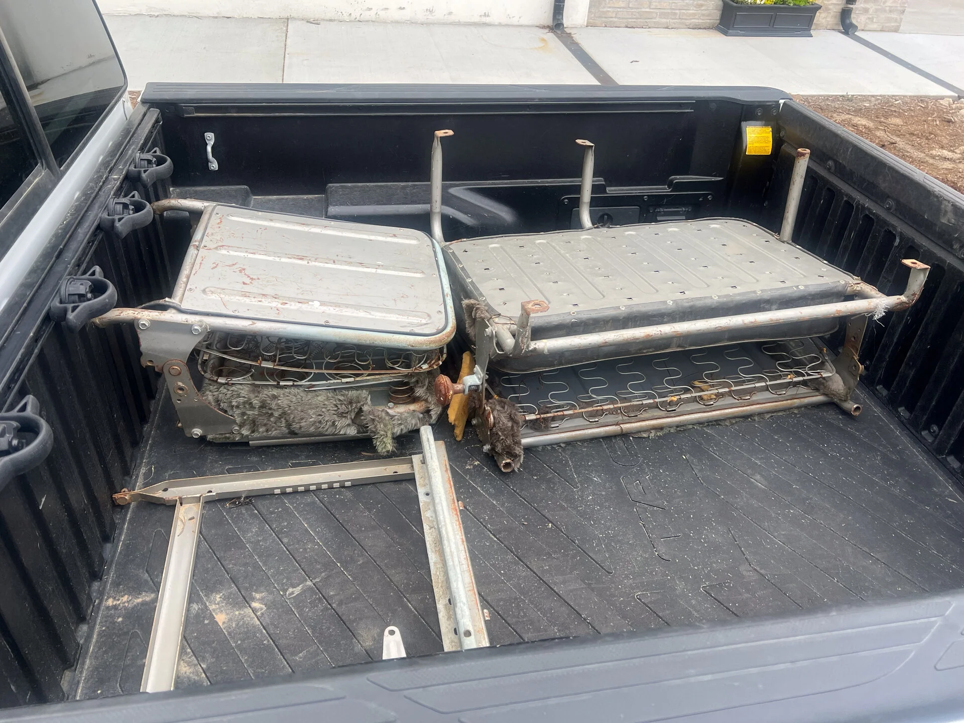

Bought some front seats from a fellow mud member who made some killer t-shirts as well as had a killer 55. ( @arthog )

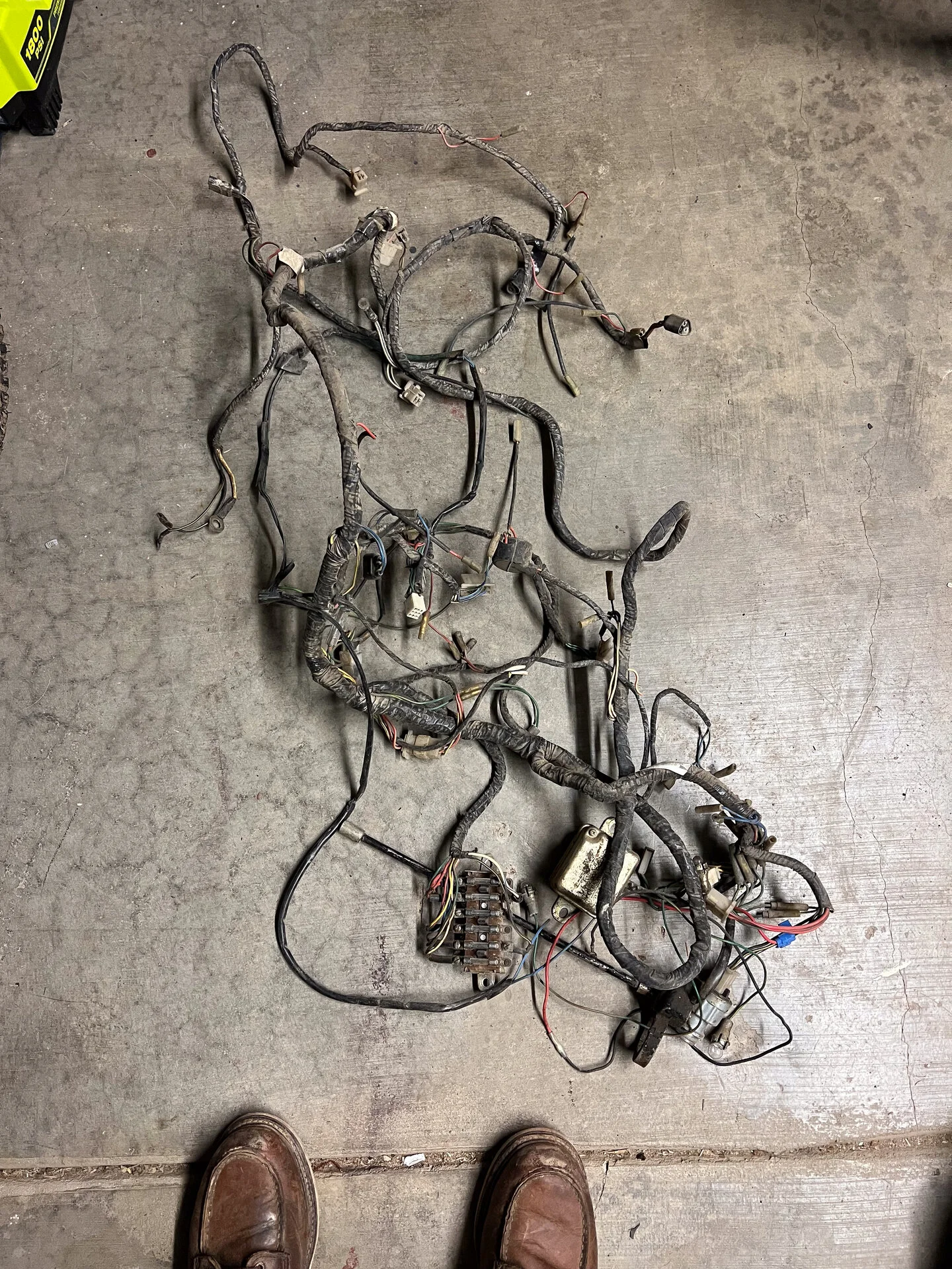

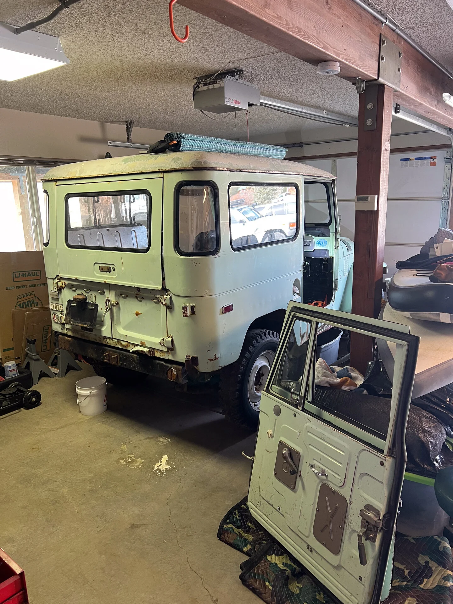

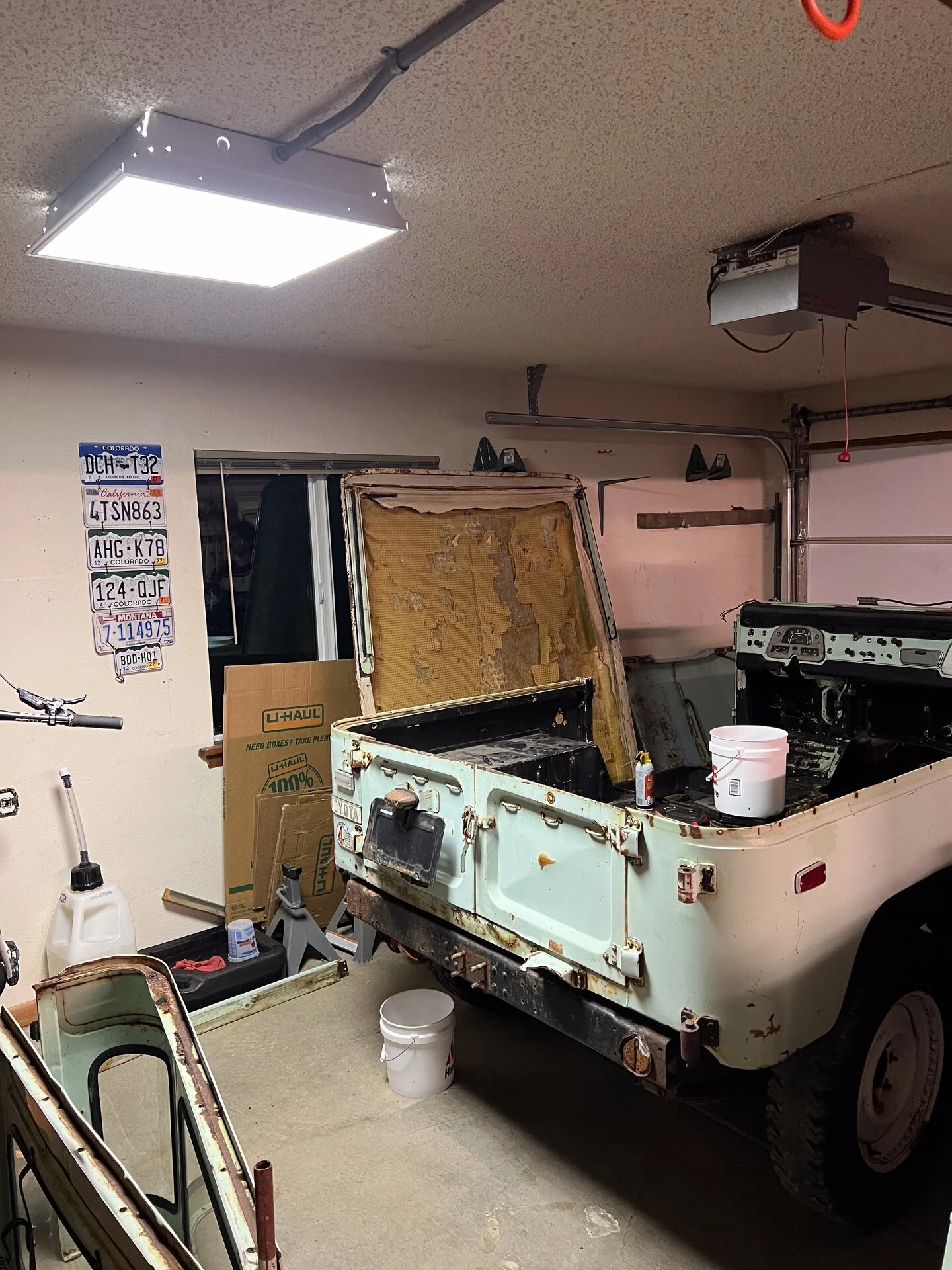

Got home and started clearing out the part bin in the back of the 40. Someone stripped it before. So if anyone has good recommendations for a new or rebuilt wiring harness, I would appreciate it. Also finally got it into the garage! (Yes I know about the Bezel.)
We rebuild wire harnesses, that one looks pretty good though.
We remove all loom, replace any damaged wires with correct color-stripe and OEM terminals/connectors, and test any original wires that aren’t replaced. Then re-tape

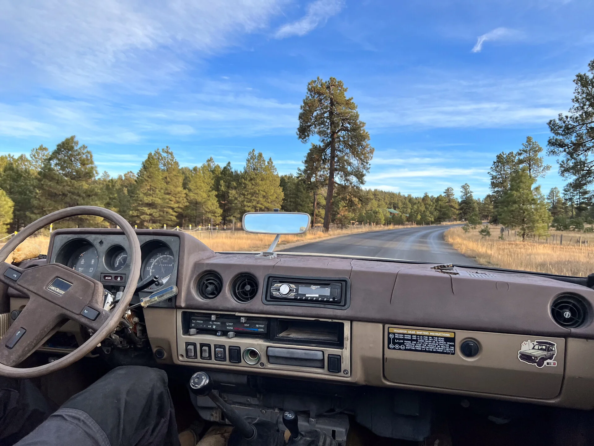

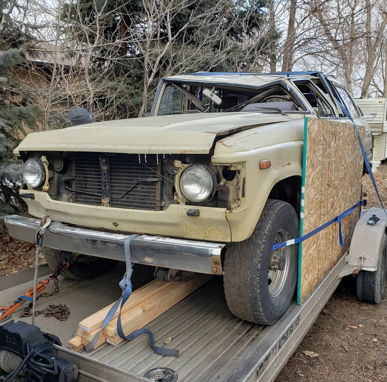

So I had a lot of back and forth on where I was going to go with the drivetrain. I thought about going with an LS like my 60, diesel TDI, or 1HZ swap... But ultimately the opportunity came up to have my turn with "chop top" from Jake (a rolled 60 series with a cool Colorado history.)

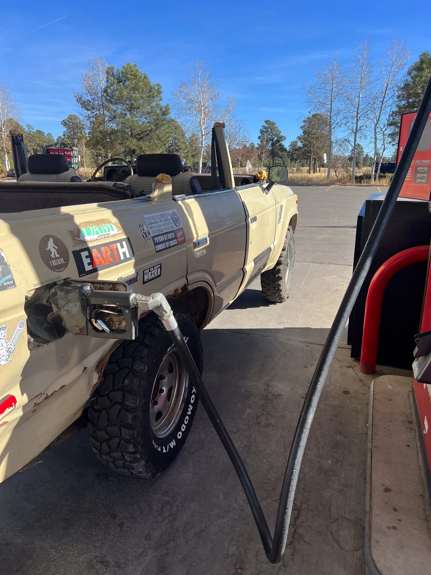

Since the chop top is a running and road-worthy creature. We have been cruising the crap out of it! My little brother is addicted to driving it around with all his friends. I wish I didn't get it at the change of the season or else it would be my bike shuttle for the summer.
So the 40 will get the 2F/H42 and split case from chop! As well as the 60 axles and some other goodies. The 2F is super strong, actually such a smooth and quiet 2F. I feel bad about ending the chop top life, but it will breathe life into this old 40.

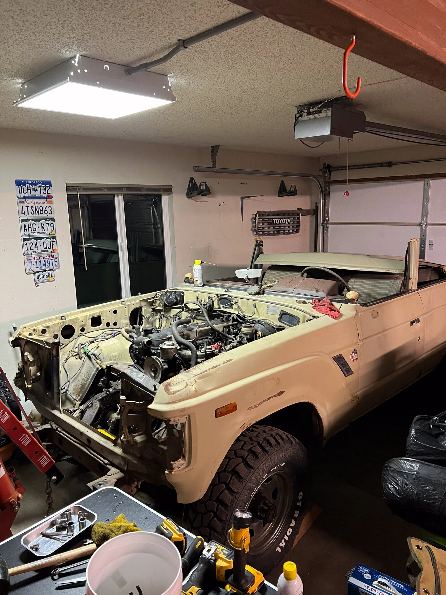

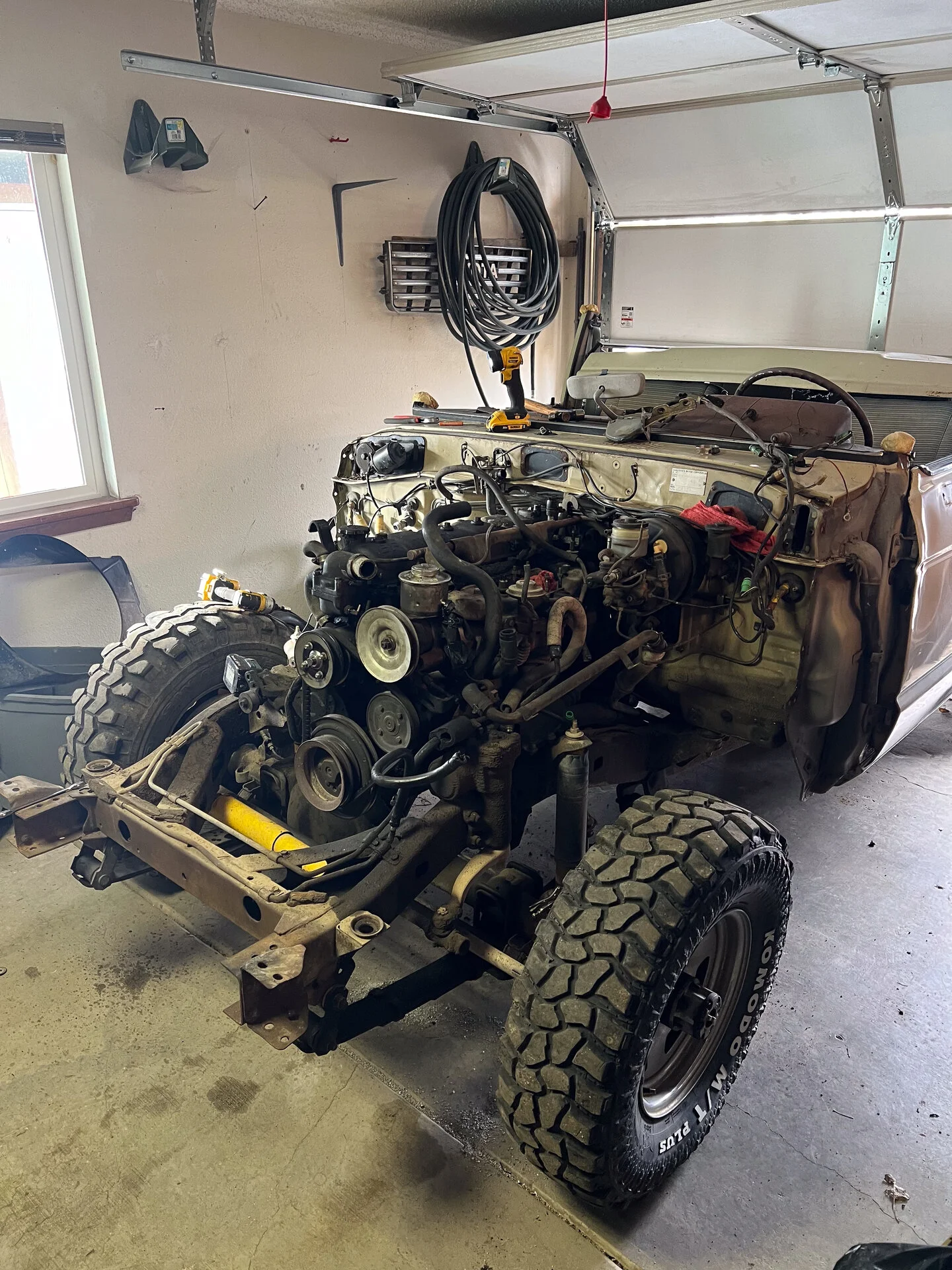

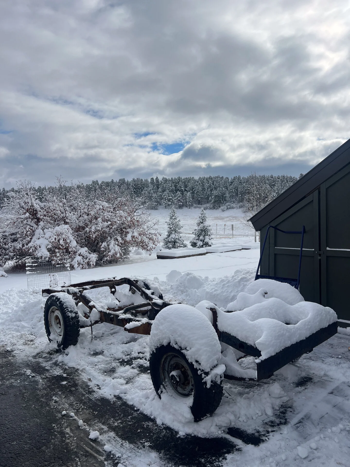

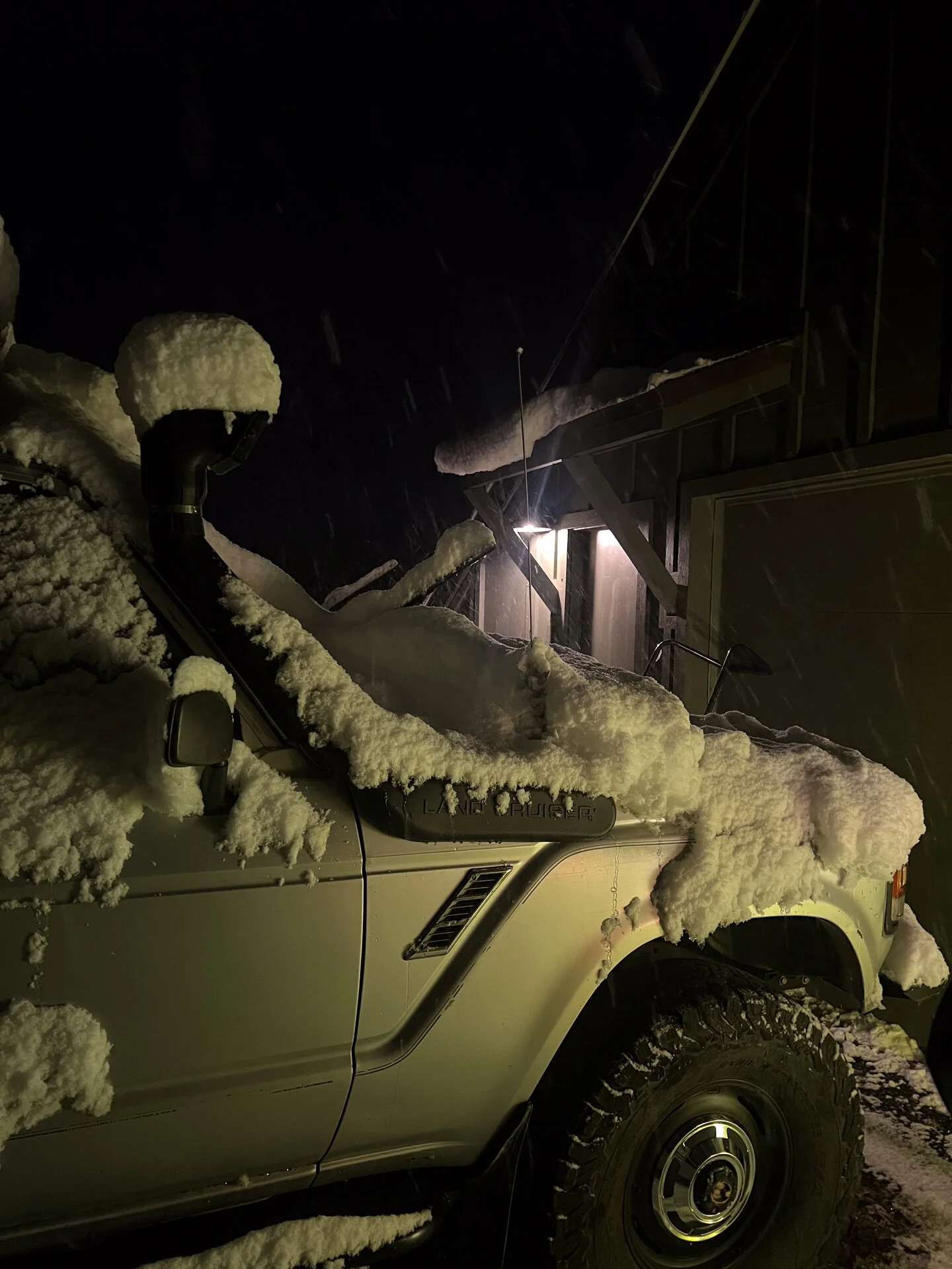

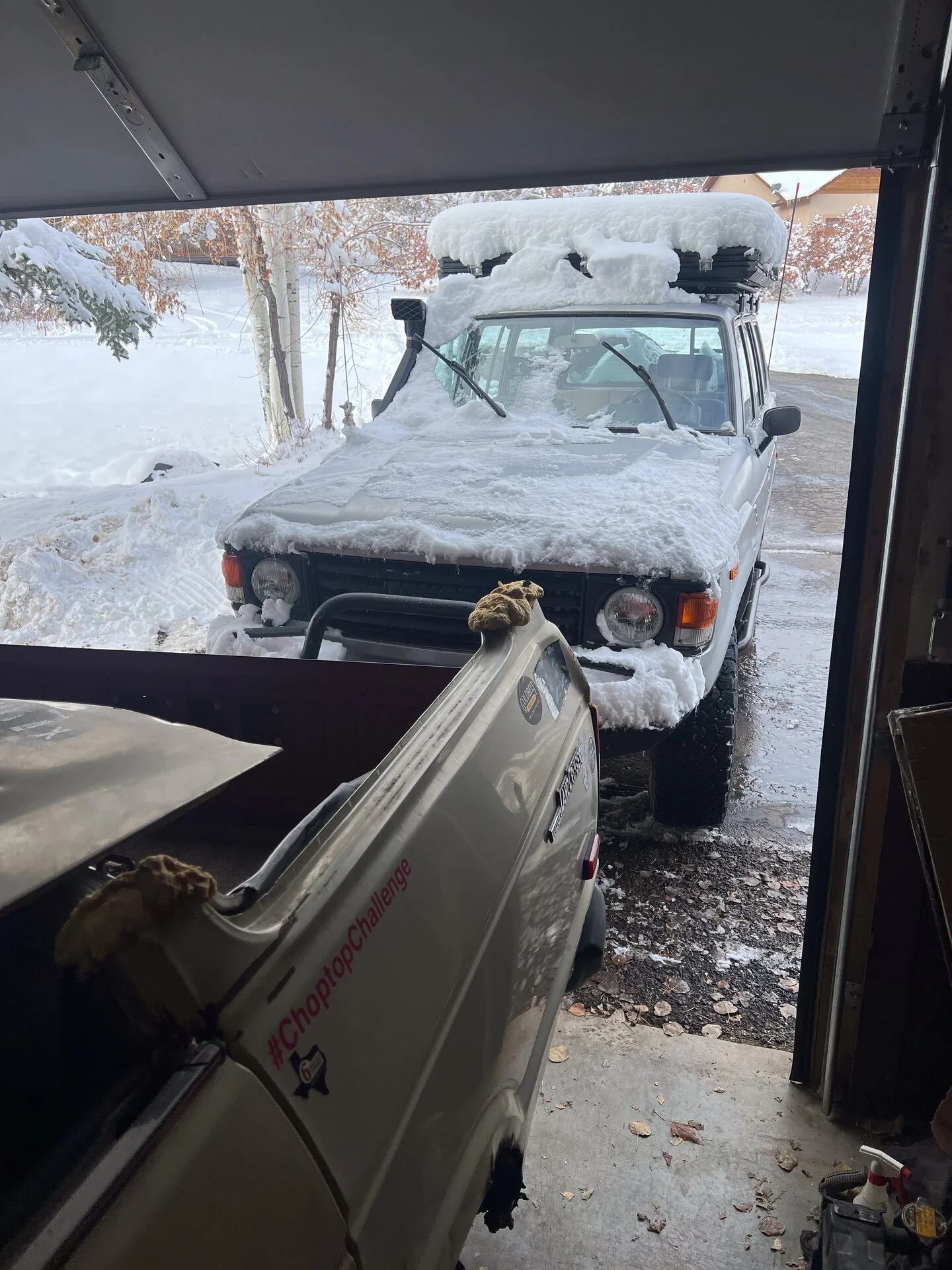

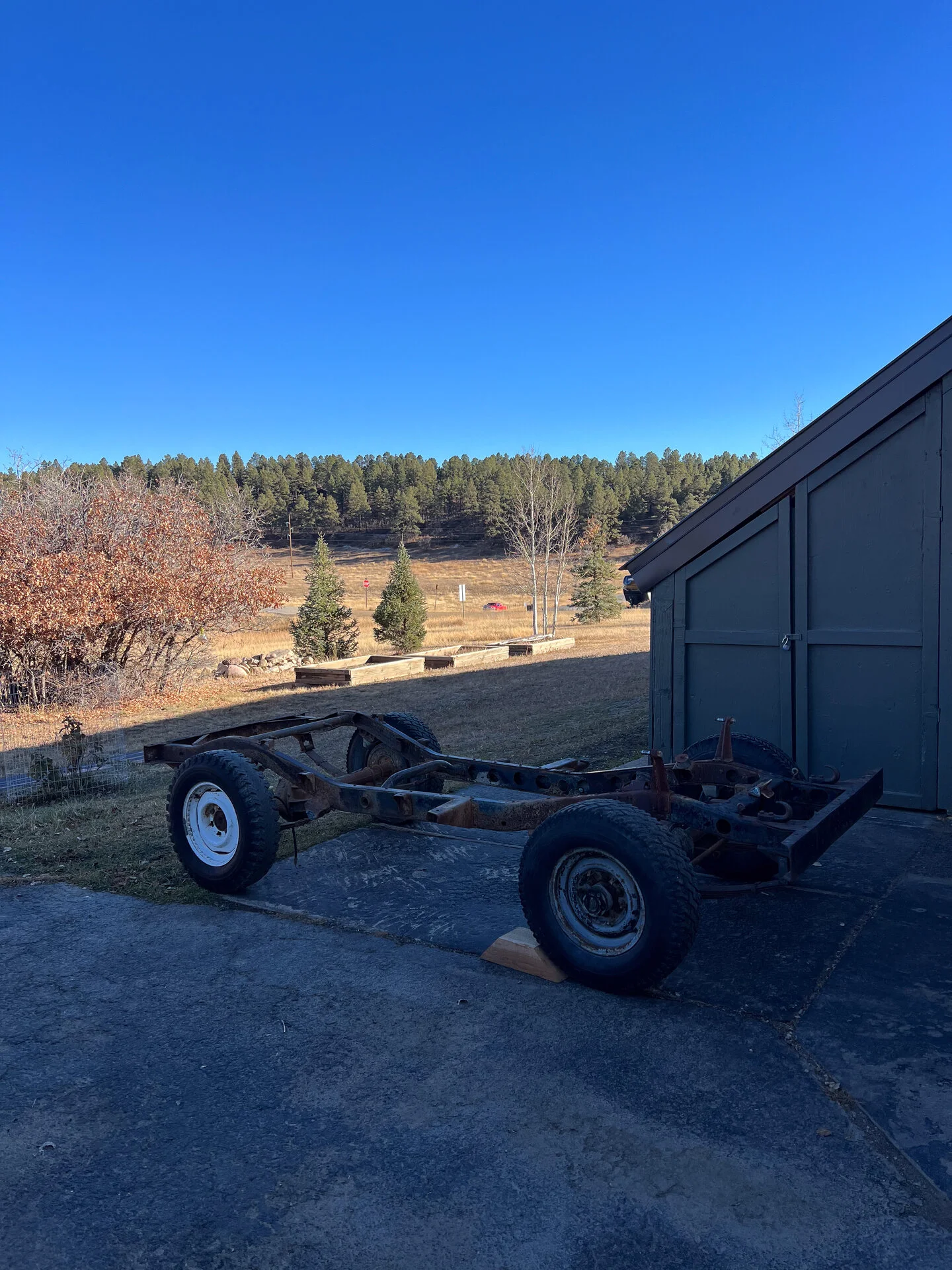

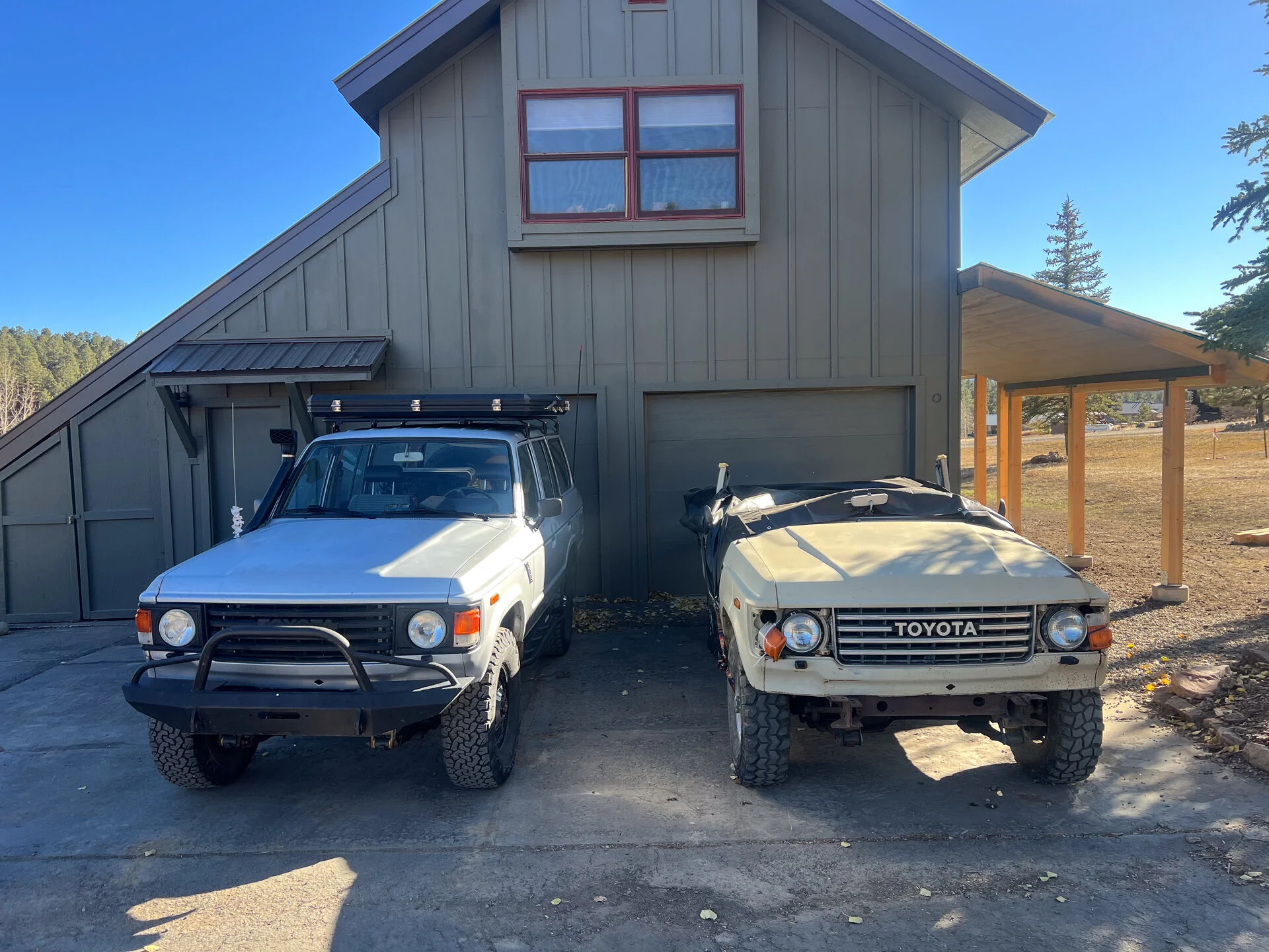

Tear down begins on the chop top!! Sad to take apart such a legend. But it will live on in my 40! One day I'm working on it outside. The next day I had to push it inside for the storm!
my 60 looking really cold and jealous outside of the garage. ;)

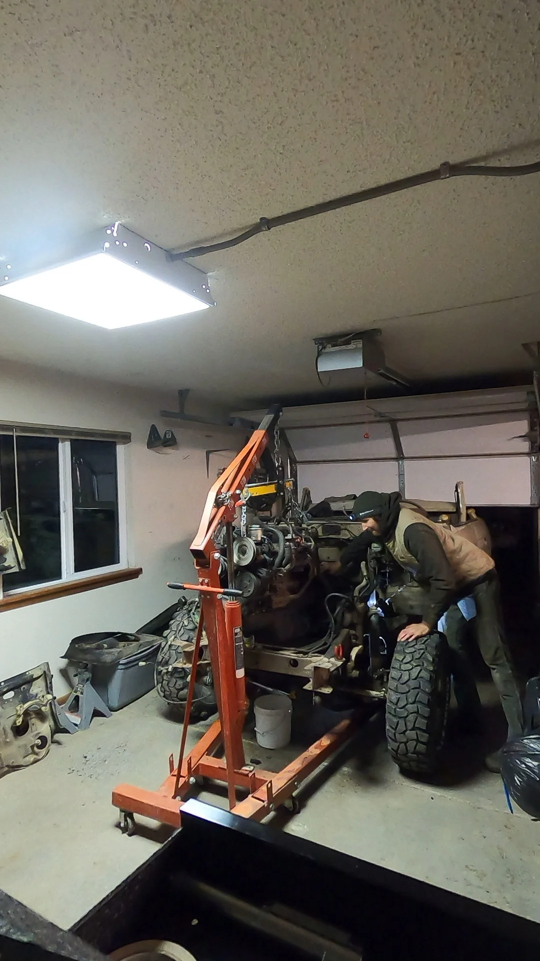

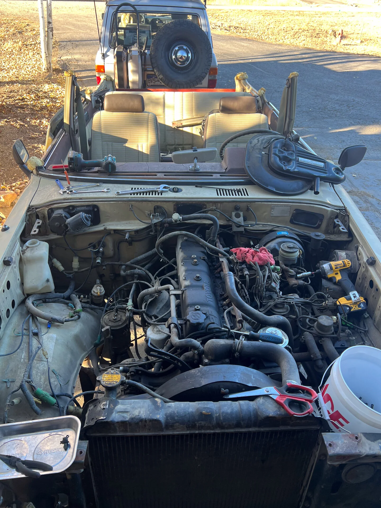

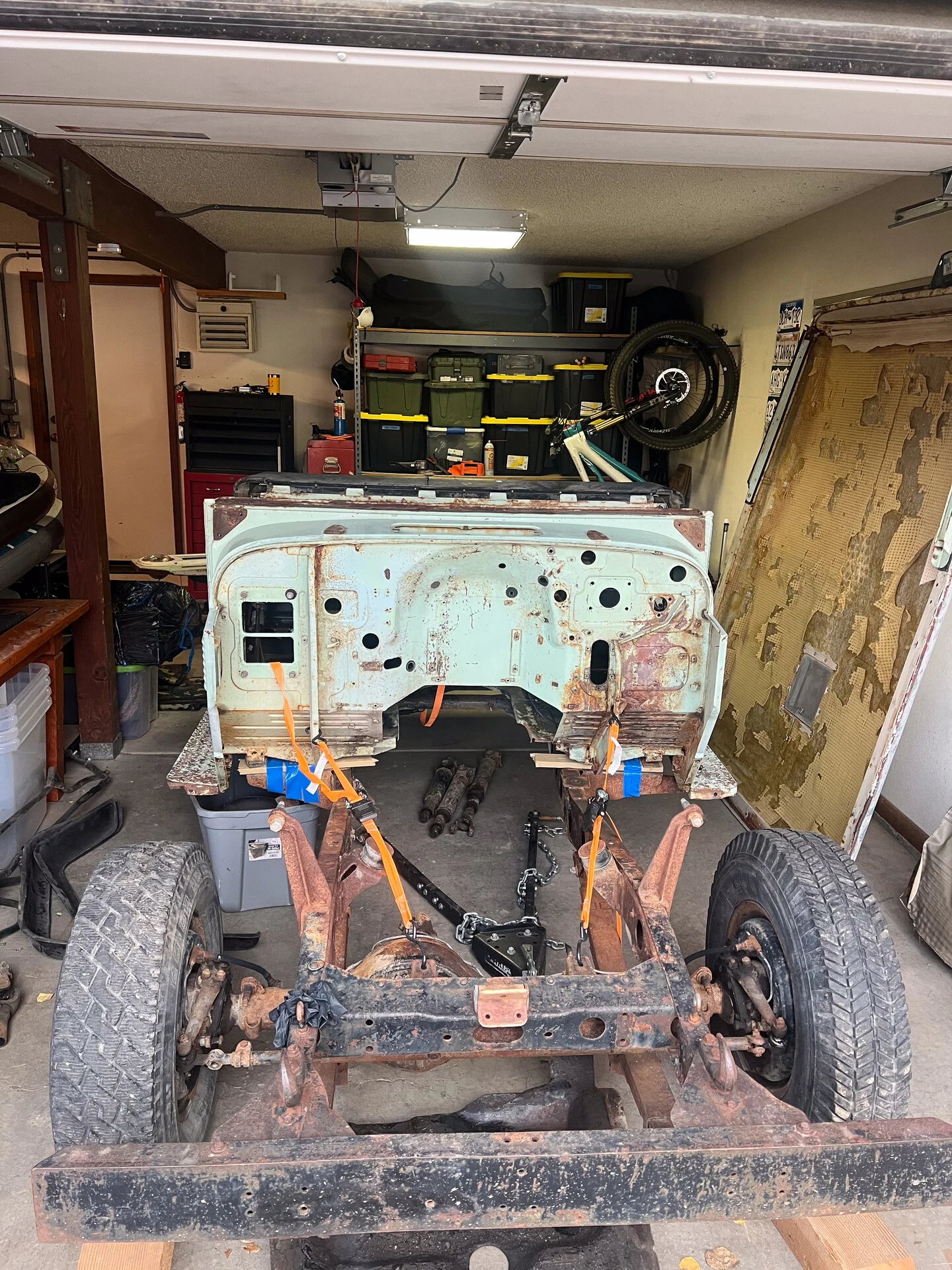

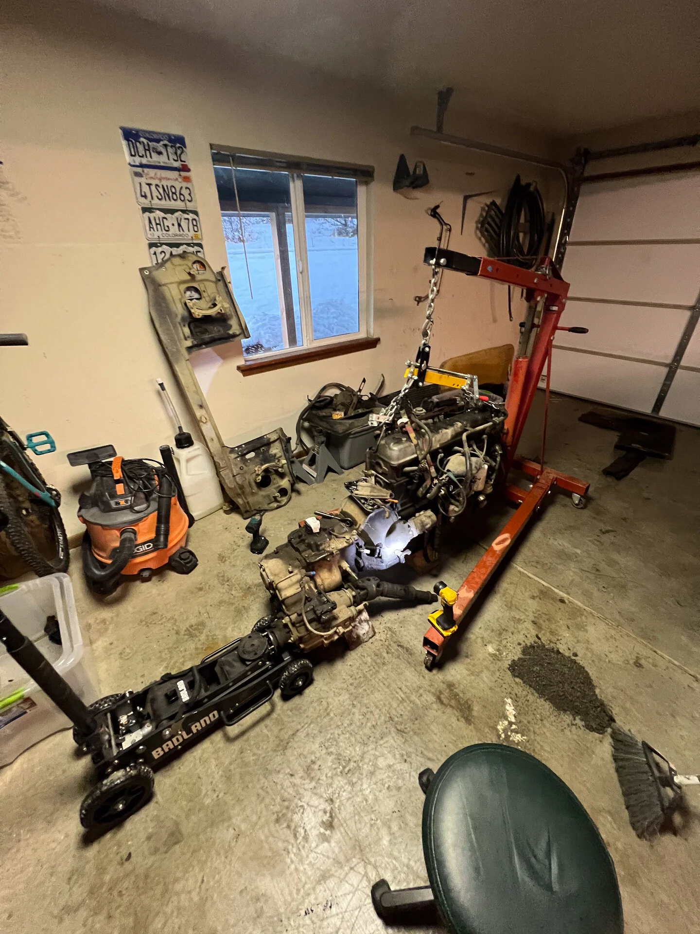

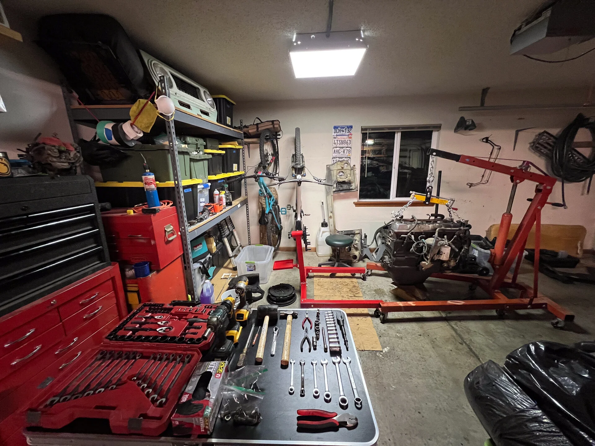

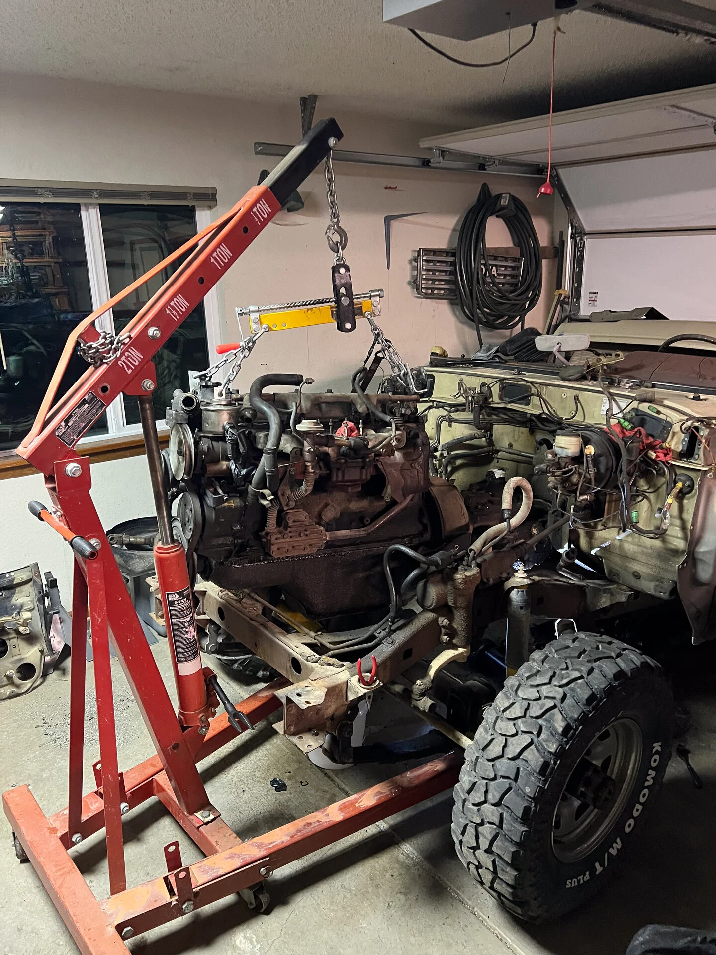

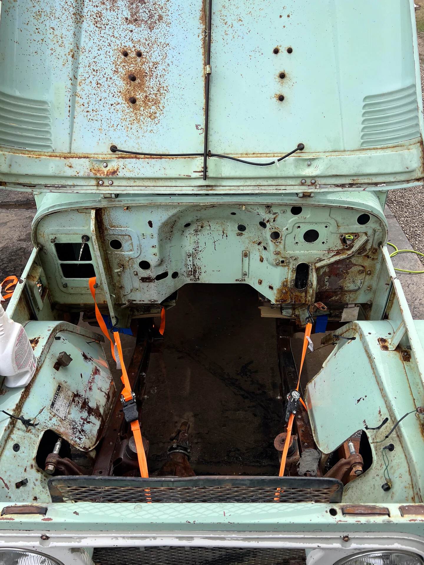

I pulled the front clip for a friend, which made for great access to everything. This is my 3rd time pulling a 2F... solo pull this time! This one was fighting me. But we got it out!! Prepped it for the engine stand. I need to go pick up bolts... M12x1.75x100+? Something like that. I'll pick up some washers too to help space it out.
Nightly Organize and knoll. That way I don't lose anything! It was a fun weekend!
