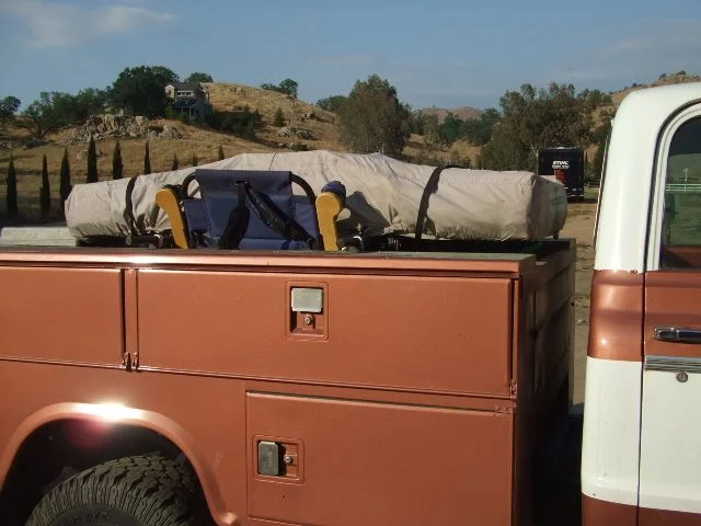

I'm fabbing brackets for the Roof Top Tent and mounting the tent now. This in preperation for Cruise Moab.

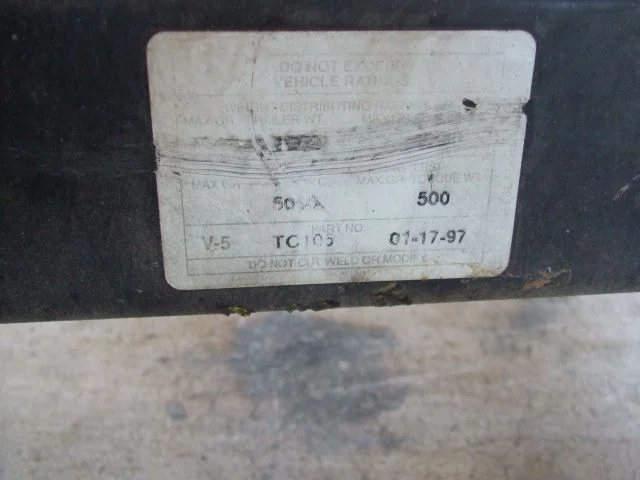

I just noticed the weight rating on the first hitch, 5000lbs with 500lbs tongue weight , uummm I always wondered what happend if you over did one of those... I've never seen one bend,
I wonder what your cruiser and trailer weight???
Looking at the new one it looks like its rated for 10k on the trailer...
They are both Class 5 "V".
The new one is suppose to be rated to 14,000lb towing and 1,500lbs tongue weight.
They tried to talk me into a solid reciever. I passed for now.
I am still amazed you bent the first one with your trailer and just a cruiser on it... is the 14k with a weight distributing hitch??? or just straight...
You only need a solid if you are over 6k if I remember correctly...and some solids are good up to 15k but you can only bumper tow 10k legally in Kalifornia..
I have a 12k on my Dodge and the one on the GMC with the hauler bed I built, If you want I can take some pix of what I did.. you may want to do something similar if the ground clearance is an issue.
BTW I run a solid ball mount but my trailer and bobcat weight about 10k.
I'm going to roll the tow rig and the FJ40.5 on the trailer across some scales in the next day or to to find out how much this setup weighs.
I'm guessing the entire assy is around 12,000lbs.
