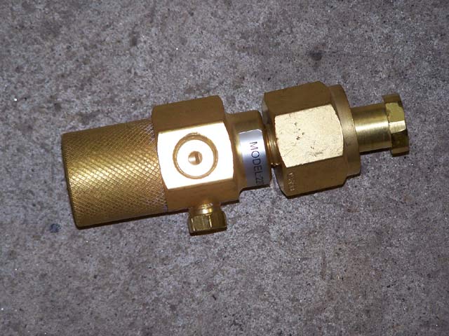

OK, so I ordered the tank from the beverage factory and it arrived at my shop earlier today (I'll check it out tomorrow)
I also ordered the regulator from EAD and the one they sent looks nothing like the one they have pictured on their website :confused:
It has a different part number stamped on it and came in packaging marked made in China :(
The one they have pictured looks to be made by Western Enterprises (made in USA)
I figure the one they sent will probably work as it should, but since I'll be airing up 35's, the last thing I want to worry about is a cheap regulator freezing up on me :bang:
I don't think that the country of origin has much to do with freezing. Power tanks regs will freeze if you fill 4x35s.
Something like this may be the best bet. I may get one so I'm not so worried about blowing out a hose. Also, I don't let anyone else use my tank as it is. It would be nice if my wife and daughters could fill their own f'n tires. :princess:
Poly Performance CO2 Fixed Regulator
The one pictured on EAD'S site is made by Western Enterprises (USA) and is the one I wanted, but it's not what they sent.
The WE regulator typically sells for about $80 bucks on Ebay, so when I saw it pictured on EAD'S site for only $40, I jumped on it.
The one they sent me appears to be the same one on polyperfomance's website (China)
