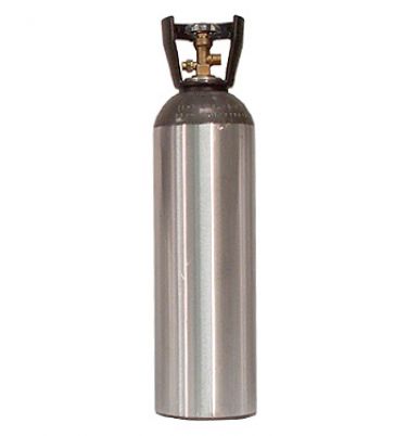

Tanks
10# tank shown (above)
These are brand new aluminum tanks with a CGA-320 valve (this is a standard tank and valve – the same as those used by the above industry suppliers). These are brand new aluminum CO2 tanks not reconditioned steel tanks. Every CO2 cylinder is produced from high strength aluminum alloy 6061-T6. These tanks are popular because they are not as heavy as steel tanks and they do not rust. A carrying handle is included on the 10, 15 and 20 lb. cylinders. The service pressure is up to 1800 PSI/124 BAR with a test pressure of 3000 PSI/207 BAR. These cylinders are stamped with required U.S. Department of Transportation and Transport Canada Markings. The 320 Valves are CGA approved, and have a male thread for Co2 Regulators. Note that this supplier is in California so CA residents will be charged tax.
Tanks from BeverageFactory.com call 1-800-710-9939 ask for Jesse Glancy
Be sure to tell him MagicMtnDan sent you and he’ll work to ensure you get the lowest possible cost.
10# tank is 7" diameter x 20.5" high 1800 psi – cost is $86.40

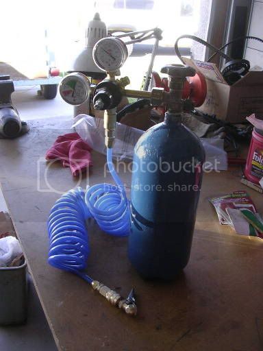

Regulators
After a lot of Googling, the best regulator solution I have found is from Outback Air. Their regulators are set at 150 psi and besides being an excellent value, they don't have the unnecessary gauges which will read the same up until the tank is empty. Static regulator complete with fitting and automatic quick connect coupler included. Outback Air regulator $55.00 http://www.outbackequipped.com/products.asp#combo
You can order online and the contact there is Tony. You can call him at 1-800-503-0244 and you can email him at info@outbackequipped.com Tell him MagicMtnDan sent you.
Hoses
There are many (many) hose options. I’ve done a lot of searching and contacted some people and here’s what I came up with:
A1 Coupling (www.A1Coupling.com) is in Oregon and they claim to provide or have provided hoses and hardware for both Powertank and Outback. I have been working with Dee Evans.
25’ Recoil Air Hose (PURC-14-25R-S-BR-QC) with quick coupler steel, 6-ball and plug steel industrial or automotive style. This is a spiral (coiled) reinforced hose with steel coupler plugs and brass tire chuck. 250 WPSI 4 TO 1 BURST. The hose has reusable fittings with bend restrictors both ends and the hose is reinforced. Available in a variety of colors including red, blue, yellow, and black. Hoses are made in the USA. It’s 1 to 3 days for shipping – most of the time they ship next day. The coupler plugs are steel and they are most of the time because the SS balls in the couplers will pit a brass plug and will be hard to get apart. If you happen to want a brass 6 ball coupler it will cost about $1.00 more. Dee Evans at A1 Coupling thinks most people would use the industrial style couplers. If they want a universal coupler in brass that will work with either one it’s about $2.00 more. The contact is Dee Evans and you can call him with questions and to place orders: 1-541-914-0606. Tell him MagicMtnDan sent you. The price per hose is $20.95 each.
