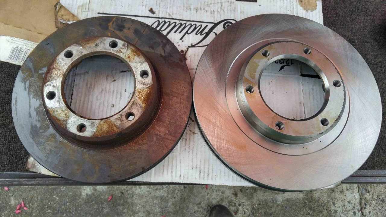

  1. I've never done brakes before (I'm due), seems straightforward enough and vids found here have me motivated.
  2. "Big Brake" upgrade on a '92 covered here. I've got 16" wheels so I'm assuming I can go a bit bigger (hoping to realize some increased stopping power).
  3. I've already got new 100 series pads, FYI.
What, SPECIFICALLY, else do I to purchase? I'd like to get everything I need in the next day or two.
  1. Since Duiser (jonesysoffroad.com) was kind enough to post the confidence-inspiring vids, seems like the right thing to do to order rotors from them. I'll have to contact them directly as the rotors for '93 - '97's only seem to come for all four corners per their website and I'm only doing fronts. If pursuing larger rotors via Duiser is the WRONG way to go, please let me know (I only ask because I don't know what I don't know.....).
  2. If there's a highly recommended alternative to the Performance 360 rotors from their site, please share.
  3. Re-manufactured calipers from NAPA sounds like the way to go. Headed there after work.
  4. Besides a few miscellaneous tools I realize I don't yet have, what else??? Is this it?
Last, there's mention of grinding dust shields to accommodate the larger calipers since I'm upsizing (seems like some have simply removed them entirely which I'm not up for). Easy to do or a no-brainer and just go get it done?
thx....

So current state... my brakes suck. Been lame since I bought it a couple years ago... Prob cheap pads just thrown on wore out rotors, by prev. owner...
I'm also running hydro boost... I did one of those diesel swap things and converted then.
I Really believe this should be a huge difference especially coming from poor condition smaller '92 pads and rotors... Right?
I was hoping to hear some first impression feedback on braking feel and power... :steer: From the upgrades u made
Thanks:beer:

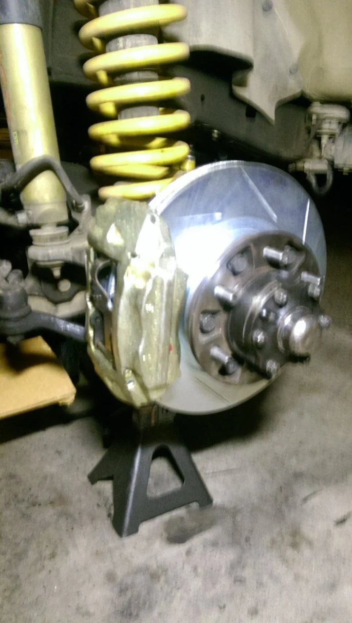

I should follow my own thread.....nice to see others doing this as well. I'm not running dust shields, hasn't been a problem although still on my mental "to do" list.
@jvazquez53 - mine were also REALLY mushy initially. I thought I had totally fudged the bleeding despite having felt I nailed it (first time doing that, took my time). Turned out I simply hadn't bedded in the new rotors yet. Do yourself a favor and LATE tonight (NO traffic), do some really HARD stops to help impregnate the rotors with pad material. Braking is a function of the pads contacting pad material buildup on the rotors, NOT pads directly contacting the rotors themselves. Until you get adequate pad material transferred to the rotors, the brakes won't function properly. That was the only thing I was missing, the mushy feel went away after that was done (hoping this is the same for you).
@Jvoight - completed mine quite a while back, nothing but positive things to say. Once the rotors were properly bedded, the braking was TREMENDOUSLY better. My rotors were REALLY bad so comparing before/after isn't really fair. That said, I have zero concerns being in traffic now. This reminds me, once the fronts were done I paid to have the rear drums worked on and adjusted. The fronts (my first time ever doing that work) were hard enough for me and didn't have the fortitude to go learn drums as well. Full disclosure from a somewhat lazy 1.5 banana mechanic.
