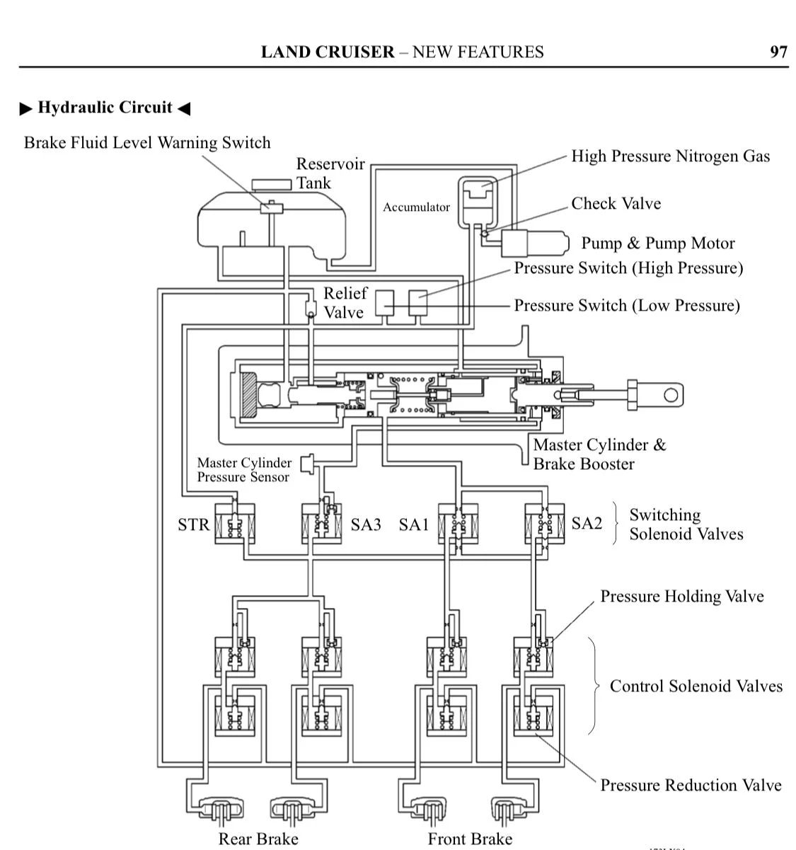

I see! So you had the issue of screeching noise before and after a new OEM booster motor/pump w/brake control wire assembly installed and rebuilding the old brake master, by replacing the master cylinder plunger. You replaced & rebuilt to correct screeching noise!I had the same issue. The reservoir would fill and then screech and bubble.
I consider the pump = pump and motor unit. You cannot purchase the pump or motor on its own, they are a unit. You can purchase the whole unit, the pump/motor and the master cylinder.
So to come up with this conclusion the HP SW stuck/sticking, did you run through the test procedures given in the FSM?
