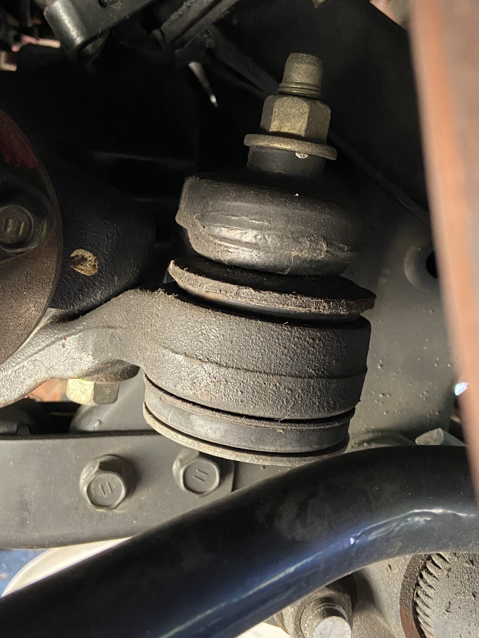

in addition to above
front diff bushings also
To rule out the front bushing, could I remove the front driveshaft and see if the noise goes away? Or would that damage the FT4WD system?
I believe this is the more failure prone one, yes? Alongside the rearward end of the front differential shaft, offset to the passenger side?
