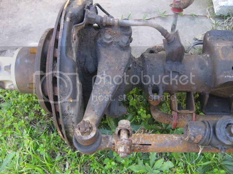

How needed is the backing plate. Is it's purpose only to protect one side of the rotor??
No reason at all -- Plenty of people have done it. I believe in the tech or trivia section is the part #'s (from Napa) for the proper length hoses to bypass the union.
I believe this is from MUD Member Kavik's rig -- if you do a search, there's a thread where he shows what hardware he used.
Btw, if you leave off the backing plate, you'll need a spacer, to get the preload on the bearing correct.
