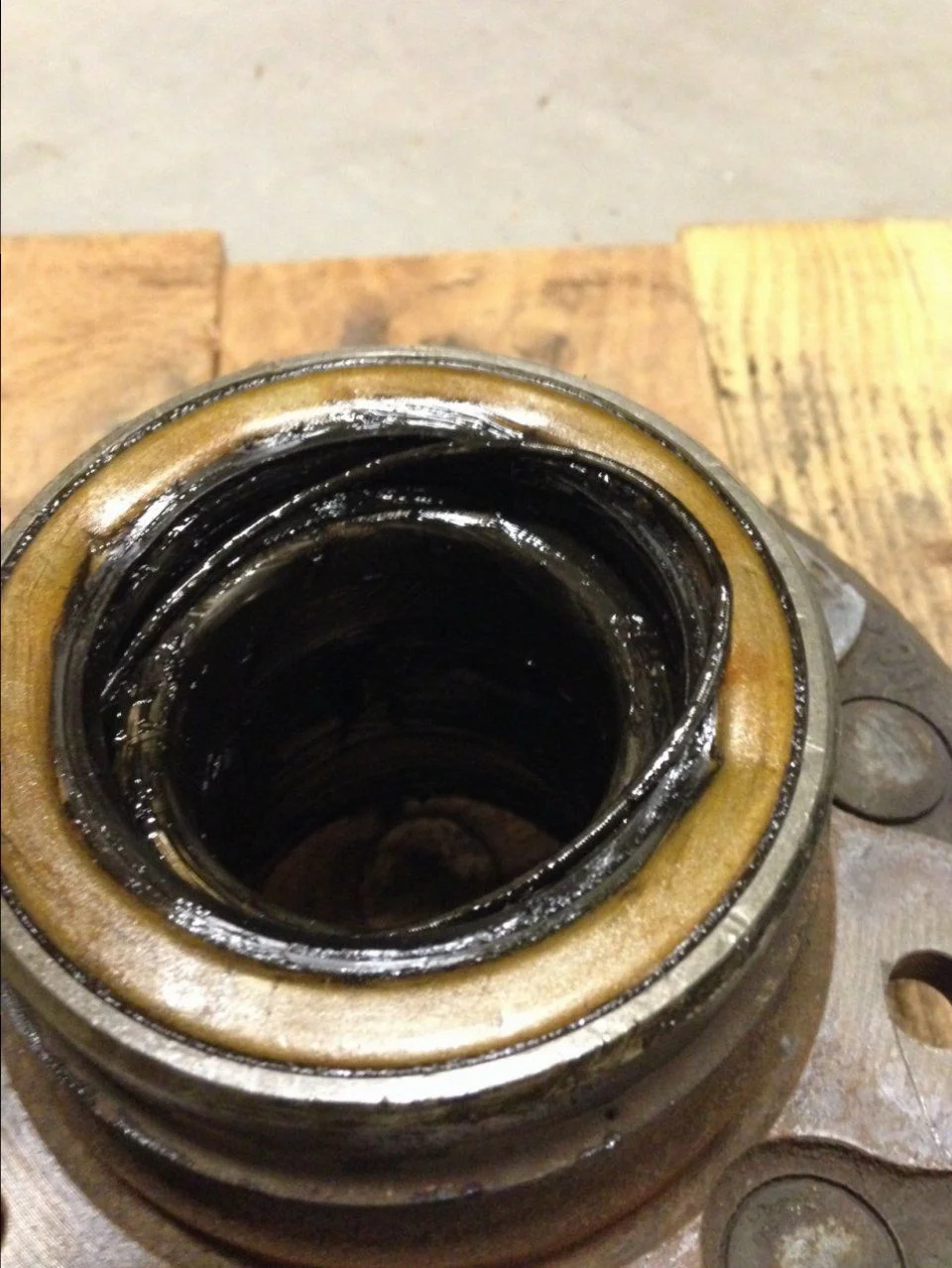

I couldn't get the rear seal off (to get to the rear wheel bearing). In trying to pry it out (similar to what's in that video), a metallic o-ring slipped out and I can't seem to comfortably get it back in place totally.
So I haven't removed the rear wheel bearing/seal but have a mystery o-ring that i'm trying to get back in place. Since I'm replacing rotors, do I even need to take the rear wheel bearing out? Can't I just re-grease as it still sits inside the hub?
Did I damage the seal? WTF is that mystery o-ring that doesn't show up on the exploded diagram in my FSM? Pic below shows what I'm talking about - the dimpled areas of the outer seal are pinching down and not allowing me to get that ring back in.
pic attached
Looks like the seal came apart. AutoZone usually stocks them.
Which officially stops tonight's progress....thx for looking.
Harbor Freight seal puller is a good cheap investment. I think I paid $2 on sale.
