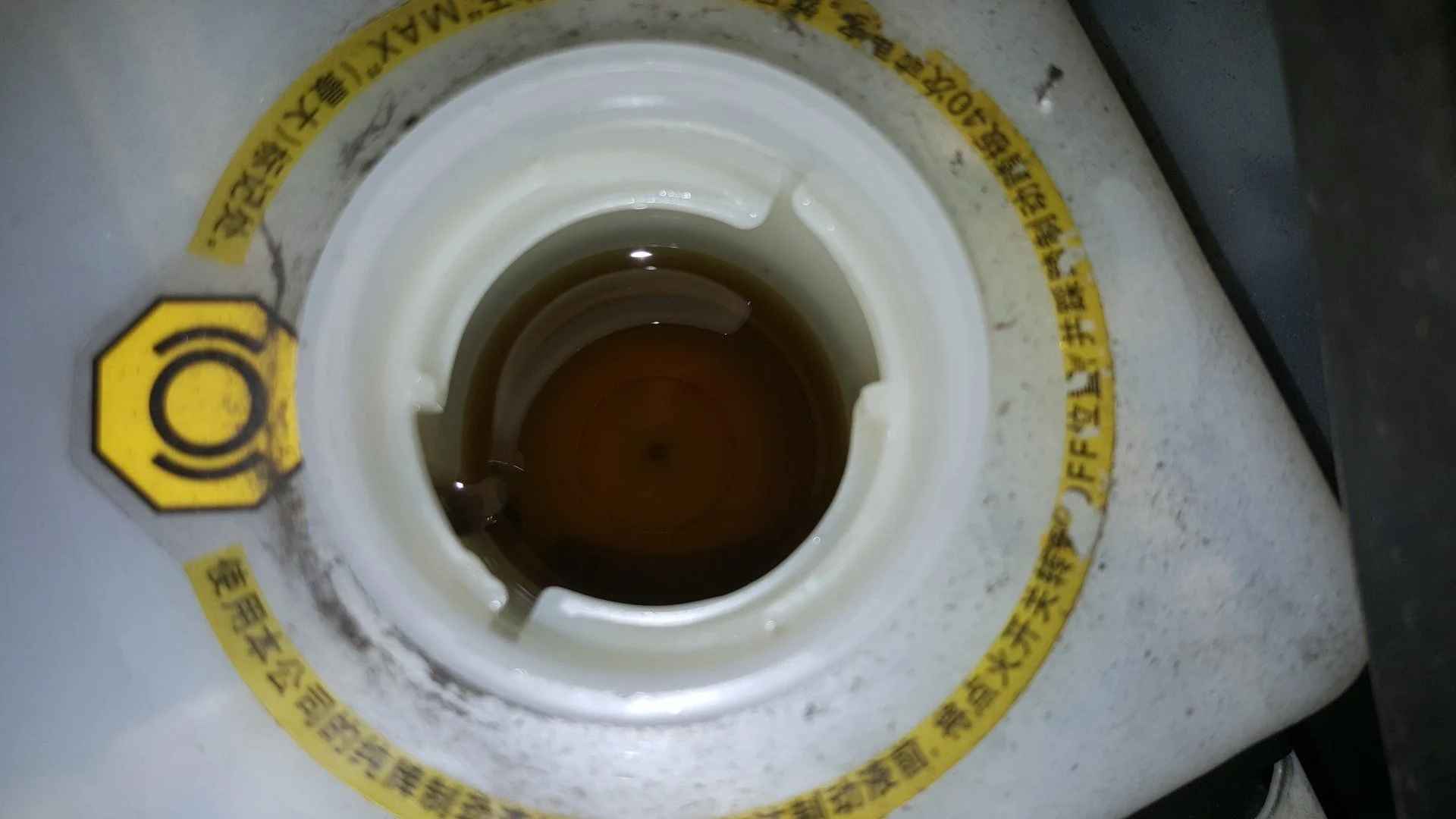

I took pics today of the brake fluid container after coming back from a weekend trip.
How does the brake fluid look? Would you recommend a flush? And what kind of costs am I looking at, $100 give or take?
That's pretty gross, it should have been flushed three times in that time period, and yours looks as if it is the original fill. I would flush it sooner than later. I have no idea of cost, but it is easy to do. I use a pressure pot with a Toyota master cylinder adapter cap.

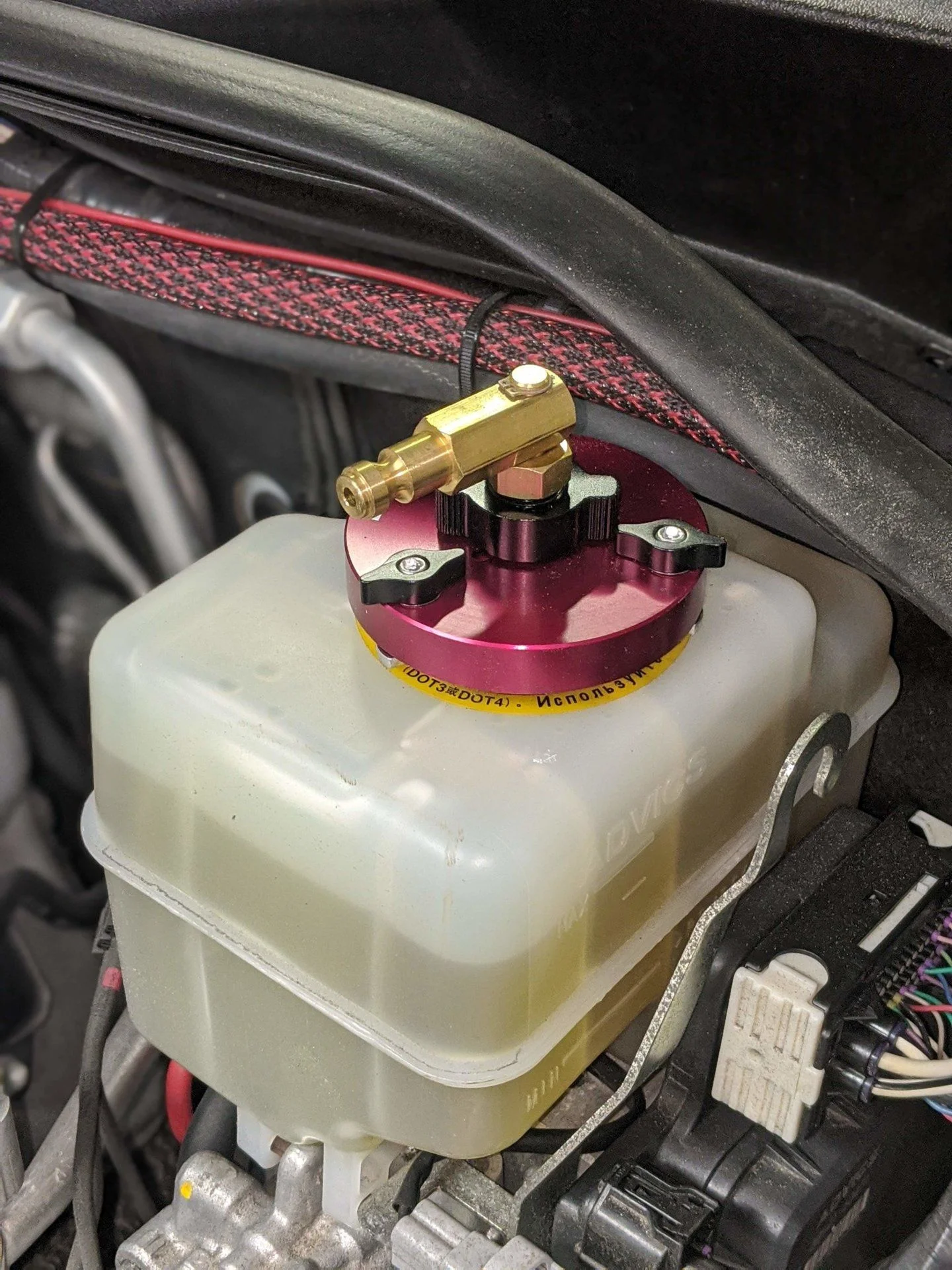

Get yourself one of these. Shouldn't take more than an hour to do it. Hardest part will be to jack up the wheel and remove each one.
https://www.amazon.com/Motive-Produ...05659192&sr=8-2&keywords=motive+brake+bleeder
That is a good bleeder, I use one, but there is no need to jack up our remove wheels, as long as you are OK with lying on the ground under your truck, on a big piece of cardboard.
The MF bleeder requires a Toyota adapter for the master cylinder. You can use the supplied universal one but it clamps down using chains and j hooks and is a pure PITA to use.

The Motive Products applications guide lists the 0101 bleeder for Toyota, but I did not see it on Amazon. Am I understanding you correctly that you use the model 0100 linked? Or is there another one you recommend?

I have let a shop do the brake system flush in the past, but I would like to do it myself this time. Pretty easy to do? Just pressurize the MC and open the bleed valve at the calipers one at a time until the fluid runs clear? Is order important (I imagine not since they should be independent circuits)?

This is the one I have: Power Probe I bought it several years ago, but I have to admit I haven't actually used it yet. I assure you I didn't pay $80 for it, the price must have jumped up for some reason. I originally bought it for my '11 that had a lot of miles, but then traded for a '15 with much fewer miles, the fluid still looks good but I will probably do a flush this spring. I have a home-built pressure bleeder, I need to find the adapter for that quick-connect fitting. Here it is installed:
