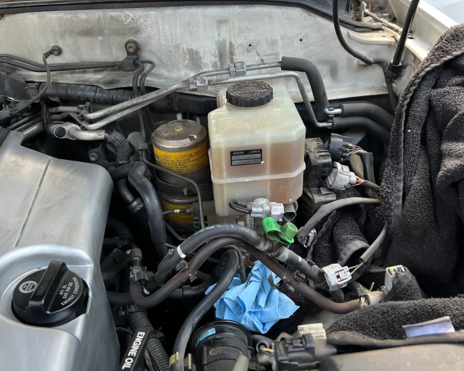

I try to follow the step shown on this video (). It is great video. But I found that it is not necessary to take part the whole bottom panel. Just take out the ABS control module will give enough space to work on the 4 nuts. top left, bottom left and top right nuts are easy after ABS module is removed. Bottom right nuts is a little bit challenging. Needs a swivel adapter and extension, but still not too hard.
Over all it is pretty easy job.

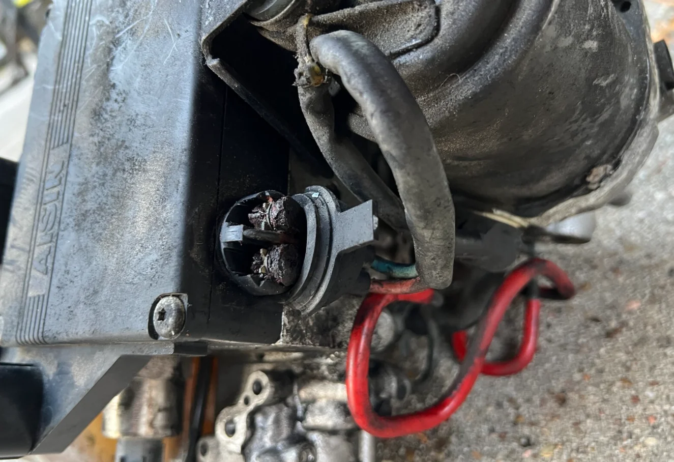

Heavily corroded.

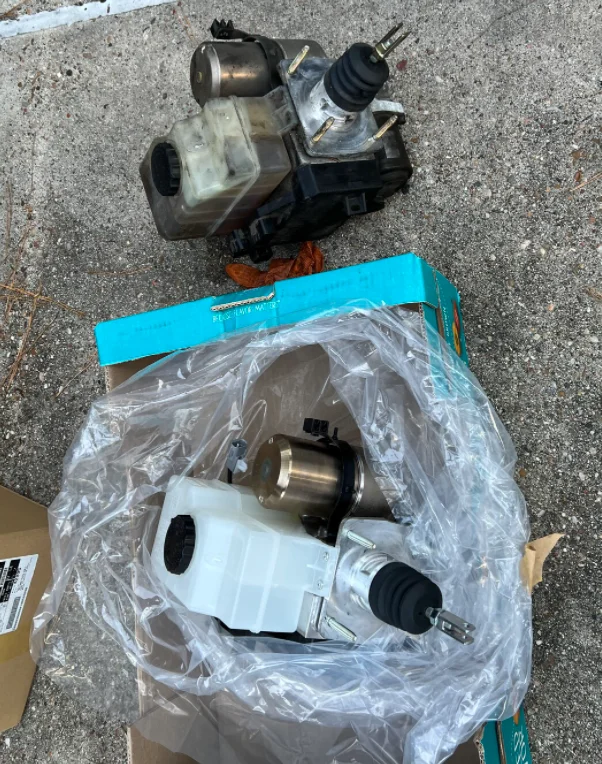

Old and new
Is there anyone buying old brake booster assembly? Old one is not always make that noise. May be restorable.
Will ship in factory package box.

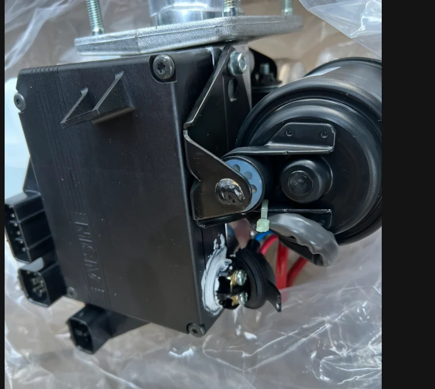

Add little bit silicon to prevent any water penetration. Not sure if silicon will work here.
Dielectric grease

It is important to check the cold start electric pump run time (30 sec or less) and the frequency of it turning on afterwards. If it runs longer than say 35 sec and frequent afterwards , REPLACE the ACCUMULAOR ASAP before the ABS motor get killed by running more often than necessary.
98-2000 models havea ovel shape wire plug for the pressure sensor and others have a trangular shape wire plug (See last picture on 1st post). The presurre switch is located right above the green cap in Evap hose.

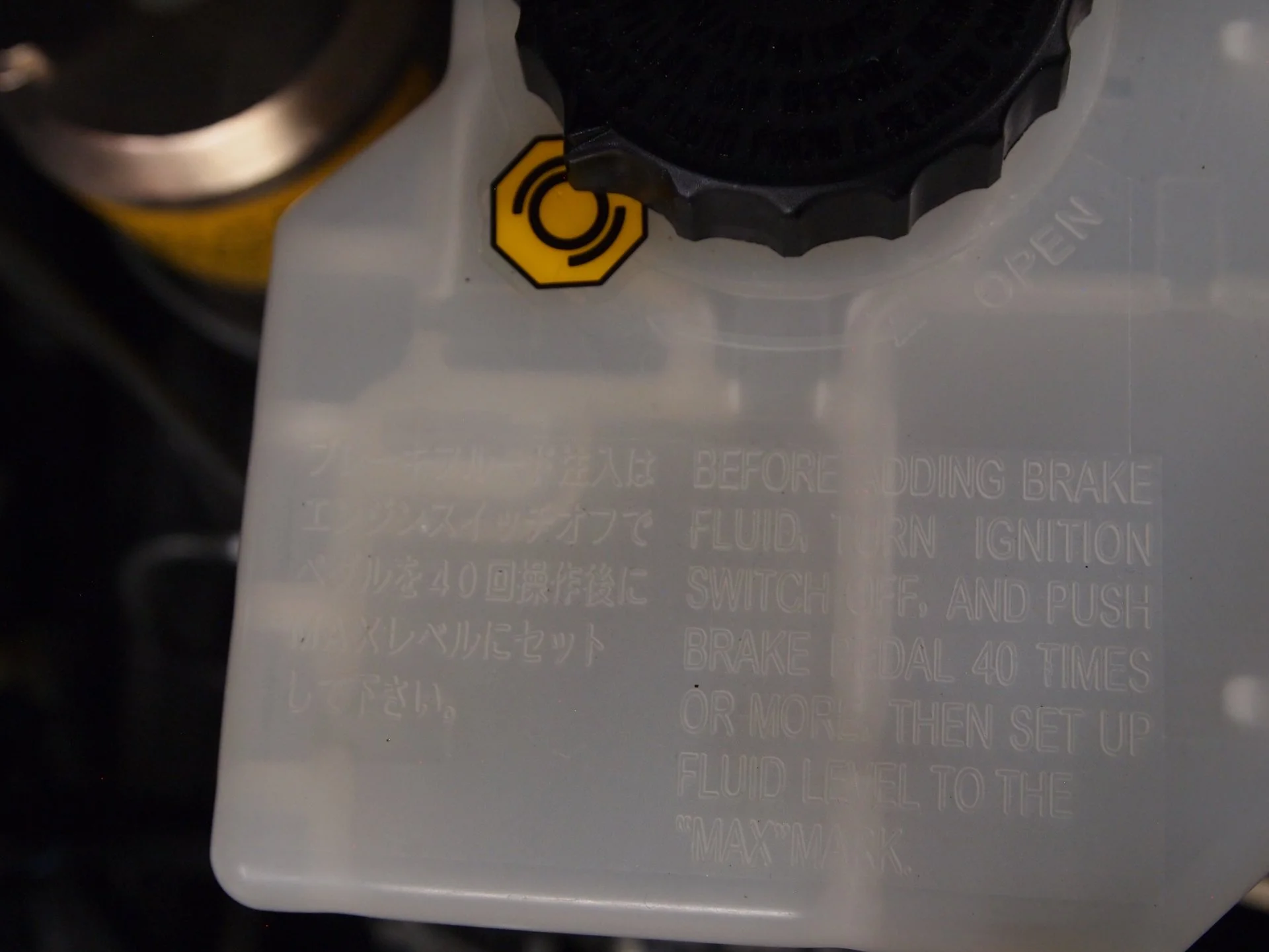

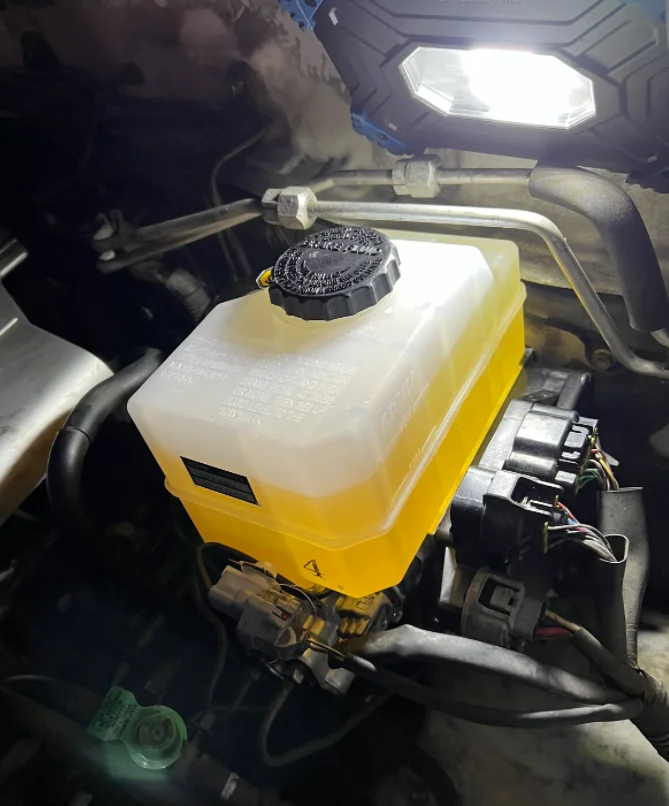

In your second picture, I see an overfilled reservoir.
I like "Timmy the toolman's" videos. I'm sure after doing more of these, he'll streamline as you have.
But seems most everyone, keeps missing one small detail. How to properly top reservoir.
Toyota was concerned enough this be done correctly, it's embossed on the brake reservoir.
I followed "Timmy the toolman's" videos. Before taking apart the assembly, he asked customer to pump the brake for 40 time to release the pressure in the container. I pumped >30 times until the brake down to floor. In this case, all the brake fluid in the high pressure container came back to the reservoir, thus it looks overfilled.
What I didn't follow is the part he take off the whole sub panel to gain access to the left top bolt. It certainly make it easy to do that if every thing is out of the way. I just don't want to take off so many things apart. I am 100% sure, I will break some clips along the process. But you have to put your body into some wired position to gain access to all the bolts. It is indeed challenging sometime. Not as challenging as changing the CV Axle:)
Hope I didn't screw up anything, I followed his video very carefully.
It doesn’t just look overfilled, that means it IS overfilled. You do not add fluid until after pumping pedal 30+ times and it drops to the floor.
