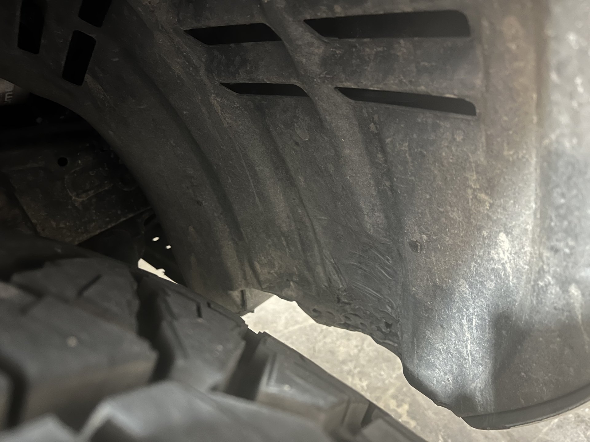

Hello
I picked up a 16 a few months ago.
I currently have and OEM spacer method 18 MR312 18mm offset
275/70 18 BFG’s 32.2x10.9
Can’t leave good enough alone.
Only 1 month on this setup.
Just ordered the ome BP51 setup

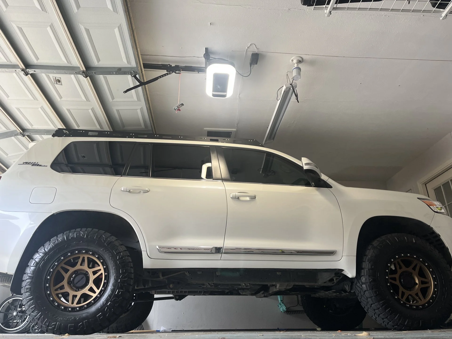

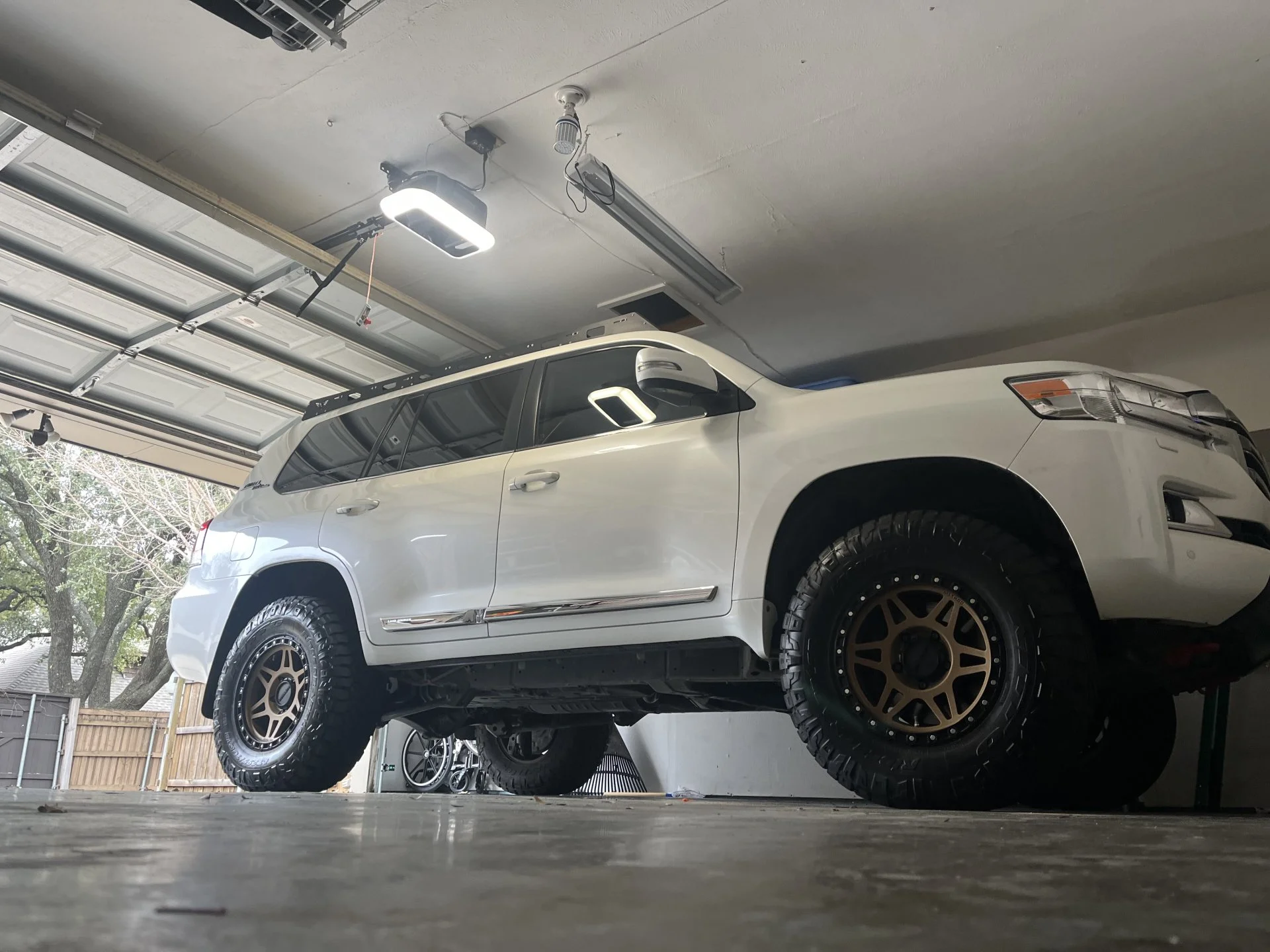

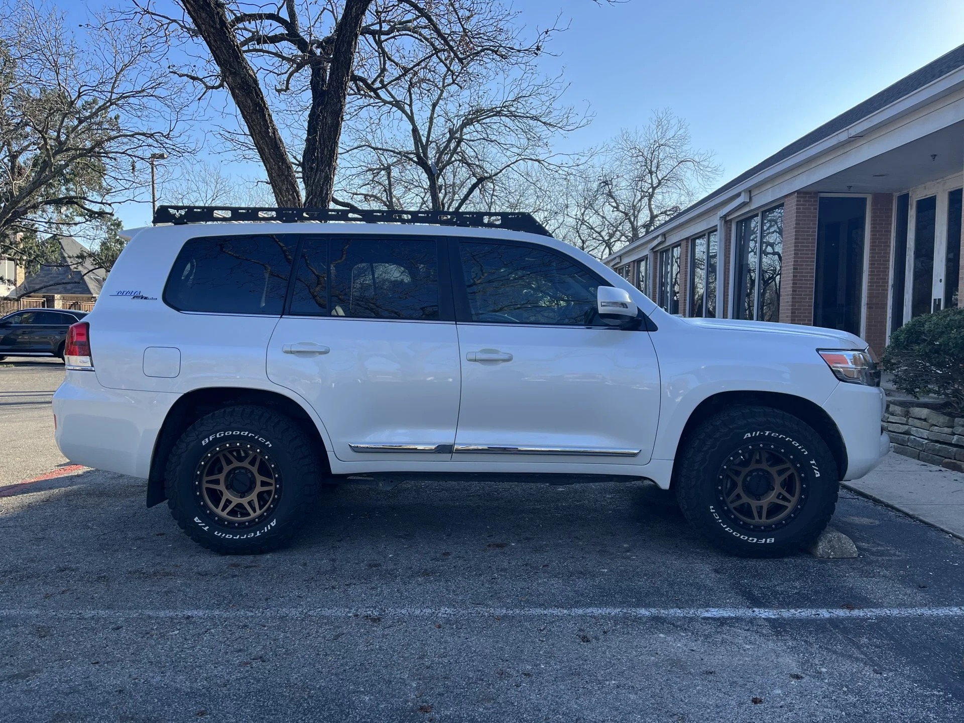

Any chance a 295/70 18 BFG about 34.3x11.6 will fit WITH OUT kdss relocation?
Some trimming/heat gun will be ok
Thanks for the input
Pic is in current form.
Yes. You can do it at that size. Make sure you add upper control arms, such as SPC that will allow additional positioning option in the wheel well. 1.25 spidertrax spacers are an option to widen stance as well…but definitely need UPA.

OK. Others can chime in on specifics of that UCA, which is fairly new here. The unique aspect of the SPCUCA is its ability to rotate, which allows placement of the tire forward or rear word…. which can go along way toward avoiding contact.
Remove mudflaps both in front of the front tires and behind. Also have a heat gun handy in case you need to reshape fender skirting.

The BP51 lift does not allow you to run wider tires. It allows taller tires. The SPACER mentioned above or offset allows the wider tires. This is to clear the KDSS near the front left tire.
There is a thread called 34 vs 35 tires which is a very good read.
I have the 16 with BP51 and am running 33.98" x 11.5" nitto tires 285 x 70 x 18. They barely clear the KDSS and allow me to keep the mud flaps and OEM KDSS location.
Different manufactures have difference "actual" tire sizes for the same stated size. Be sure to look at the tire spec sizes.

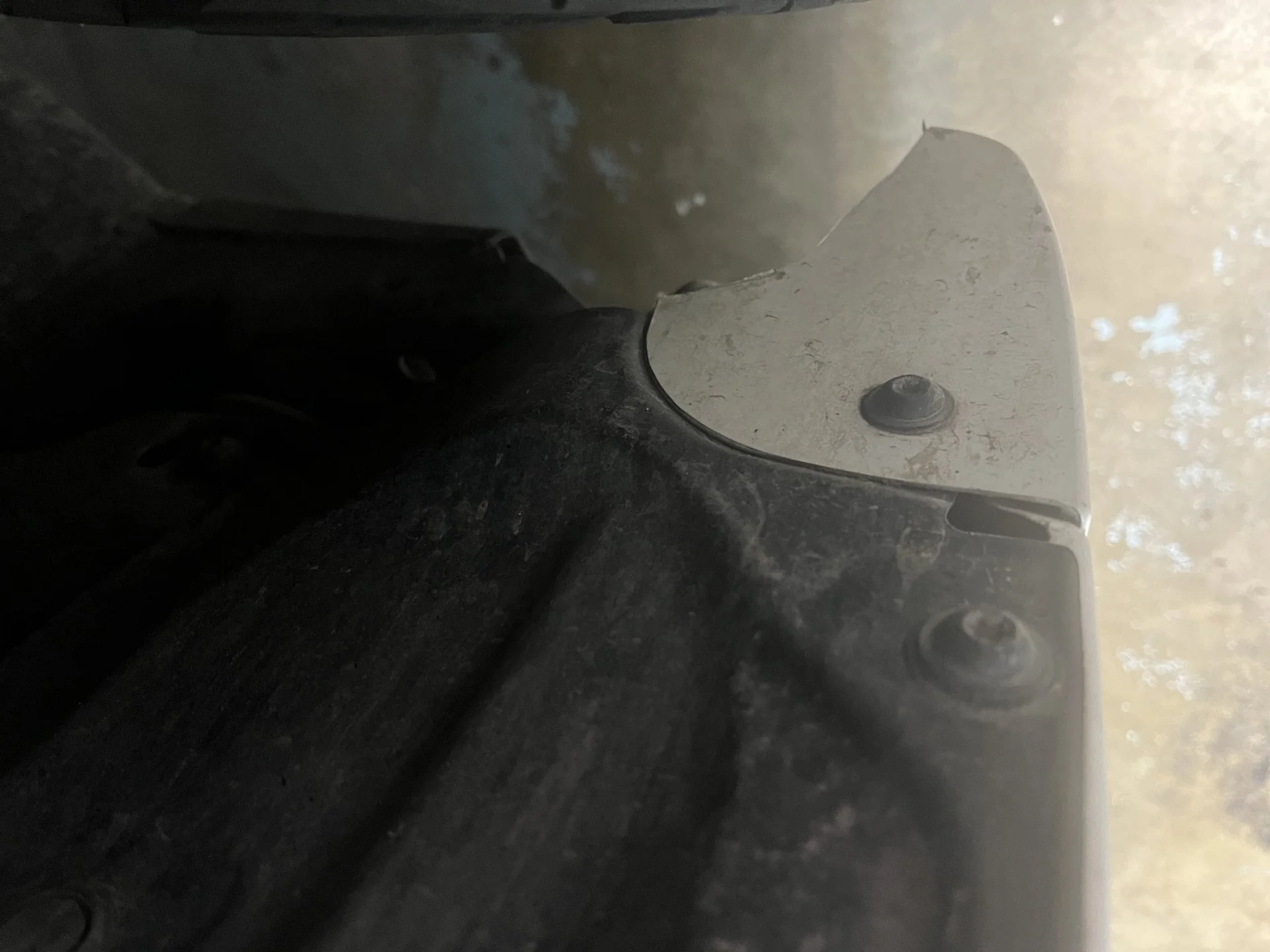

Minor trimming and a heat gun to the inner front fenders
Don’t have pic but tires tuck with wheel well at full flex
About 2.5 “ in front
